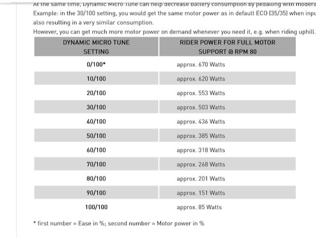

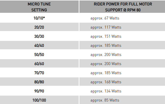

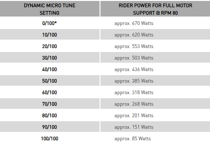

According to Specialized, you need 117 W to saturate the SL 1.2 motor at 20/20%. (The Ease 20% means the Assist of 0.54x). If you input 117 W of leg power or more, the motor would provide a steady assistance of 64 W. Whatever extra you can input is just you.
Again, Specialized says you need as much as 553 W to saturate the SL 1.2 motor at 20/100%, that is, you need to input that much power to produce 320 W mechanical from the motor. Whatever leg power you input up to 553 W will result in a motor response, so yes, you will ride faster and faster.

  • According to this table, Pr = P1 = 117 W not 139 W at 20/20%
  • Is the Boost Factor = 3.2 based on these tables?

Those tables are NOT consistent with my simple, steady-state model of the Specialized power-sensing assist. Will have to delve into that.
Based my model and the boost B = 2.3 for the 1.2 SL motor on official Specialized documention put out prior to the SL 2, when the Creo 2 was the only bike using that motor. I linked the official motor summary showing B = 2.3 for you previously. Will see if I can find the link again.
That documentation gave a max mechanical power Px = 320W and boost B = 2.3. It also talked of linear relationships between E and B and Pm (motor power) below saturation and between M and Px and Pm above saturation.
That linearity implied a saturation rider power Prs of
Prs = (Px / B) (M / E) = P1 ( M / E),
where Px, B, and P1 = Px / B are all motor constants supposedly independent of E and M.
So, when E = M, both M and E cancel out of Prs, leaving Prs = P1, a constant. Based on Px = 320W, and B = 2.3, P1 = 139W.
But your upper MicroTune table — which wasn't available then — shows that Prs is clearly NOT constant when E = M. So there must be previously unmentioned nonlinearities in the system. Not entirely surprising in retrospect but not anticipated from earlier documents.

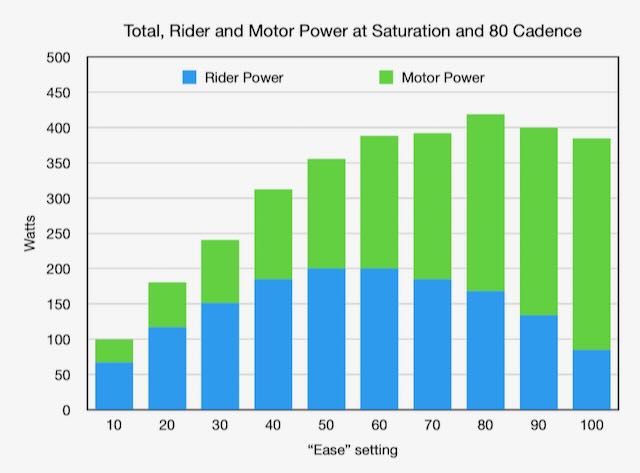

Below is a graph comparing the official SL 2 tables of Prs values for regular and dynamic MicroTune modes to the predictions of my simple linear model. E is on the horizontal axis, and Prs on the vertical.
Revised the linear model to use the official max power of Px = 300W for the 80 rpm cadence used in the official tables. But stuck with boost B = 2.3 here, as the B = 3.2 suggested by @Stefan Mikes made the linear predictions even worse.
For the regular MicroTune case with E = M, the linear model predicts a flat Prs = P1 = 130W independent of E (yellow line). But the official table indicates a convex upward curve (blue) with significant variation in Prs as a function of E.
For the dynamic MicroTune case with variable E but fixed M = 100, the linear model predicts a hyperbolic Prs curve (green line). But the official table indicates a nearly linear decline in Prs with E (blue).
Having no reason to doubt the official SL 2 data, gotta conclude that the linear relationships between E, M, and motor power described in earlier Specialized documents aren't really linear in the SL 2.
Will look into this further. In the meantime, disregard my posts 19 and 22 above.

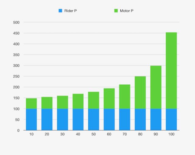

Final chart, I promise. This shows total power for each dynamic (power not capped) micro tune setting with the rider providing 100 watts in every case. This is probably a more meaningful analysis. I for one could manage a steady 100 watts but not for a very long time. When I get my new bike and the weather cooperates I'll find a level place to try to gather some real world data

Quite small differences in the lower settings but big increases at steps 7-10. It would be interesting to put a bike on a stationary trainer that would output total watts at the rear wheel and get some actual data.
Need to digest this graph. How did you get motor power?
Yes, we really need some solid data to understand how our power-sensing PAS really works. Those MicroTune tables from Specialized are a start.
The dynamic micro-tune table gives rider power to get full motor power. We know max motor power at 80 cadence = 300 watts. 300/rider power to get max motor power= motor watts per rider watt. e.g. 30/100 required 503 rider watts so 300/503 =0.596. If rider is producing 100 watts motor will give 59.6 watts with 30/100 setting. I really don't know if each "ease" setting is setting the slope of the rider power/ motor power curve or if it is linear at all.
At 100/100 motor watts = rider watts * 3.53 up to a max of 300 watts.
OK, I see what you're doing here. Clever use of the dynamic MicroTune table!
For each E, you can extract the slope S(E) of the chord of the Pm vs. Pr curve between (0,0) and the saturation point (Prs,Px), where Px = 300W for the SL 2 at 80 rpm. These slopes increase nonlinearly with E.
Even if the curve's not truly linear before saturation, this is still a more empirical way to calculate Pm from Pr than what I've been doing. You've given me an idea...

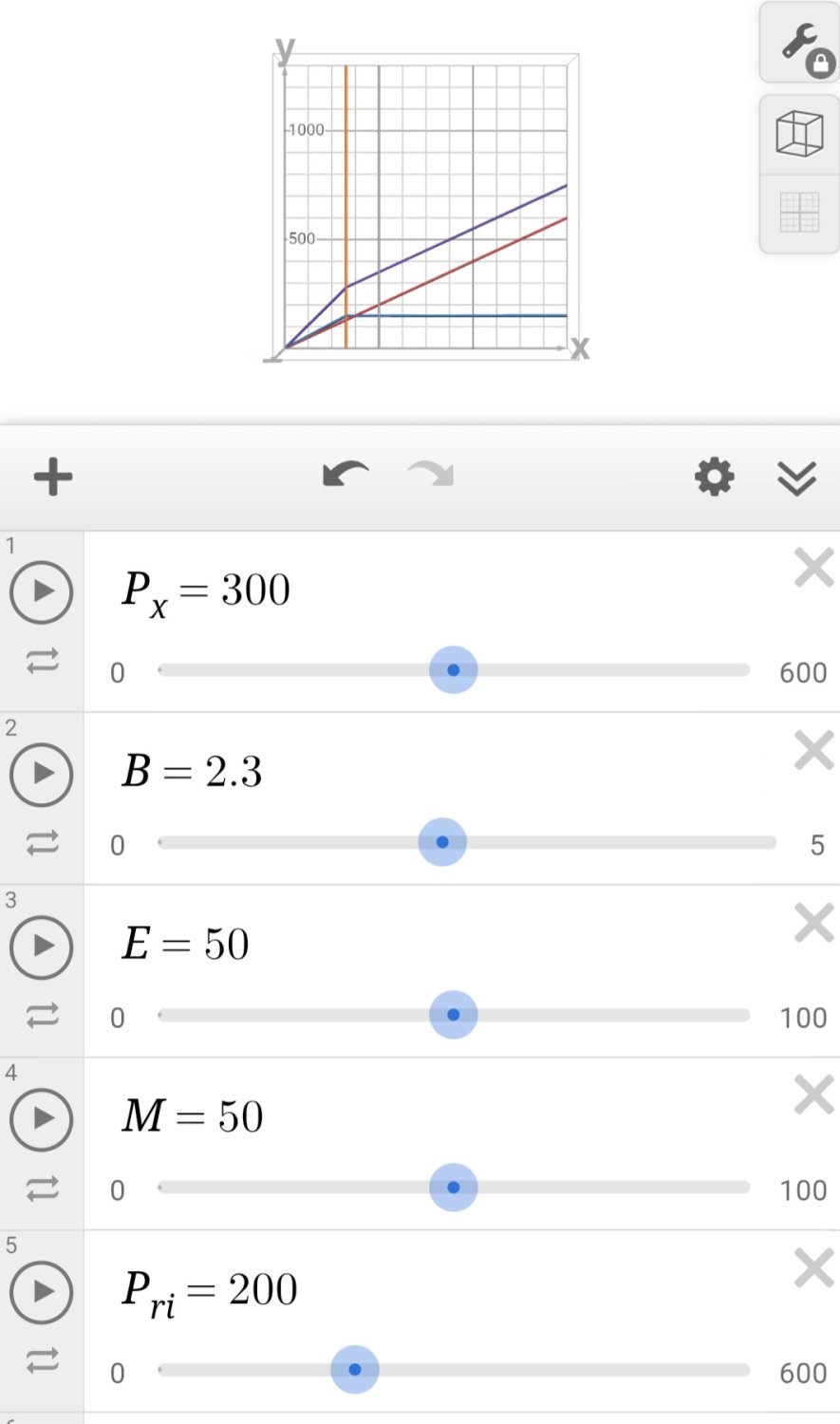

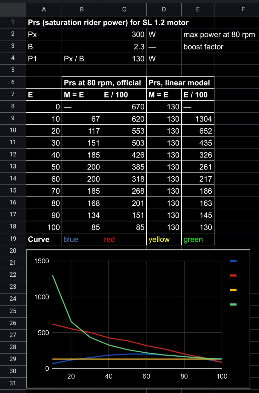

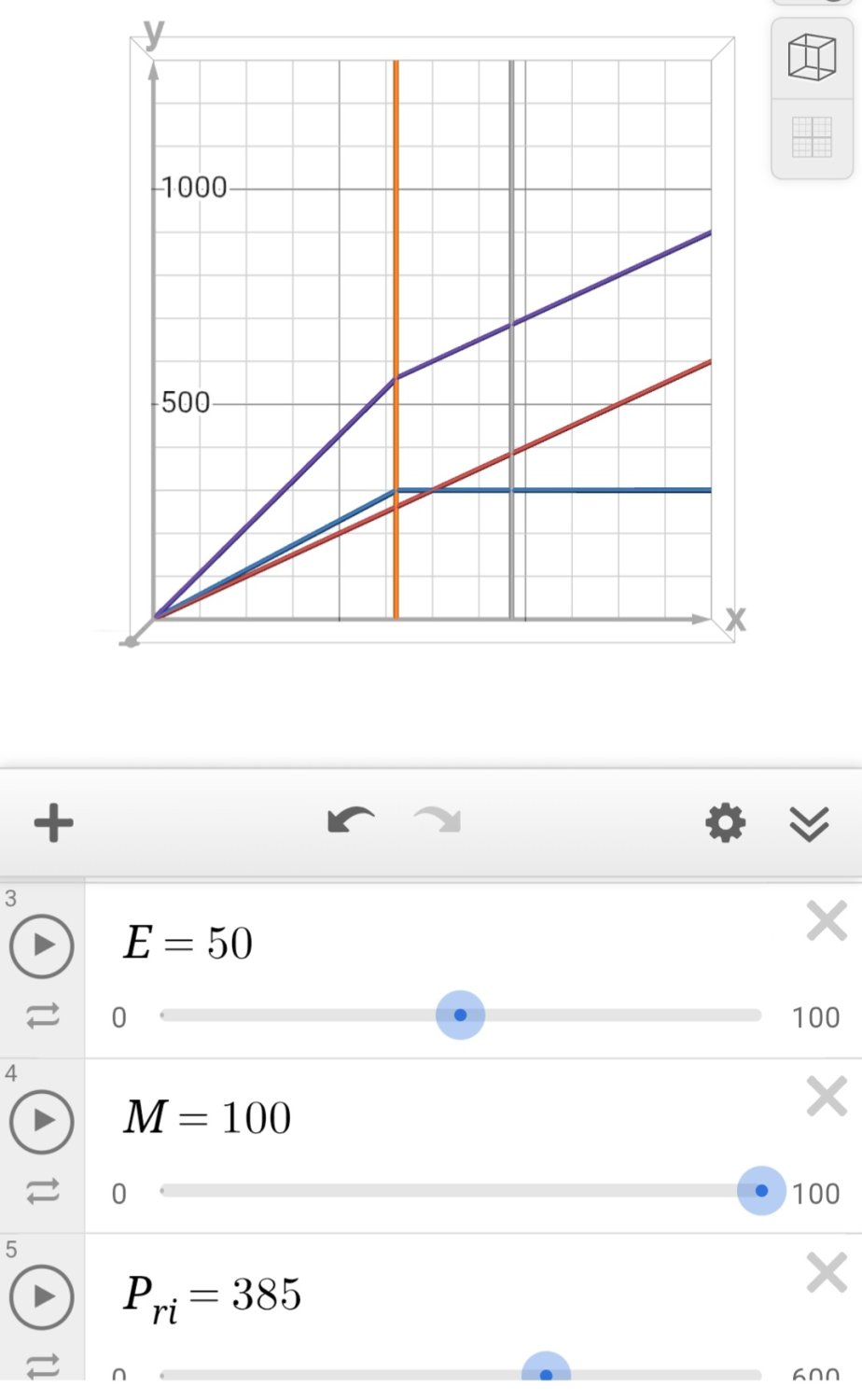

Went back to my linear model based on official pre-SL documentation. Here are 3 screen shots of the interactive graphical version at
Here's the setup. Px = 300W is the SL's max mechanical motor power at 80 rpm cadence. B = 2.3 is the boost factor originally published for the SL 2's motor.
We're writing a Spec assist mode like my ECO (35/45) as E/M. As a motor property, B should be a constant, independent of both E and M.
This model's "linear" in that motor power Pm is directly proportional to E, B, and rider power Pr below saturation and proportional to both Px and M but independent of Pr above saturation. As indicated in pre-SL 2 documentation.

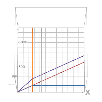

Here's a closer look at the model graph for E = M = 50. Pr plots on the horizontal axis and various kinds of power at the crank plot on the vertical axis.
Let's focus on the blue Pm plot and its pre-saturation ramp and post-saturation flat. Any realistic model of Specialized's power-sensing mid-drive PAS must capture the following features:
o Since Specialized mid-drives have no throttles, the Pm ramp must start at (0,0). Check.
o Since post-saturation Pm is fixed at the cap imposed my M, the post-saturation Pm plot must be a horizontal straight line. Check.
o Since I never feel a thing when I pedal my SL 1 through Prs, the ramp and flat must meet at Prs. No jumps. Check.
o The orange vertical automatically marks the Prs (saturation Pr) predicted by the model. It always falls at the ramp-flat intersection, just as it should. Check.

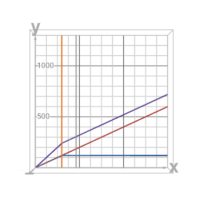

Discrepancies
In the E = M = 50 case, the model predicts Prs = 130W, as shown by the orange vertical above.
But something's wrong, cuz the Specialized Prs table for the SL 2's regular MicroTune gives Prs = 200W for E = M = 50 at 80 rpm. I used the graph's Pri slider to mark this official value with a gray vertical. Big discrepancy.
Now let's look at the model graph for the E = 50, M = 100 case:
Model says Prs = 261W (orange vertical), but the official Prs table for dynamic MicroTune says Prs = 385W (gray vertical). Even bigger discrepancy.

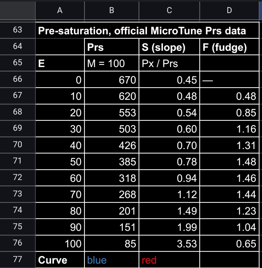

How to fix the model?
So what's left to tweak to bring this model into agreement with the official SL 2 MicroTune tables above? If we keep the seemingly safe model assumption that the saturation motor power Pms = Px M', the only wiggle room left is in the shape or slope of the pre-saturation Pm ramp.
Can we win there somehow? Maybe.
Fix the ramp's shape?

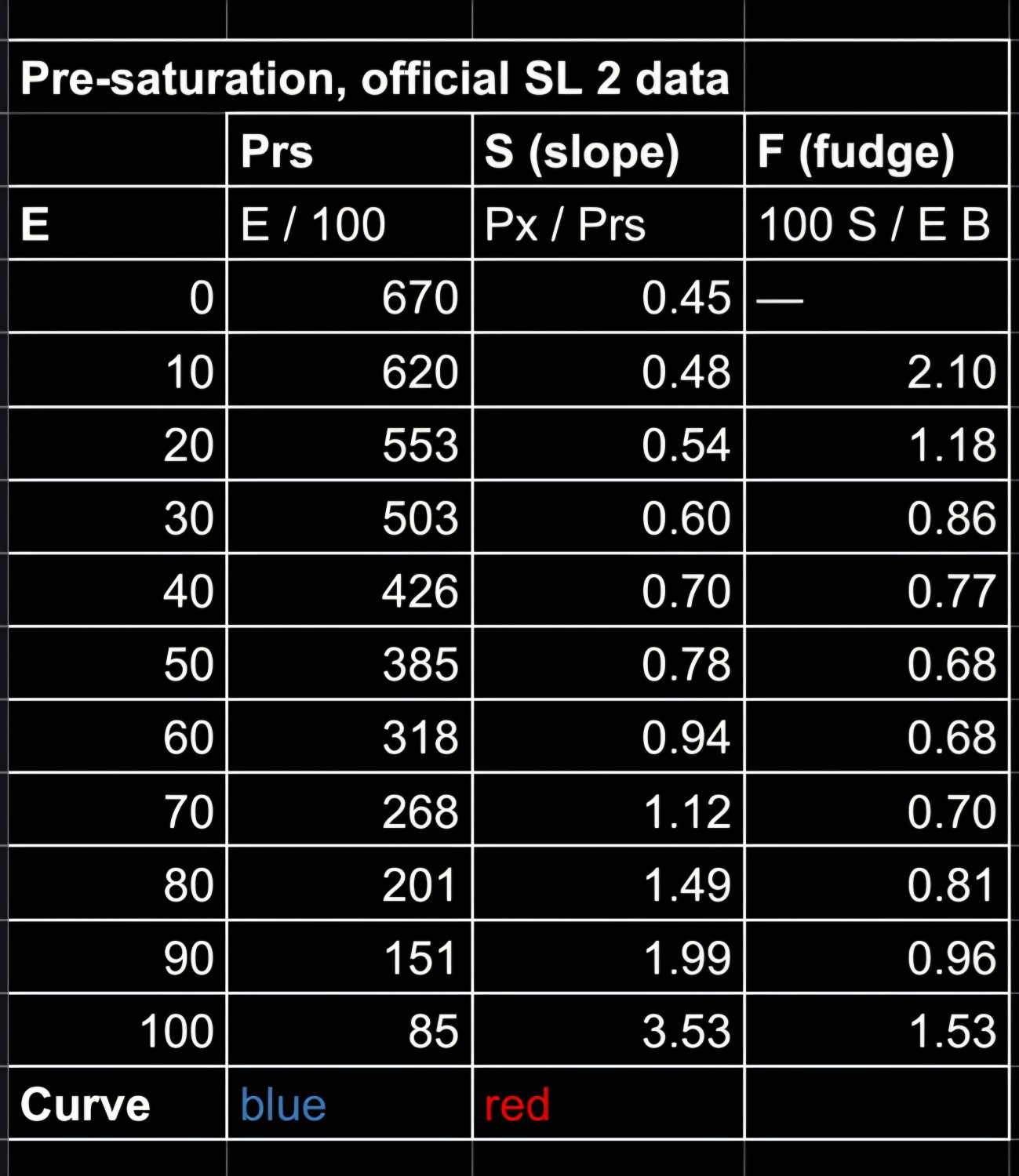

You'll be relieved to know that we don't have the data needed to correct ramp shape by switching to a nonlinear relationship between Pm and Pr. Dead end.
Just fix the ramp's slope?
But we do have the data for a stab at a slope fix. If we keep the Pm ramp a straight line — i.e., keep Pm there strictly proportional to Pr — how could we fudge the slope to get official SL 2 Prs values out of the linear model?
In the existing model, the linear Pm ramp is given by
Pm = E' B Pr,
with slope S = E' B. Boost B is supposedly a motor constant baked into the SL 2, so no fudging opportunities there. Simply picking a different constant B value won't get the job done.
The only way forward would be to introduce a fudge factor F that's a nonlinear function of E, like so:
Pm = F(E) E' B Pr,
so the ramp slope becomes S = F(E) E' B
For the dynamic MicroTune table, this fudge factor F would vary with E as shown in the last column below:
EDIT: F values (column D) corrected Jan 27, 2026.
Since E only comes in multiples of 5, it'd be easy enough to interpolate the above into a complete E-based look-up table for code or spreadsheet use. A Desmos graphical model might also be possible.
But what about the regular (E = M) MicroTune Prs data? This F(E) fudge factor has at least the right shape to work there, too. Stay tuned.
EDIT Jan 27, 2026: The F values above correct the Prs model for M = 100, but DO NOT correct the Prs model for E = M.
I just think the data for the last data row is wrong (Specialized fault). It looks good for other data rows.
