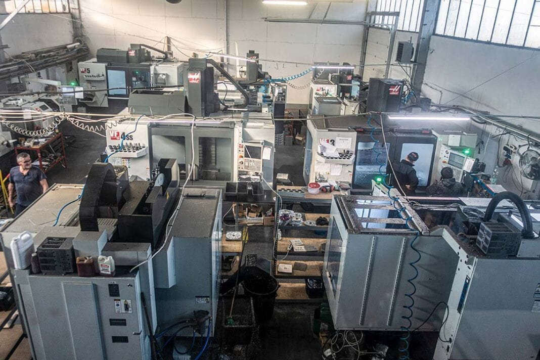

I am delighted with the quality of Garbaruk's components. Did you know he was Ukrainian with the manufacture in Poland?
Garbaruk factory in Nowa Huta, Poland. (An industrial city near Cracow).
