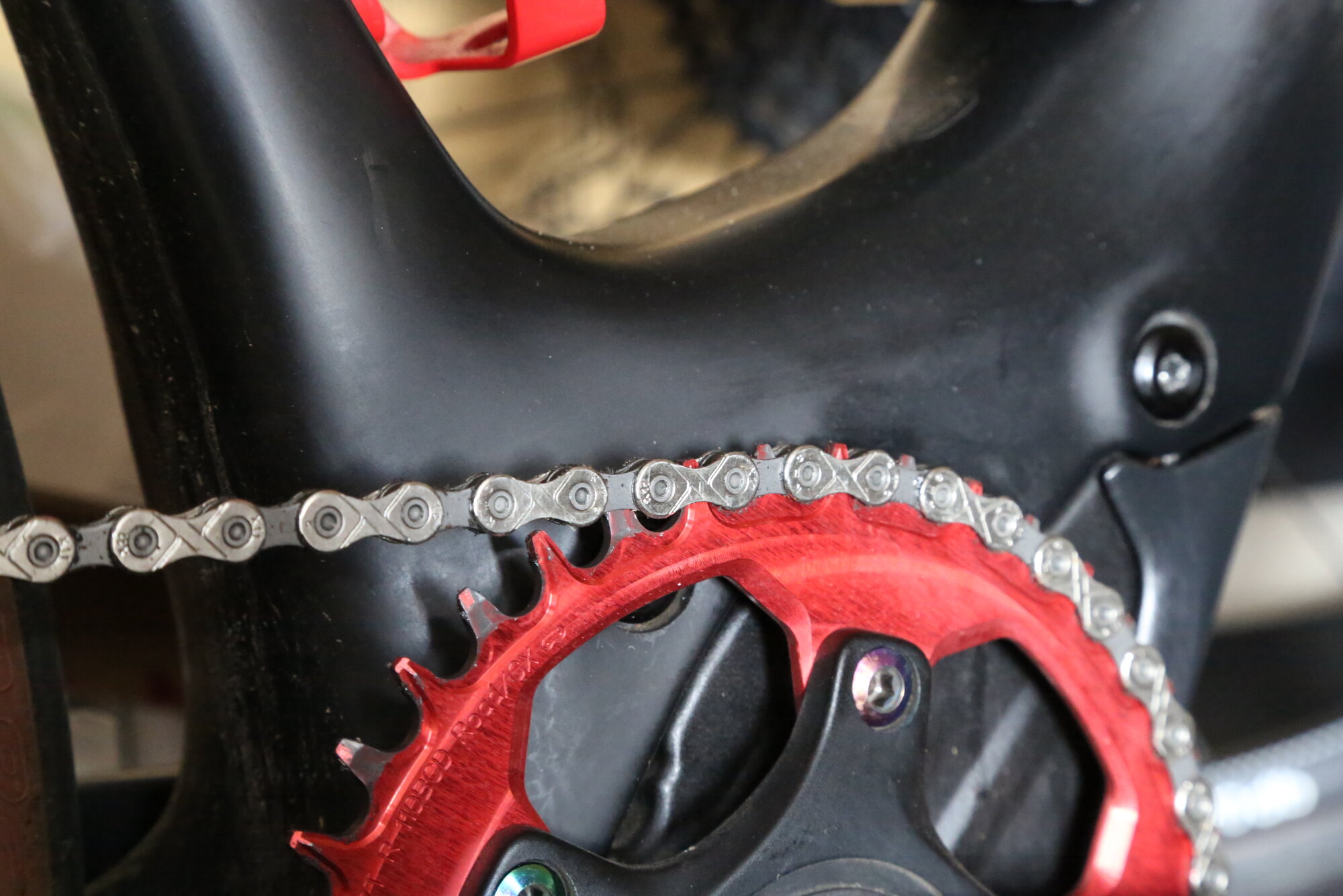

I finally ordered the part below to keep the chain where it belongs. I did not order from that site but it was a quick find this morning.

Garbaruk Narrow Wide chainring. This has taller teeth than Praxis and I have never dropped a chain. Half the weight of the Praxis one to.
Does it also require aligning the chain plates to the tooth position like the Wave Tech version? But the taller teeth work better overall?
Yes it does. The whole idea of the Narrow-Wide pattern is one of chainring teeth is wide (you need to look at the ring from the top), and the next tooth is narrow. Of course, you place the outer chain link on the Wide tooth. (It is important to look at the chainring from the top! The teeth look confusing as seen from the side).

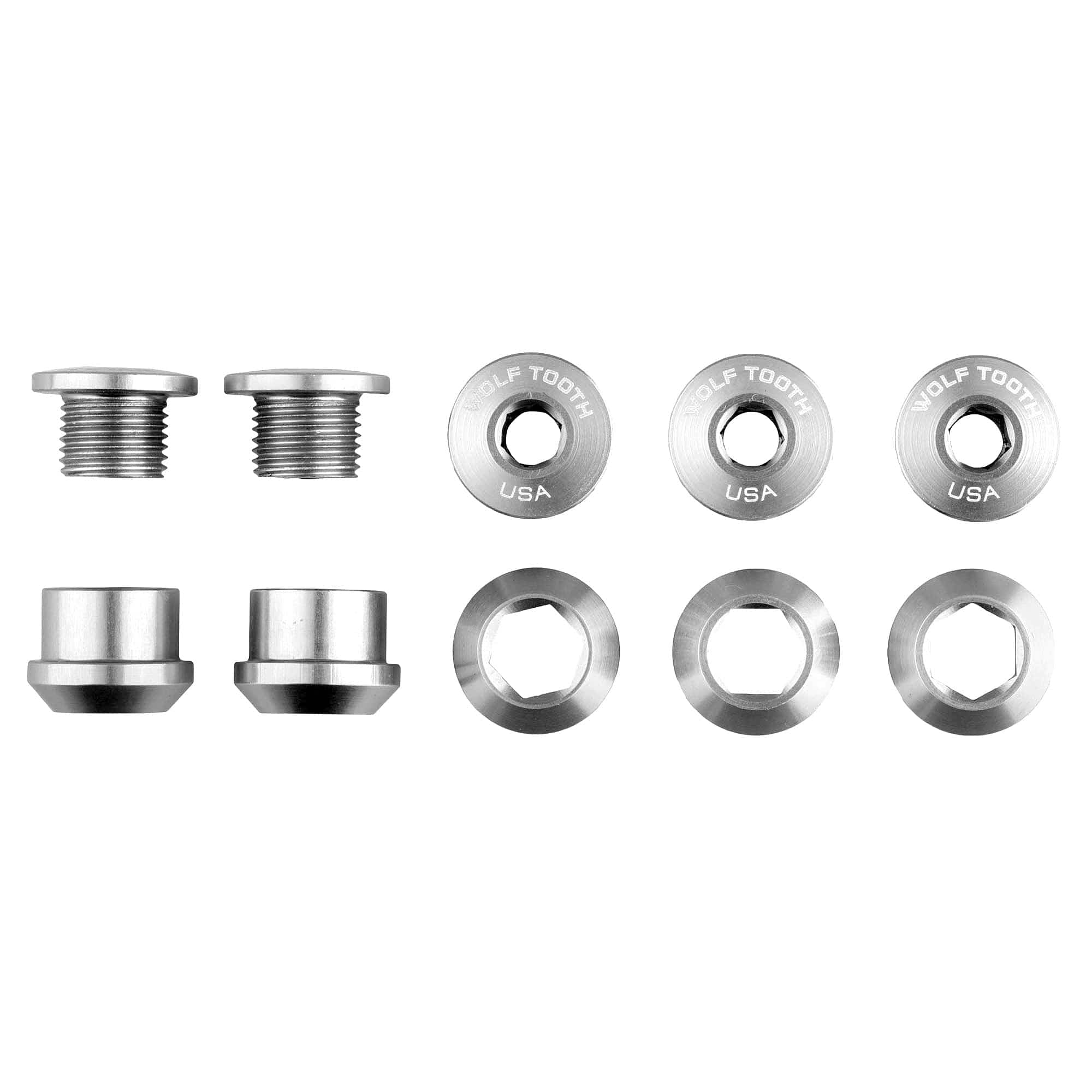

the praxis chainring has threads in it, so they take one bolt from the outside through the crank spider and into the chainring. the garbaruk and wolf tooth are smooth holes, so you need a male and female bolt (a sex bolt, yes, actually called that!) to make the connection.
it really is very easy.
here are the wolf tooth bolts

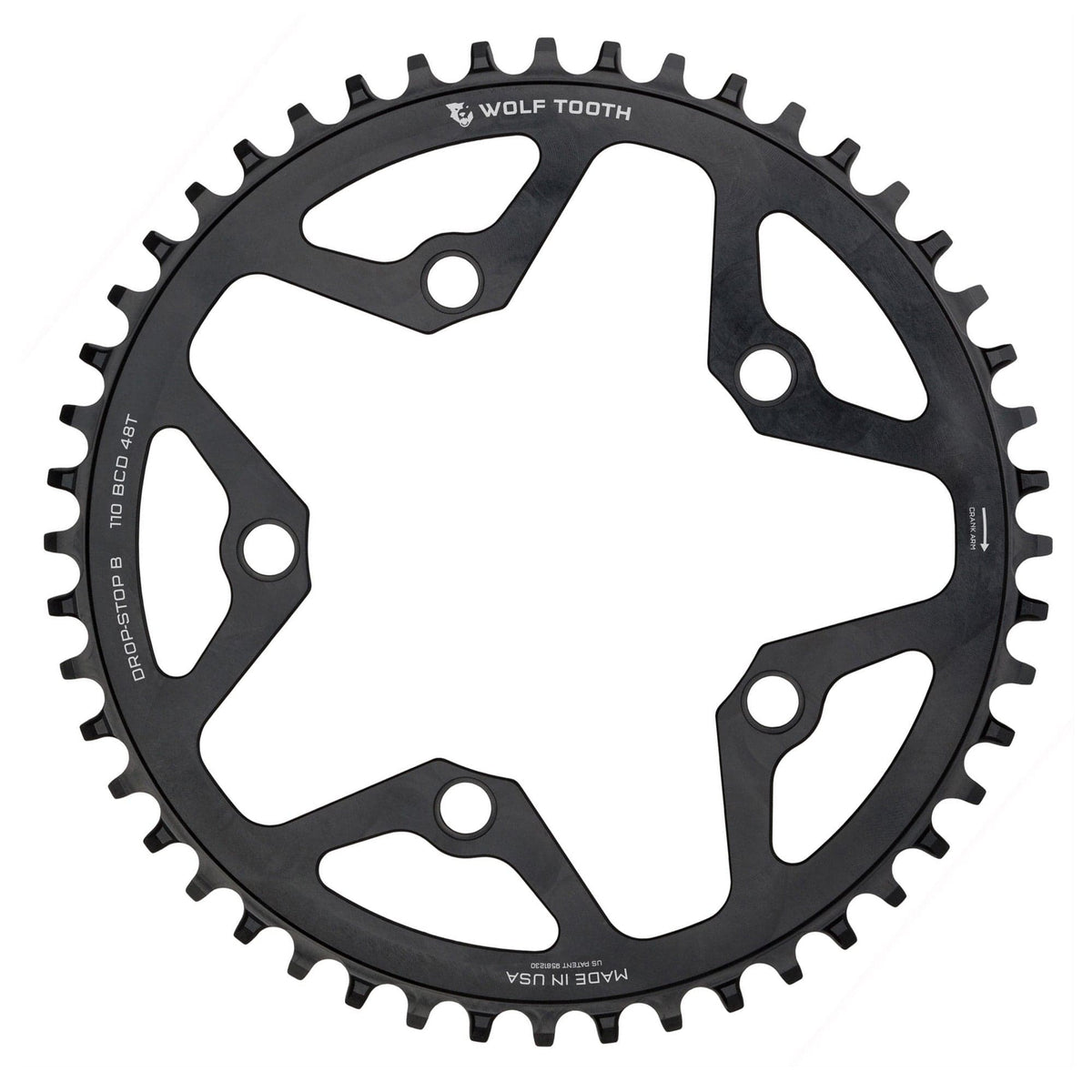

and the chainrings

There's something Mark I want ask you about. What bolts are used for the 110 BCD 5-hole rings? Are the bolts threaded or use a nut? Is there a kind of industry standard there? I'm asking because there are many different things in road bikes!
104 BCD, 4 unthreaded holes is the MTB style even if a classical MTB ring ends at 38T :) Other brands making mid-motor commuter ebikes also use bigger 104 BCD rings.
the stock praxis ones are threaded, but the replacement wolftooth/garbaruk are smooth holes for a sex bolt setup as linked above. the system is the same concept as the vado SL but it is 5 x 110, presumably inherited from larger diameter rings? on a traditional 2x/3x non-mid drive road bike it works a bit differently to attach both rings, but also not threaded, at least shimano. i think the threaded praxis ebike chainrings are somewhat unique to ebikes. not sure.
Thank you! (I missed your earlier post). I can see the road-bike bolts are different from the MTB ones. And I would say Specialized have been using the Praxis rings because threaded bolts are only accessed from the outside, while using a nut requires that you work in the tight space between the ring and the motor to insert and secure the nut.
