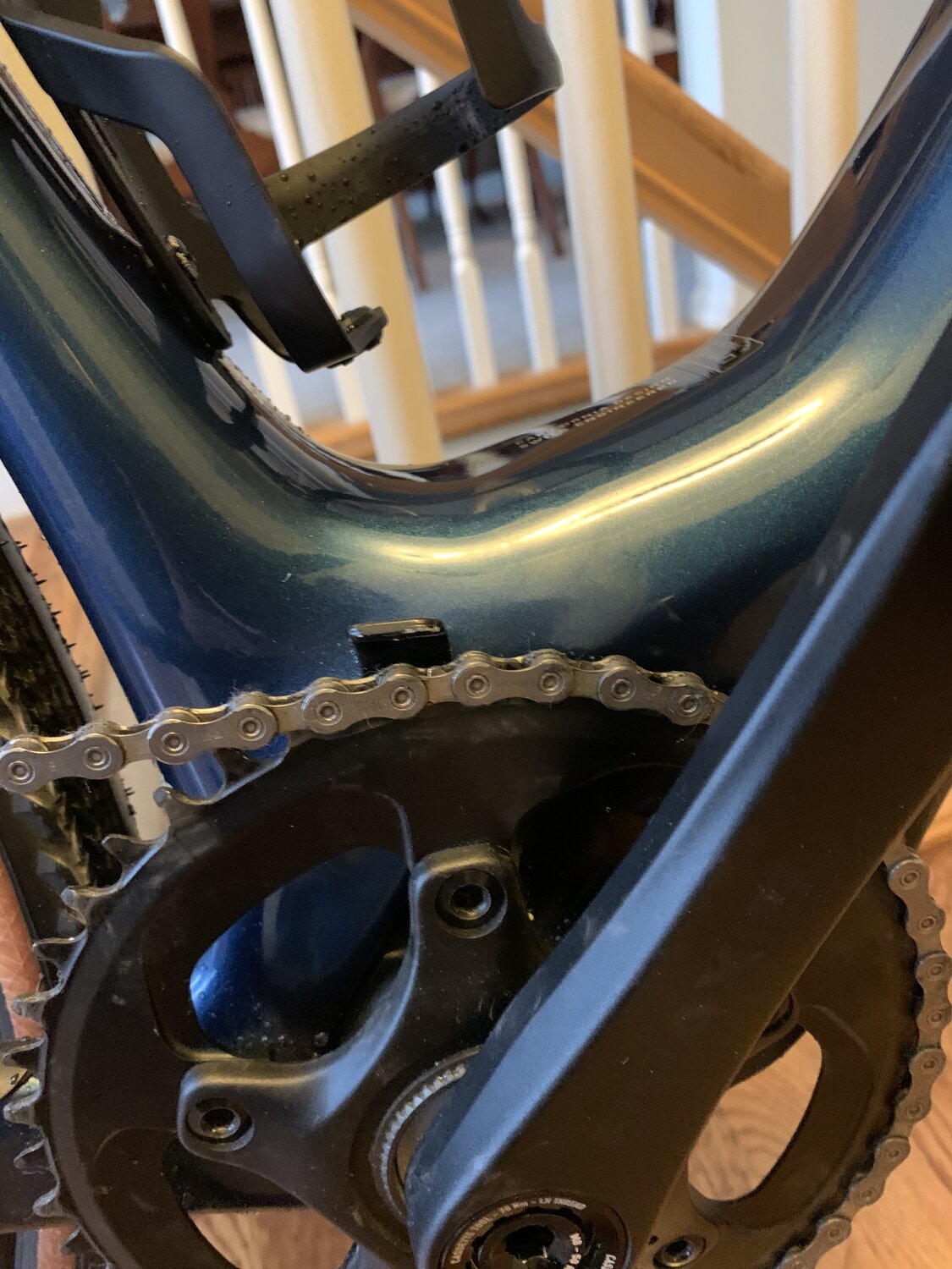

I think the remote buttons are an essential accessory. Without them, it is more difficult to change support level and you probably won't do it as often as you should. You can add the remote buttons to the handlebars on any Creo. In the US they cost about $70 USD. Also some of the the 2021 models have a chain stay which can also be retrofitted on a 2020 Creo. I have a 2020 Creo CC EVO and I had my bike shop install both the remote buttons and the chain stay.
What do you mean by "chain stay". Do you mean chain stay protector?
I think he might mean a chain keeper. Some people complained of chain drops, especially on the earlier Creo’s. Some other causes seemed to be wrong chain installation: inner and outer teeth on the (wave type) chain ring need to match up with the proper chain links, and the rear derailleur has a clutch lever that locks it. It’s easy to forget to engage the lever after changing a tire or working on the chain. The keeper seemed to be an easy solution for most people.
A "chain guide" :)
I actually prefer KEEPER. It really is not guiding anything but preventing the chain from jumping up and OFF and jammed into the damn works - that is between the front gear and the motor housing.
Or you can also call it a hand cleaner - as you no longer have to grab the chain and yank and yank and keep yanking as you try to lever it out of the jammed position - ask me how I know and know and know!!!!
Maybe chain stay isn’t the correct term. Here is a picture of one. My Creo didn’t come from the factory with one. They came with some ‘21 and later models on some Creos. My LBS got one for my ‘20 Creo and installed it for me. Here is a picture
