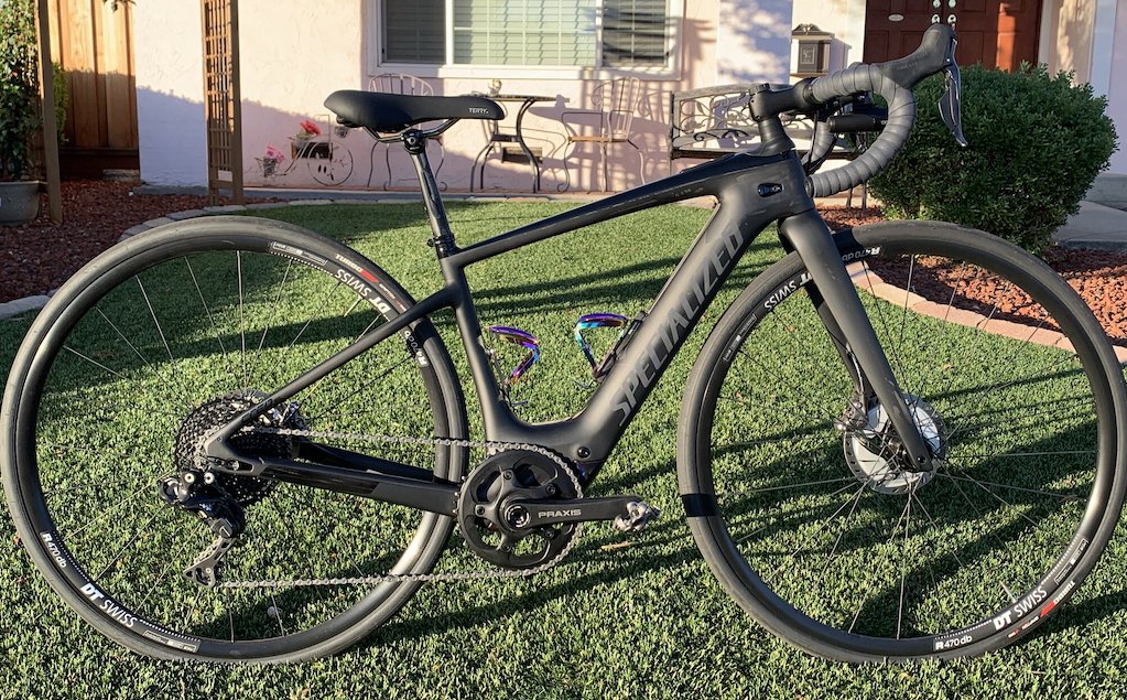

Updated pictures. Replaced the stock wheels with DT Swiss HGC 1400 carbon wheels. Went with the 650b (27.5) wheel size. Installed 40mm tubeless tires. Replaced out the crank arms. Replaced back the 20mm offset seat post, and I think I'm done. Total weight (without Garmin and light) is 13.05Kg.
The 650b wheels help make the XS size frame more proportionate, and also adds more room for the wife's standover bike height. Wife's happy :)

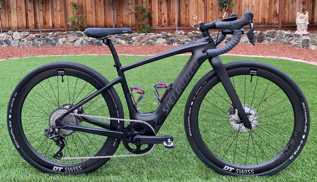

Well done on the upgrades... the new Carbon 650 wheels look just right with the smaller frame.
If you want to lose more weight you will have to go with Ti fasteners... ask me how I know. ;)
Looks great! Who ended up doing the wheel build?

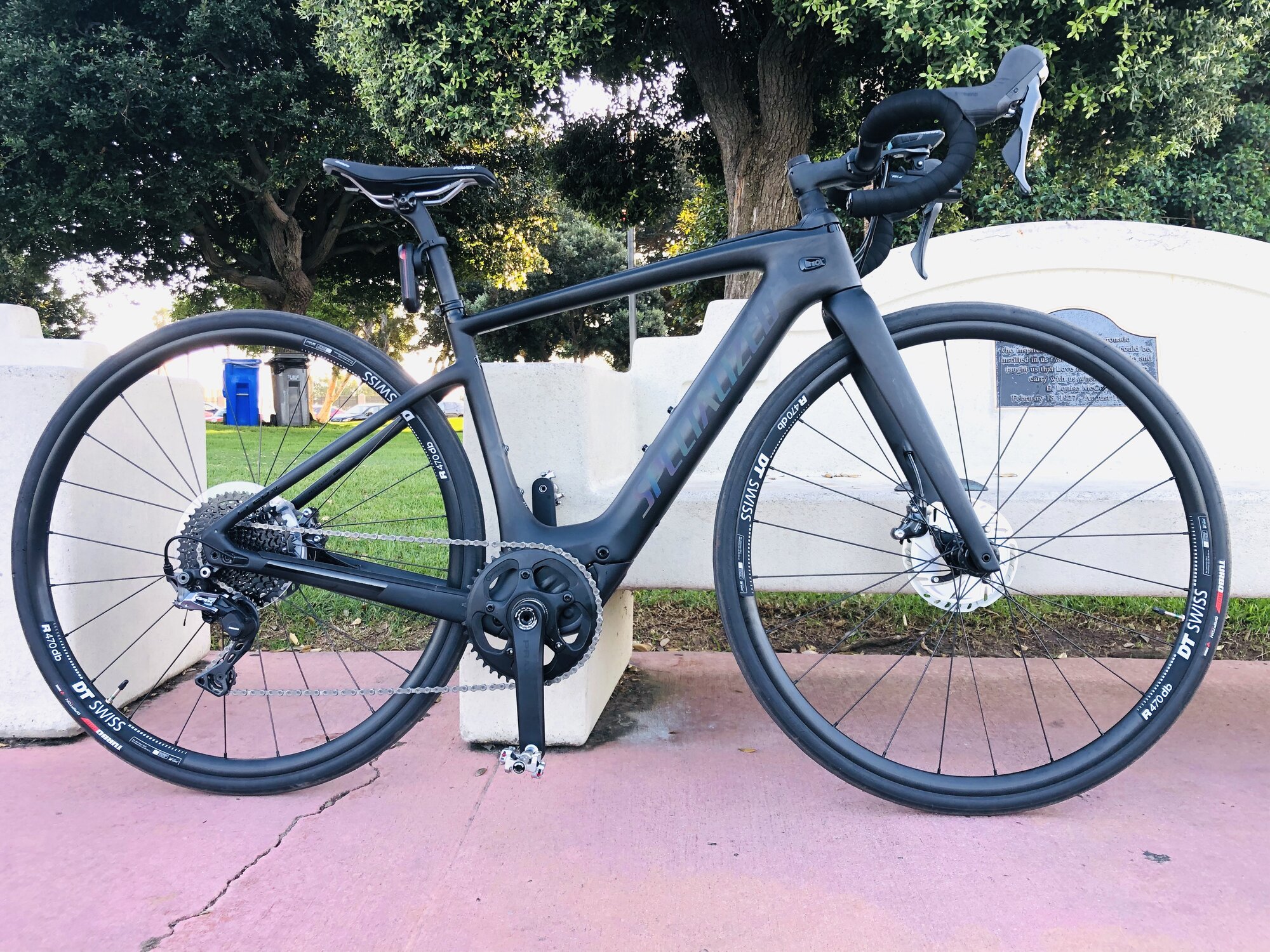

My wife's new CREO Comp SL, size XS. Wife loves the bike, mainly because she can now ride with me on longer climbs (and even beat me up the climbs). She uses mode 1 for flats (25% assist and 35% peak) and mode 2 for climbs between 4% and 15% grade (35% power and 50% peak). At 15% grade, she's maintaining 6MPH (9.6kmh). Even with the assist, her heart-rate is still in the 140-150bpm. I enjoy it mainly because she gets to ride with me on routes that I normally would go solo.
Some pics of her bike. Installed Di2 shifters, Di2 XT derailleur, short reach handlebar, s-works seatpost 0-offset, and Terry Butterfly Ti saddle.

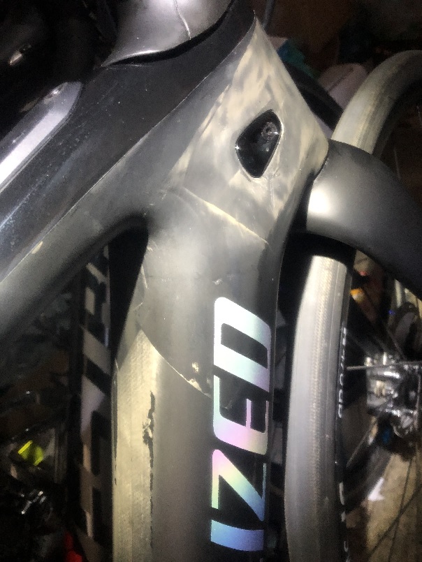

As to those pics of the weird 'stained' not so stained sections: EWWwww 😕
It's called Uni-directional UD carbon fiber and is one of the best composites available. ;)
