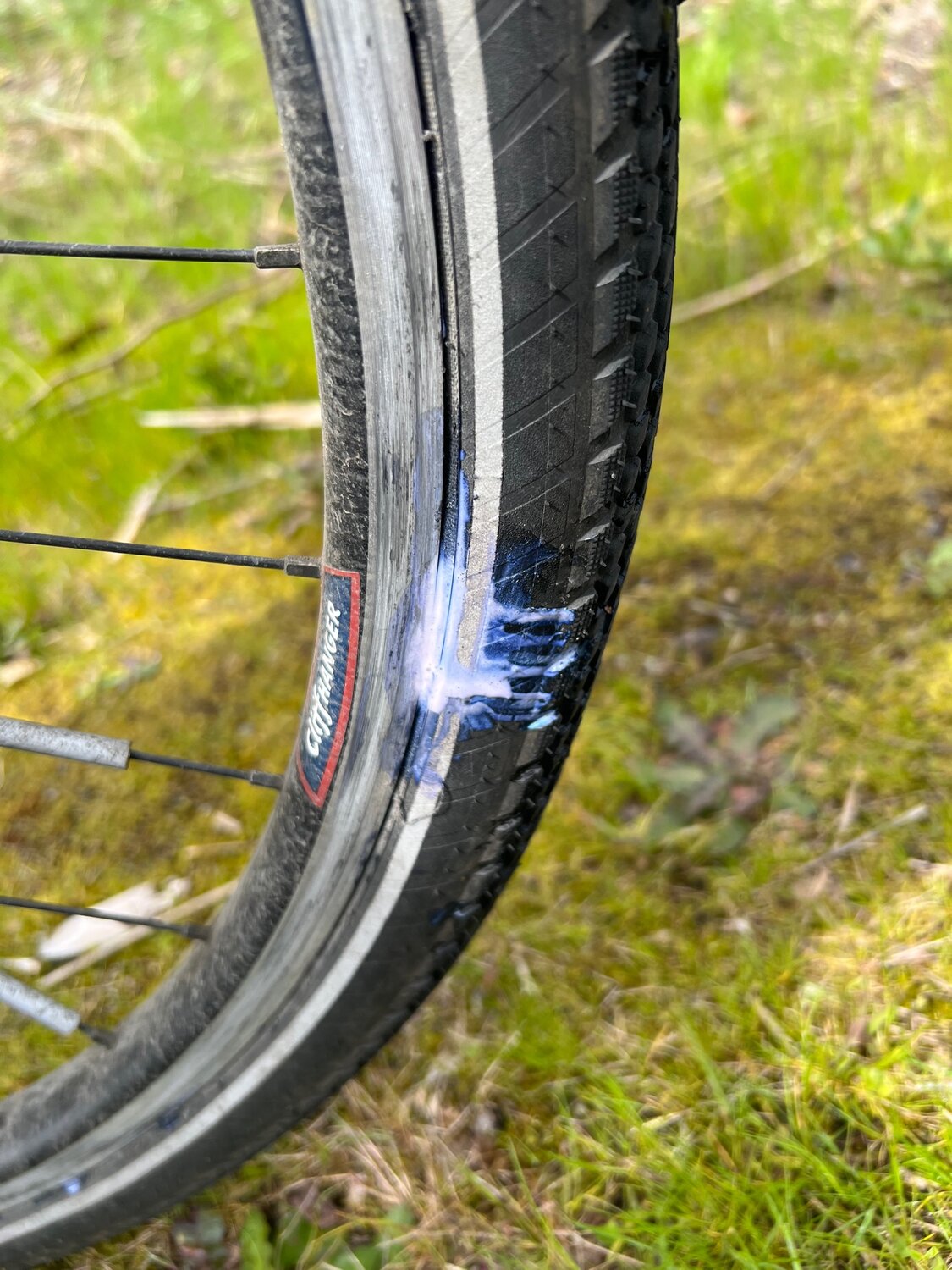

I have dynaplug expensive but very easy to use. I ensued them on this one tire they worked fine but the tires had issues. they are a permanent plug where the bacon strips are not. I chose Muc-off sealant as it has a longer life and may seal bigger holes. I carry CO2 a spare tube the dynaplug a small bottle of muc-off I used a stans bottle. tools to take the tires off. I goofed on out tire on the tandem I thought the min pressure was 40 but it was 50 and some riding on the lower PSI caused this leak that would not seal. Man the mess of putting a tube in was epic.
Thanks for sharing your experience, Foofer. Do you mind if I asked what caused your puncture as it appears that it’s somewhere along the sidewall. I’m leaning heavily towards the Dynaplugs but wanted to see if anyone else had any other recommendations that would work in a pinch. I don’t plan on switching sealants at this point but good to know that Muc Off is working for you.
Edit: Sorry, I realized the leak was coming from the rim due to the tire being ridden at a much lower PSI.

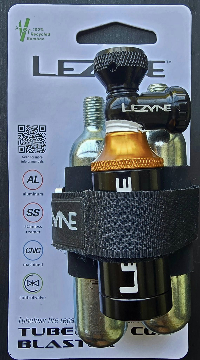

Lezyne Tubeless CO2 Blaster. Let us see how it works shall the need arise. So far, four months of puncture free tubeless rides on my Vado SL.
