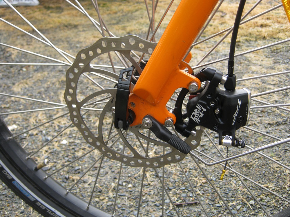

  1. TRP HY/RD Hydraulic Brakes recommended by Windmill. Another upgrade that seems almost plug and play with the RadRover. The master cylinder is part of the caliper, and can be actuated by any standard cable brake setup. More from Windmill here.

I upgraded the brakes on my Radwagon to TRP HY/RD cable actuated hydraulic brakes. It's basically no more involved than swapping calipers as one may retain the OE levers and cables.
Wow, I'd never even thought to look for something like that. Just to make sure I've got it straight, these are hydraulic disc brakes, but they use standard brake cables, right? That's awesome, wouldn't even need to worry about re-running the integrated cables. Awesome find!~
I checked out these brakes and they have them for 140mm or 160mm size rotors. Didn't dig deeper about 180mm-200mm rotors. It seems it wouldn't make that much of a difference at 180mm?
How do the new brakes feel compared to before with the hybrid setup? Did you keep the original rotors? How easy/hard was the set up? They look almost plug-n-play out the box?
That is correct, the master cylinder is part of the caliper, and can be actuated by any standard cable brake setup. They're well thought out, installation is ridiculously easy, and they work just as good as full hydraulic brakes.
The primary reason I chose them is that I could retain the OE levers with their integrated power cutoff wiring.
TRP also offers 180mm and 200mm rotors for separate sale. I initially ran them the OE rotors, and they work fine, it's not necessary to change them, the only difference being a higher grade of material. FYI, TRP is Tektro Racing Products Tektro's premium product lineup.
They are plug-and-play, installation and setup is actually easier than adjusting the OE brakes. (Link Removed - No Longer Exists)
The difference is significant, they work and feel better in every way. With upgraded Jagwire mountain pro cables, they're every bit as good as a full hydraulic system.
I am still a little confused as they make separate calipers for 140 and 160. So you are saying you can use the 160 mm model with the existing 180 mm rotors on the RadRover?
To add to Tom's question:
Did the TRP brakes come with pads or did you have to purchase those?
Calipers are all the same standard size, the only difference between disc sizes is the separate adapter mount one would use, both size mounts are included. As the adapters are standard sizes too, one can simply use the existing OE adapters with the new calipers.
They come complete with pads, which are the same as the OE pads, and the most common Shimano B01S size
OK, that makes sense. One adapter site said that most forks are setup for 160. Then adapters make up the difference to the larger rotors. Thank you!
