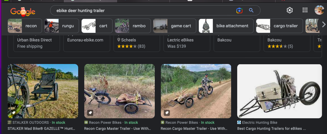

search

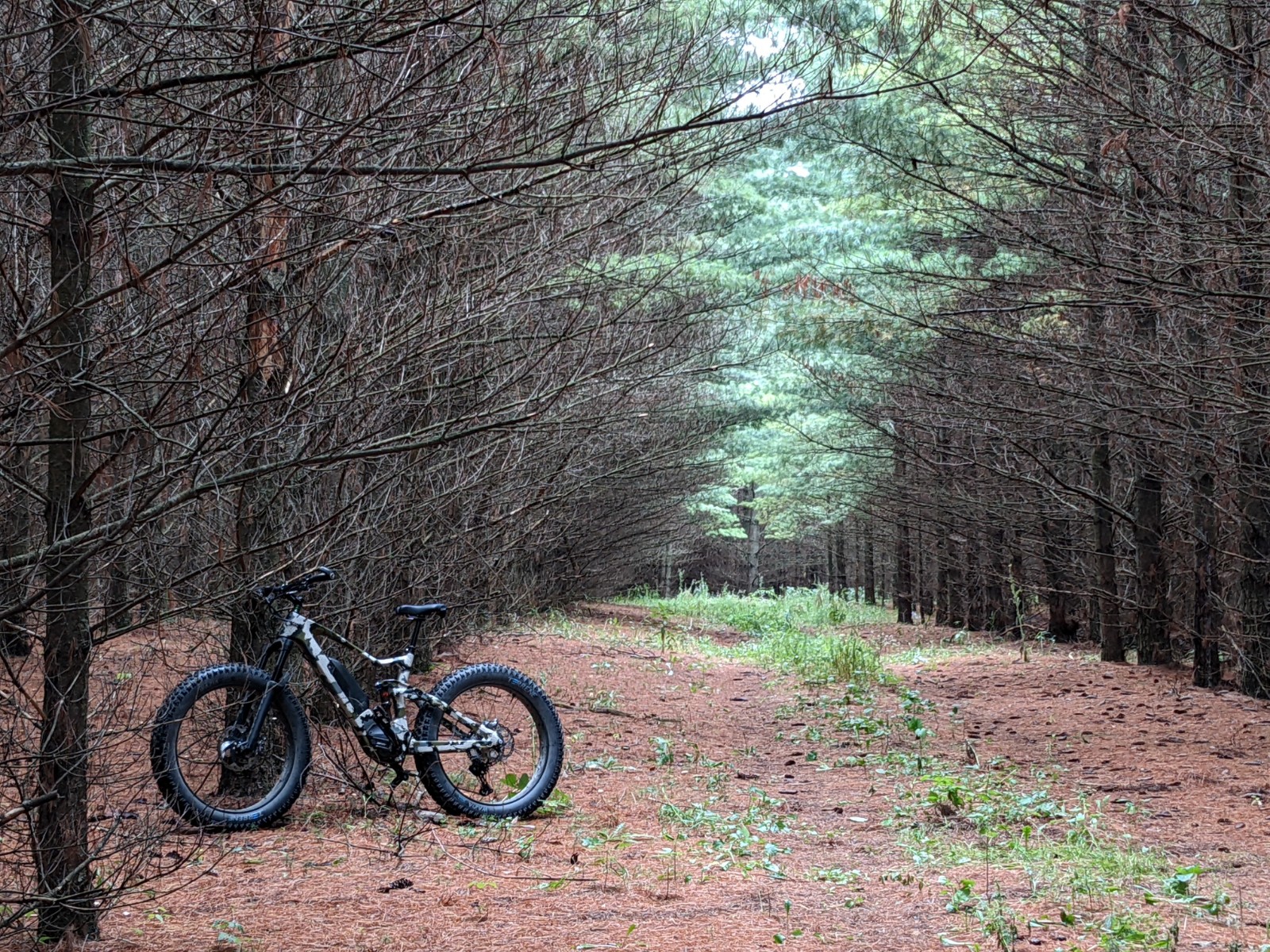

DaveV I will tell you this, they are a game changer, you can get into spots so quick and quite!
The first time I rode mine hunting it was in the morning and pitch black. The display was so bright I couldn't look down at it. I finally tipped it down at a different angle and that did the trick.
Tom's pictures (above) sort of reinforce my point. I'm sure you could cope pulling a deer back to camp on a well packed/traveled track. Up out of a gulley, dragging from a swampy area, and a hundred other similar not so well traveled scenarios/areas that come to mind here, probably not so much - not with a geared hub powered bike (like the Rad Rover in question) anyway.

@tomjasz is on the right track with the trailers. Here's a link to the QuietKat game hunting trailer (which does not require a thru-axle on the rear tire to connect to) Link: https://quietkat.com/collections/trailers/products/quietkat-cargo-trailer-2-wheel

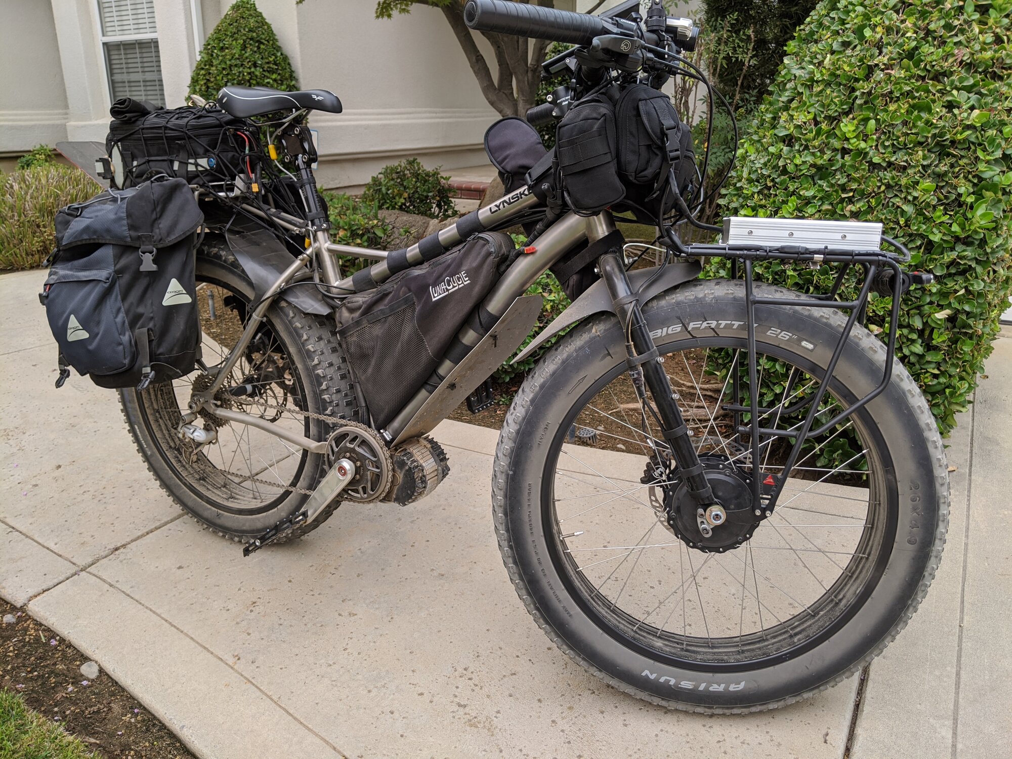

In an ideal world a 2wd bike with a BBSHD powering the back wheel is going to be head-and-shoulders over any other option. But that is a major project not suited for a beginning builder unless they are very much mechanically inclined. The only 2wd commercially sold bikes I know of are, to put it indelicately, garbage. High on price and low on features. I'll skip the specifics of why unless someone is interested (I would not lump the Christini bikes into the garbage category but they are very different animals that shift power from wheel to wheel and do not power both simultaneously).

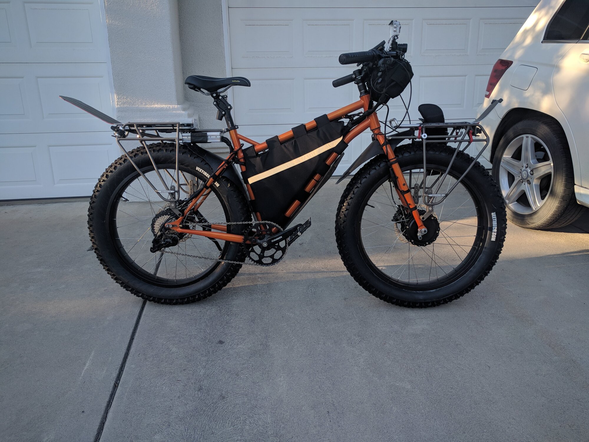

From my own garage, here's what I would be using, although that ti frame would get swapped out. Believe it or not I have one from the same manufacturer in chromoly. The orange one below. Also a 2wd bike, but twin hubs. Maybe what I would do is just swap the motor and back wheel from one to the other.

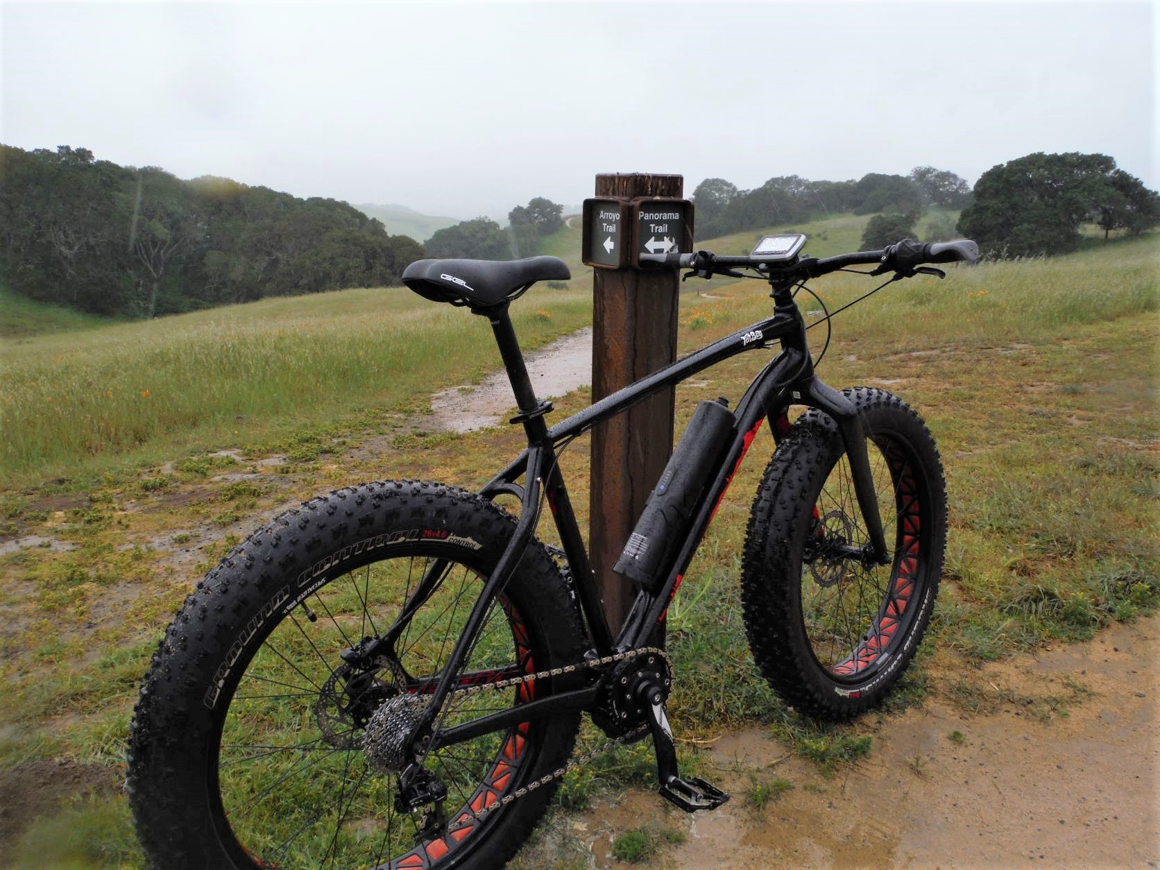

This was my first hunting bike,
It has some minor quirks to it but overall it was pretty good tractor! I hauled a couple deer and I pulled my flipover ice house out on the lake through snow with ease.
I give it a 7 out of 10.

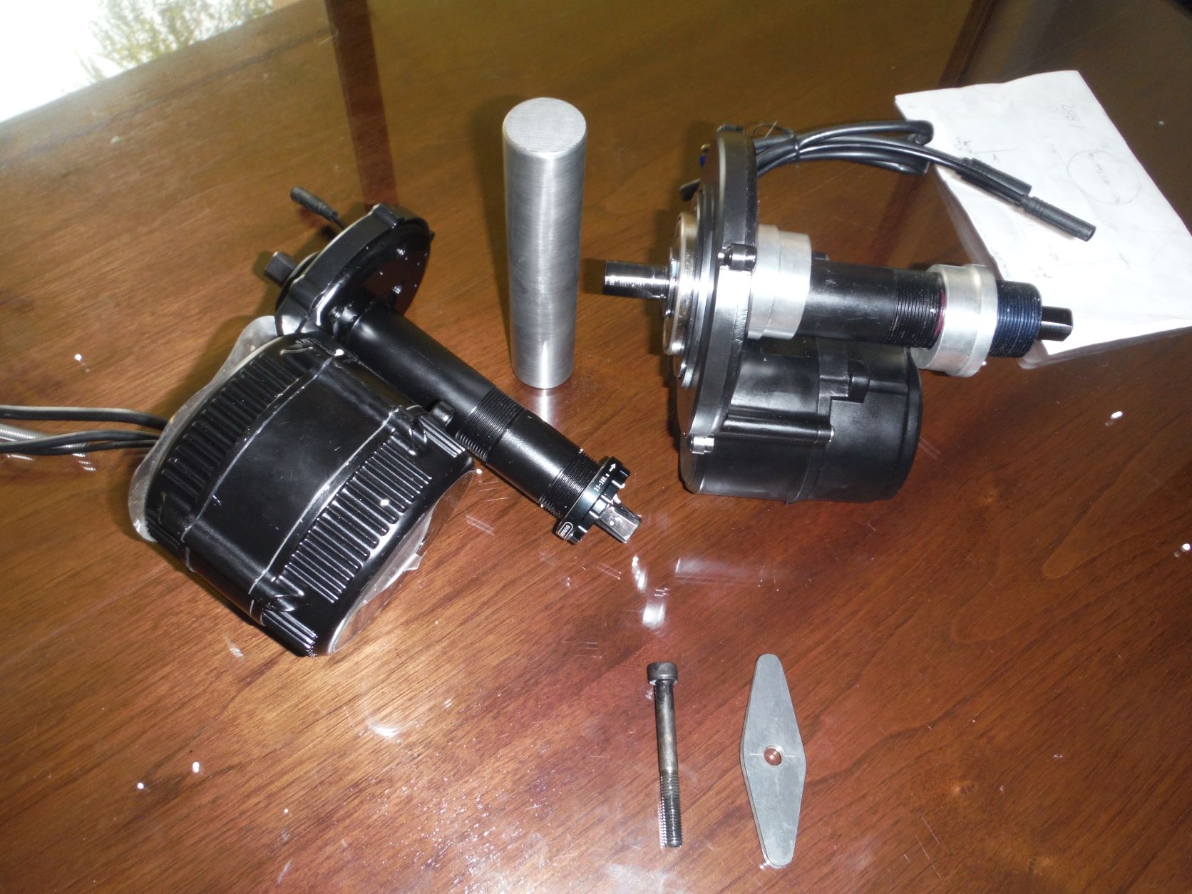

Is that a BBS02 inside a housing?
