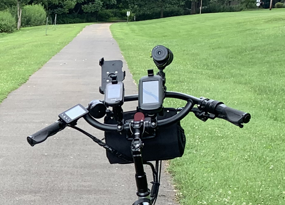

My bike doesn't have a OEM computer. It just has a basic display which will not perform any navigational functions except speed & distance. Being an engineer, I like a lot of data in front of me when I ride. I use Jones H bars which have a lot of space to mount my gadgets:
I use two Garmin GPS units, one to display a map and the other for statistics. This saves the effort of switching screens on a single GPS and everything is available at a glance. It certainly isn't a "minimalist" approach and I get a lot of funny looks & questions about all the gadgets. 🤪

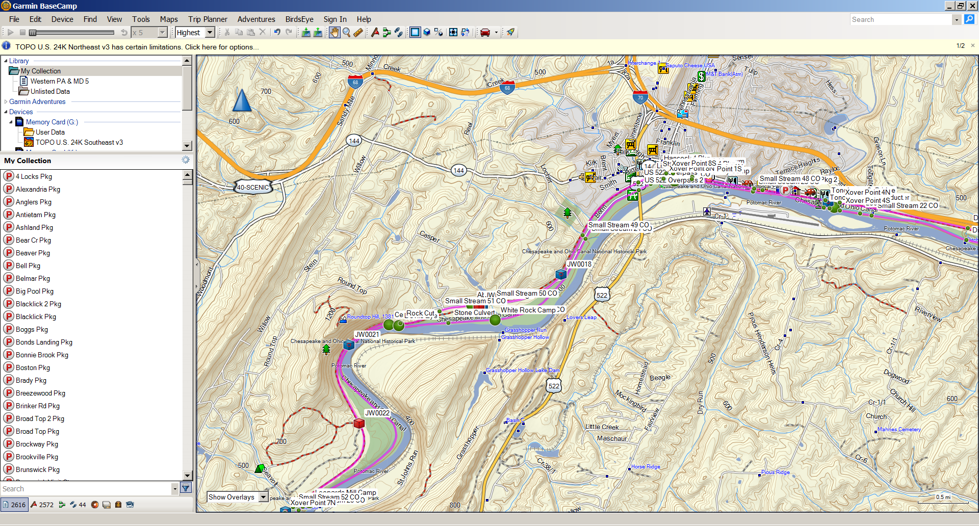

Actually, you can't build a .GPX file directly in Google Earth. You first make a .KML or .KMZ file in GE and import it into another program to create the .GPX file. I use Garmin's free Basecamp software: https://www.garmin.com/en-US/software/basecamp/
The advantage to building you own files is you get to choose the information you need and exclude the rest. Fine location details can be added which aren't available with most nav apps. In my case, it gives me something to do in the off season when I'm not riding.
Once you create the .KMZ file in GE, it's an easy 2 step process to import it into Basecamp and then upload it to a GPS. There are many programs available that will let you do this. I use Basecamp since it works well with my Garmin GPS receivers.
This is a screen shot of a file I created using this scheme. It's a section of the C&O Canal and parallel WMRT trails (magenta) in western Maryland near Hancock. Some of the waypoints overlap until you zoom in on the GPS screen:

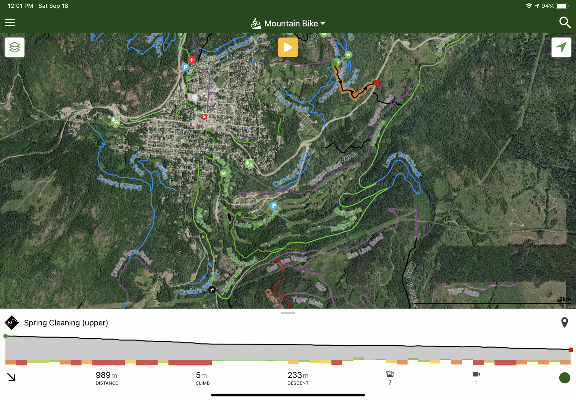

For finding and navigating "real" MTB trails with my phone, I'm partial to Trailforks (link to website version of their map). In my experience - albeit mostly in my region (New England) - the app is easy to learn and use, and trail systems are accurately laid out. Its GPS tracking works well on my Android, and because it's a volunteer-run outfit that (kind of) supports eMTB access to MTB trails, I purchased the premium version.

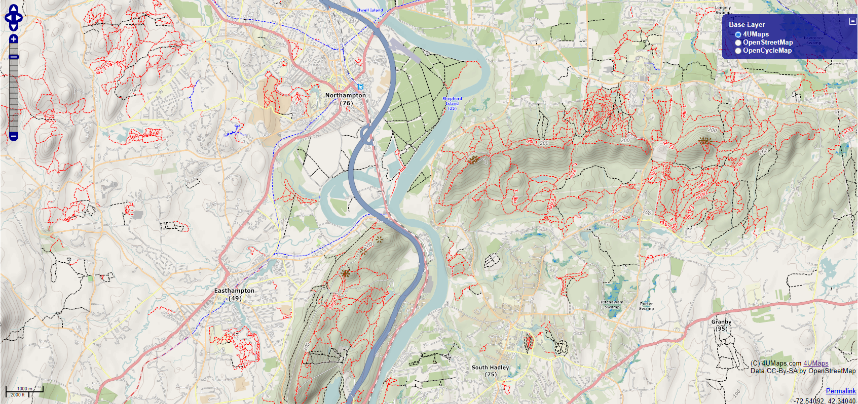

Trailforks tends to focus on singletrack, however, and sometimes my explorations take me to ATV trails, fire/logging roads, etc. that aren't shown on that app. For those, I've found that apps with maps that use Open Street Maps and/or Open Cycle Maps as their basis are the most comprehensive. OSM/OCM are somewhat akin to Wikipedia in that they're "...created by people like you and free to use under an open license." I've actually made some edits when I saw inaccuracies. There is an app called "OsmAnd" that allows for offline use, but the free version seems clunky to me, and its base map layer is difficult to decipher.

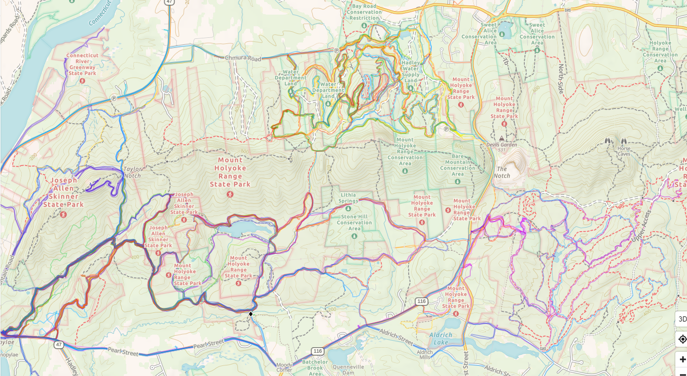

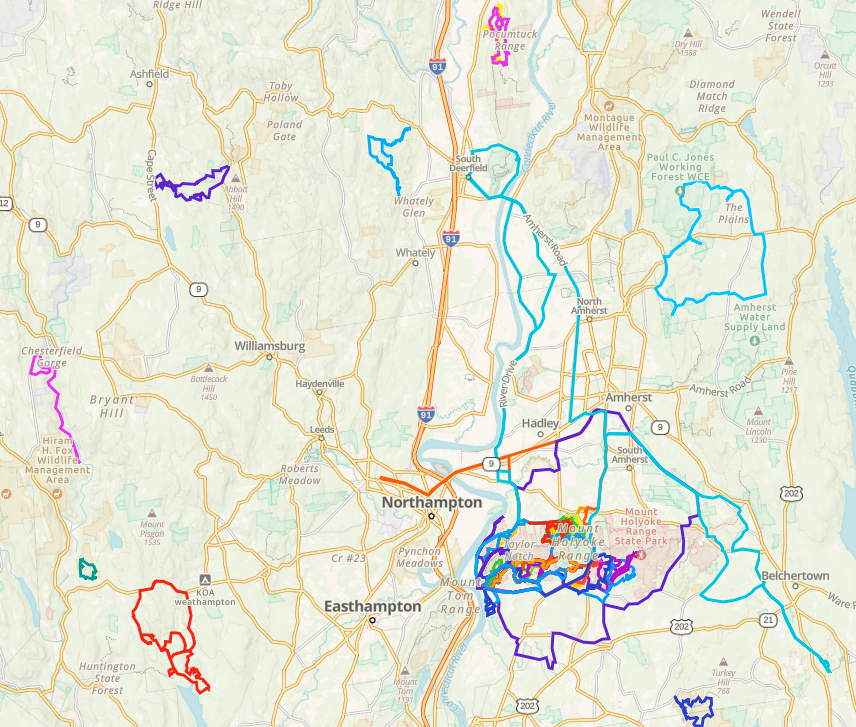

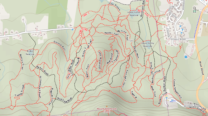

I've never tried OsmAnd's paid version because the free version of the MyTrails app, which seems to only be available for Android phones, works well enough for my purposes. It has multiple map layers available - I find the 4UMaps option, which is based on OSM/OCM, to be the easiest to read by far, with thick red lines on white and light green backgrounds. Pasted below is a wide screenshot showing its depiction of systems surrounding me - when you zoom in, it shows most trails' names, as well (second screenshot). The MyTrails app also does a good job of tracking my rides, though I still prefer using Trailforks' tracking, even when riding trails they don't show.

The pic above is pretty awesome of all the electronics on the bike. What’s the round device mounted above the gps unit?
It's a 12000 lumen floodlight I use for tunnels and night trail riding.
It has a self contained battery that recharges via the USB port on the bike display. It also removes easily for portable use.
