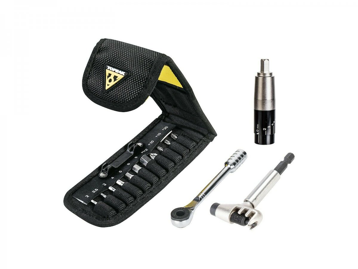

I carry a topeak portable tool set on my rides. It includes a torque tool that goes up to 6nm as well as a chain tool and a smart variety of hex and torx bits.
https://www.ebay.com/itm/Topeak-Rat...e=STRK:MEBIDX:IT&_trksid=p2060353.m2749.l2649
https://www.ebay.com/itm/Topeak-Ratchet-Rocket-Lite-NTX-Portable-Mini-Torque-Wrench-Bicycle-Multi-Tool/254187303532?ssPageName=STRK:MEBIDX:IT&_trksid=p2060353.m2749.l2649
Thanks for the link, I just grabbed one but although it's named the same it looks different..........probably because I got it off Amazon.
