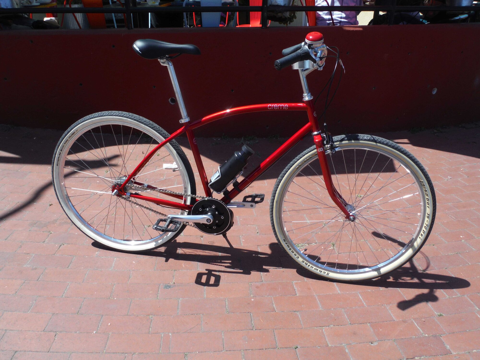

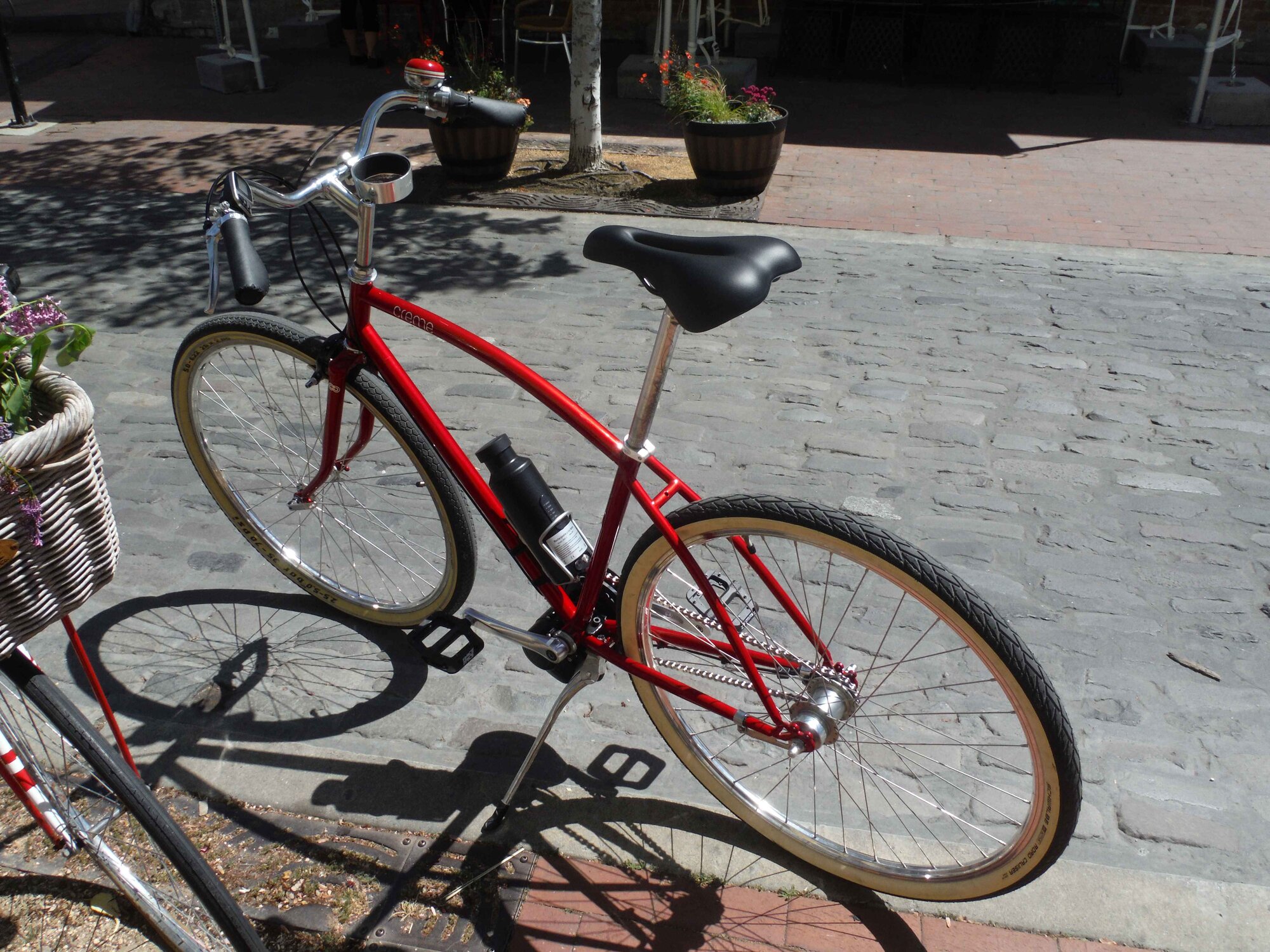

When I do torque sensor mid-drives with coaster brakes they are very sensitive. If they were not the bike could keep going when your foot is on the brake.
Here is a coaster brake torque sensor bike build. I put the motor between the pedals. The owner has hand issues so stopping with her feet was vital.
Sweet! Would not even identify that as an ebike. You are obviously miles ahead with knowledge and experience. Lends credibility to your "silly" suggestion. Will give it a shot.

Thanks! I made this one yesterday. Even the battery wires are inside the frame. No ugly connectors and No zip ties to spoil the build. The hard part was that the rear brake and shifter cables would have been crimped by the motor. I had to reroute them while making them vanish.
Turning off the torque sensor will make the bike surge and lurch. There will be lag. When the torque sensor is in the pedals and not the back of the bike it becomes much more responsive and does not need a throttle - it is in your foot like a car.
