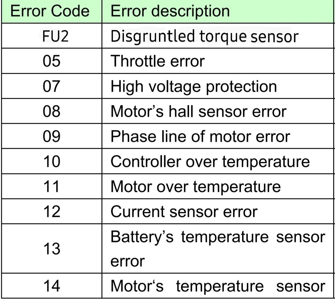

The other day at the end of ride I was tired and started stomping a bit. The bike shut down and the display showed an FU2 error code. When referencing the owners manual I found this. . . 🙃
FU2 error code
I love it!
