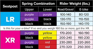

KINEKT's website says (click yourself and look) "PLEASE NOTE: We use 3 different spring lengths. The UPPER springs are all the same size ( 1.5" ). The LOWER springs are different depending on your model (All Bodyfloat, 2.1 or LR models use 1.75" springs). ( All XL2 and XR models use the 2" springs)."
You say "I managed to track down the Amazon page for the XL2 via its reviews. 240-320 lbs for USA market".
Surely, except you did say you changed to an orange spring I'd thought?
So you are at the next level past the correct 270 - 320lb rating (not 240lbs).
For 230 - 280lbs, correct springs are Purple Red.
I've read enough of your posts to be certain you're a reliable source of information, so trying to wrap my head around this.
I know I have Pea-Green striped springs - that logically, I've assumed are Yellow. Hmmmmmmm 🤔.
Could you have Red springs - like in my photo ? Did they change the color code ?
If the other's Purple, you're perfect for a 250lb rider. If it's Black, you're in the 270 - 320lb range.
Anecdotally, nowadays the (HD Model) XR comes with Black/ Yellow (200 - 240lbs) rating springs installed, a Red lower and a spare Purple upper. Thus, one can set the range between 170lbs and 320lbs - for a bicycle. Subtract 10 - 20lbs for more upright seating styles - like ebikes.
That's their current, most up to date information.
The range has not changed, except for accommodating upright riders. The bicycle ratings are the same as 2.5 years ago.
The springs are universal between the two models.

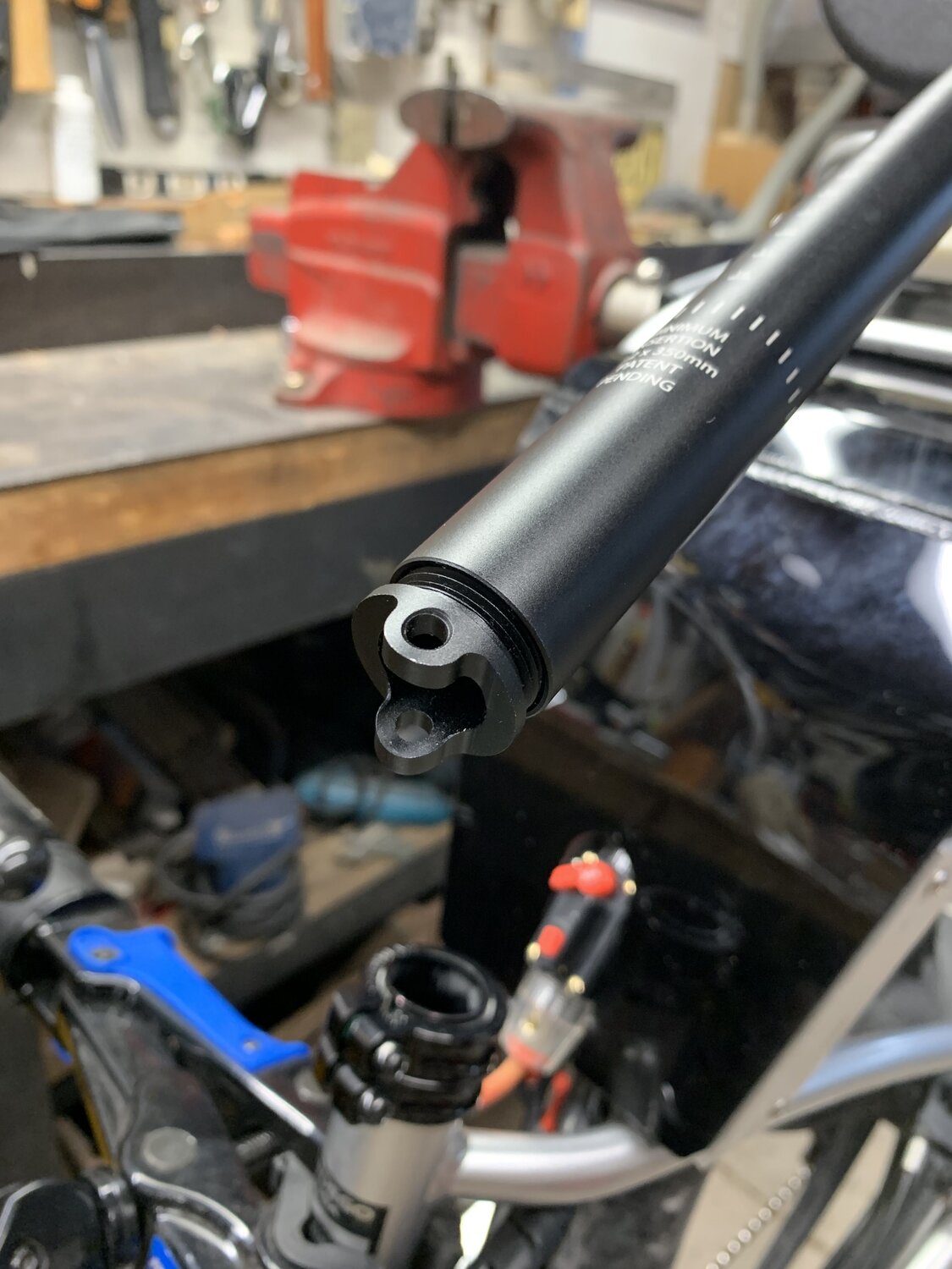

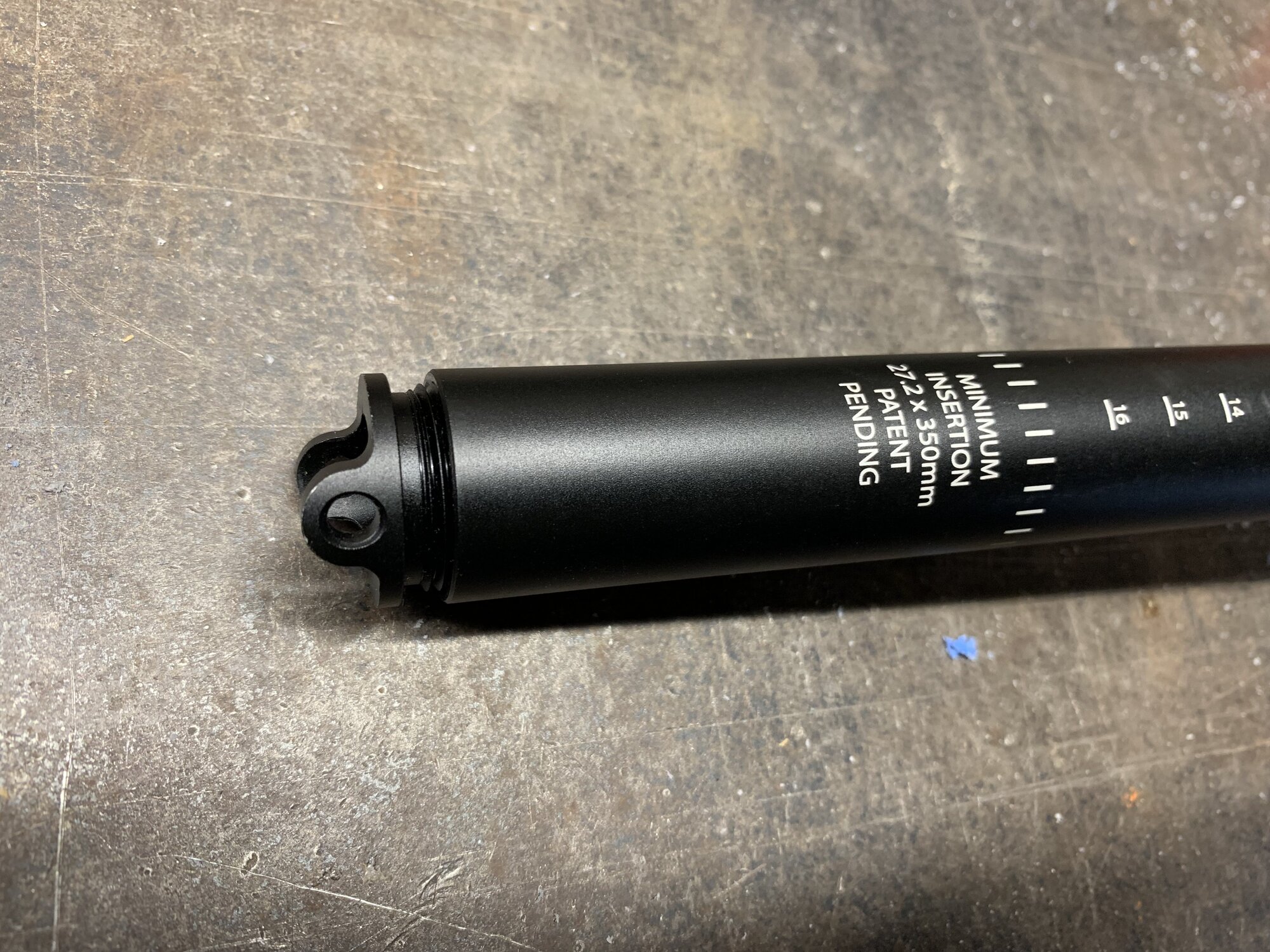

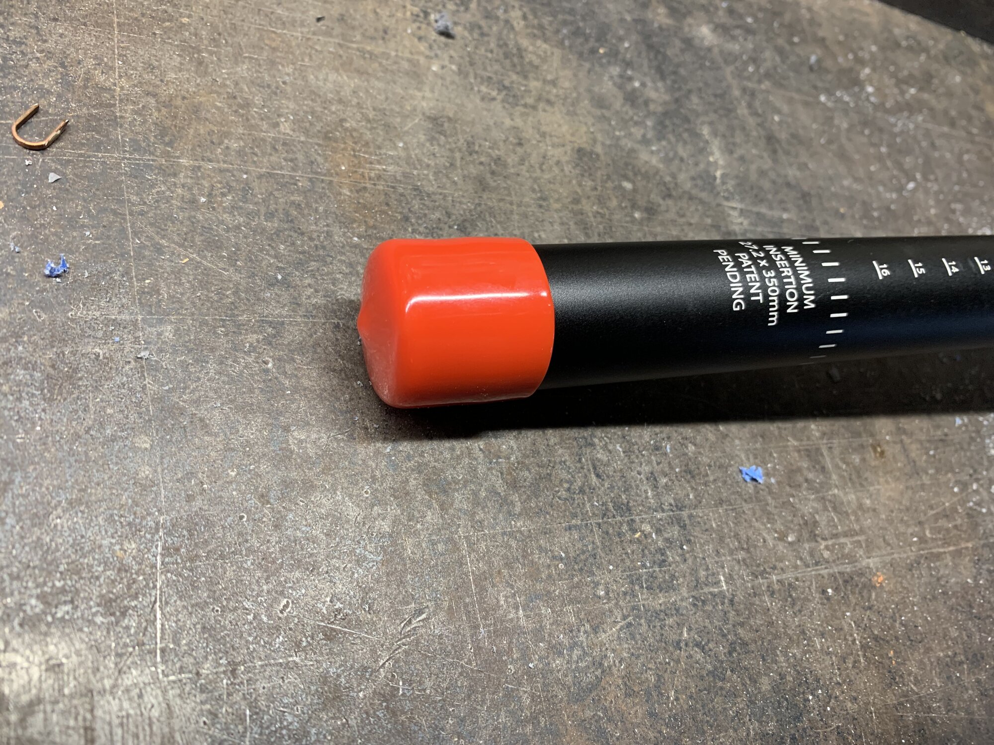

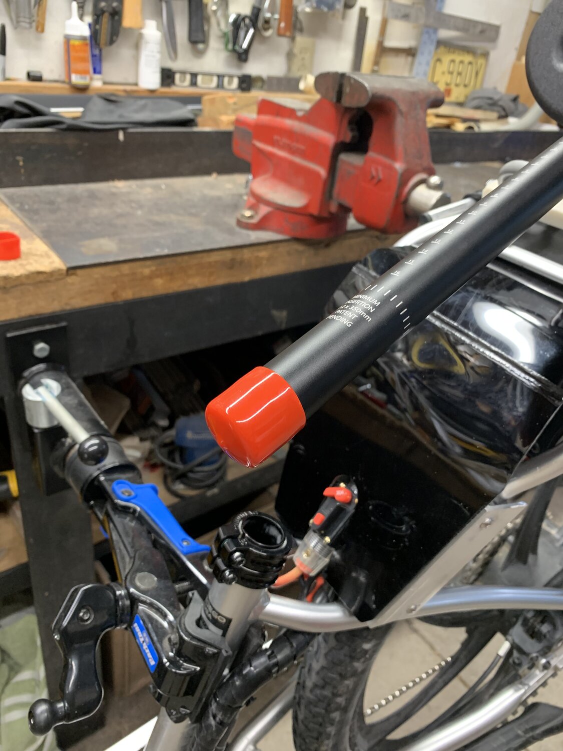

I had an incident with my Redshift suspension seatpost recently. It's not significant enough to post in it's own thread so I thought I would mention it here.
I was preparing for a ride and accidentally bumped the adjustable end cap of the post against the step bumper of my pickup truck. The temp was quite cold and the cap shattered into hundreds of pieces! The spring mechanism shot out of the post and the parts scattered all over. I was able to recover the internal parts but the cap broke into too many pieces to pick up. Fortunately, I had my Kinekt post as a spare so it didn't spoil the ride.
It was my fault and I'm sure it was just a fluke accident. The plastic was probably brittle from the cold and it took quite an impact. I called Redshift and they supplied a replacement cap.
It's just something to be aware of, not a reason to avoid the otherwise great seat post. As a precaution, I now put a 1" vinyl end cap on the post for protection when it's not on the bike.

LSS for me:
Out-of-the-box it was 'okay', but always a bit too soft, too hard, too much, or little suspension effect.
Dialing the springs in to my weight (leaning to the light side) made the difference for me.
Ordering the adjuster bolt (must have), I included 'the usual suspect' springs.
Watching (the older) vid, RE: how to take it apart - while I'm doing it (and yes he forgot to tell you to take one of the screws out), I 'got it'.
It struck me, he (himself) was changing to lighter springs than the chart indicated?
People repairing bikes for years might snicker, but these're new experiences for me.
Thing makes me snicker, the newest vids succinctly explain every issue raised ???
Ride best spots is between upright and road-bike.
For me, that's somewhat to do with using Jones Loop H Bars.
I could decrease the head-clamp length, but tend to ride on the pedals, balanced between my hands and butt.
Naturally: For 'long haul' work, a more forward position's advantageous.
For 'active, city duty', more upright.
Heavy as it is, but for stupendous performance I'd a' dumped it in a second.
E=mc2 certainly won't change.
I would note that an occasional bottoming is a good thing! That's part of suspension 101, as it let's you know the whole 100% of suspension travel is being used. FAR too many set their suspensions (any suspension) so they never bottom. To them bottoming is a no-no. If it never bottoms, quite possibly they are riding around on just the top half of the available travel, loosing out on half of the very expensive travel they paid for.
Point being, "occasional" bottoming is key. My own thought is if it bottoms on an a hard hit once or twice a ride, it's working as designed 99% of the time.... FWIW, -Al
'Bottoming' is key to notifying you have the wrong rate springs installed for your 'style' and 'weight'.
Terminal impact's where something has to give cannot be a 'Good Thing' - it must take a toll on the device.
A 235grain .45 Long Colt, moving at 1200fps generates +2000ft lbs. of terminal impact - at 100yds.
Basically, mass times velocity squared = impact force and I knock down one ton, steel targets with a little piece of lead - at 100yds.
Currently, I run springs 'overly light' (per company basic recommendations) and NEVER bottom. If I did I'd immediately install a more suitable combination.
You can't 'adjust out' having the wrong springs installed.
The closer you are to 'upright', the less benefits. 'Surgical attachment' to a saddle greatly increases 'mass' = impact.
Contrariwise, as the center of gravity becomes more balanced between bars and saddle, a slight shift forward countering 'hits' the fork telegraphs becomes intuitive.
An interactive device, the KINEKT doesn't have to be solely reactionary.
Ongoing repetitious impact - literally a destructive analysis technique - is a real testament to the strength.
When it fails, it'll be at the tube juncture where it's pressed together.
Same's true for your ford pickup. 1/2ton springs with a 1.5 tons in the bed - never mind the bottoming out.
What could possibly go wrong? It's a good thing ???
