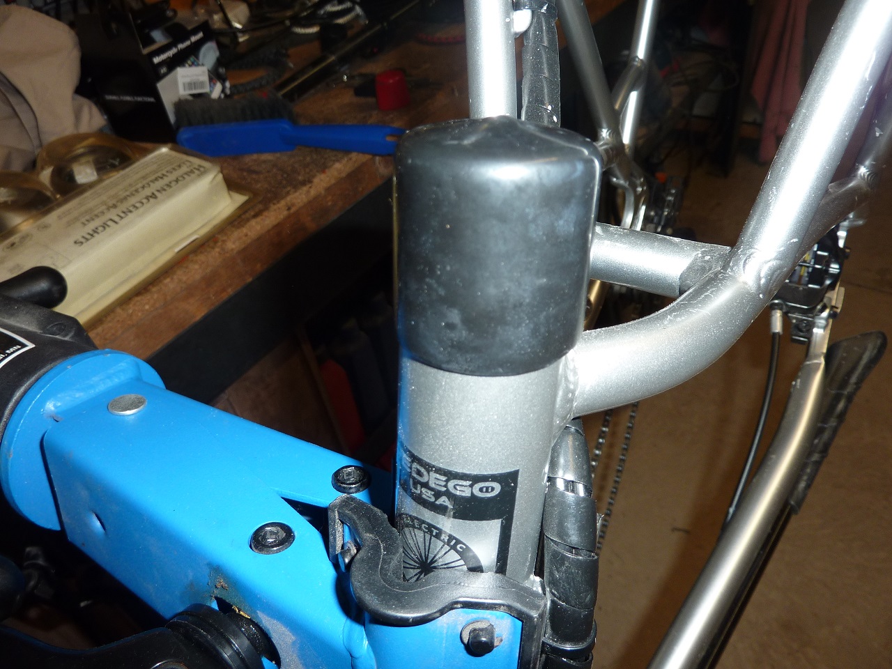

The Kinekt cover wrap is indeed spendy for what you get but it's more durable than it looks. It isn't waterproof but it is treated with something that makes water bead up rather than sink in. Since I rarely ride in rain heavy enough to penetrate the cover, it really isn't a problem. When transporting the bike, I always remove the seat post to avoid water getting into the seat tube. It's also a good idea to prevent theft. I cover the open seat tube with a simple, tight fitting vinyl cap that keeps out dust, debris and moisture:
View attachment 88857 View attachment 88858
Great ideas. Probably has PTFE coating. I may simply try one. I like the cap idea.

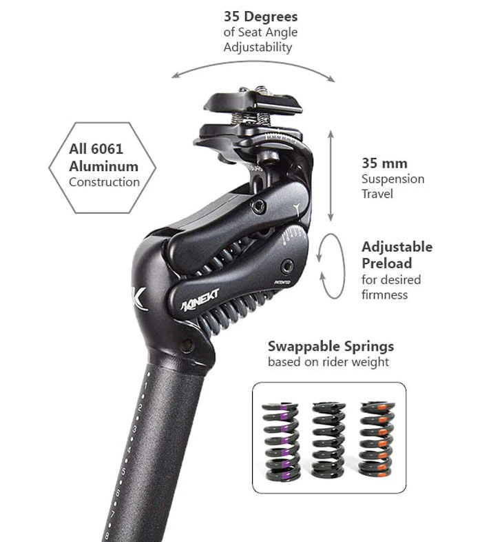

Dead on about that Kinekt - once I ordered and set up the (sorta) right springs/ tension. So many, like you with a cycle background have the same praise. It's why I got one. It's all you've pros said.
At 138lbs, I'm switching out one 100 - 150lb for a 150 - 200lb class (I have the full set), finding it presently a bit too flaccid.

I put a Kinekt and Baramind City on my Trek Allant 9.9S right after I bought it in early 2020. It took a stiff, hard riding bike and, along with a pair of Schwalbe Hurricanes inflated to 35psi, made it completely comfortable for my 70 year old bones. I also made some substantial mods to the drive train to get top performance out of it. I have almost 3,000 miles on the bike, ride it hard and fast and find it very comfortable to ride with the mods.
I weigh 210 lbs and use the orange springs. It is important to set the spring preload screw such that there is no sag when you sit carefully on the saddle. This limits the travel but takes the weird bounce out of it when pedaling hard and give you compliance when you need it. Also the SQ labs 702 grips help with cushioning impact and vibration to the hands and wrists.
Pouring over these older posts, I noticed you'd said "orange springs". Likely you meant 'red' as Cirrus has only Red, Yellow, Purple and Black springs (Correction: but they sure do look orange to me too). There's 60 - 80lbs difference and only on the XR version. Orange/ orange puts you in the 230 - 320lbs range, the mean being 275lbs
(65lbs to your high side bias).
Black/ yellow lands you squarely between 200 and 240lbs (190 - 230lbs for e-bike) where your mean is 220lbs for gravel and exactly 210lbs for e-bikes.
If your springs are at the end of their range, you'll have very little adjustment variation available no matter what you do.
Adjusting tension light enough to enjoy the KINEKT is not possible as the weight's out of the spectrum allowed.
You'll end up going waaaaay too stiff just to stop the excessive jounce and unless you are completely loose. There is very little suspension available, as you are out of your permissible weight range.
The closer you are to that mean, the longer the range available you can 'properly' use.
The correct tension adjustment, again, should fall near the middle.
That's the spot that massively reduces road chatter, absorbs bumps in the mid-range and will not bottom out on a heavy hit.
Too stiff only gives you 'bottom out' protection.
If you like that KINEKT now, there's a whole hidden world you'll find when you match those springs as close to your weight as possible.
There's no other way to get it (See: KINEKT Spring weight application chart).
Anticipate the % of bias will dictate the range available with those particular springs.
If you calculate 20% > heavy bias, anticipate -20% of the suspension range unavailable, and so on.
That's my take!

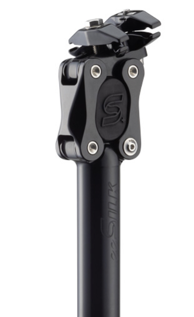

I had the Thudbuster ST on my Riese and Müller Nevo3 GT Vario GX and found it worked OK, apart from one big problem. The saddle clamp is from side to side and I could just not get this tight enough to stop the nose of the saddle rising up. Took the fastenings out and tried a straight through stainless steel bolt and nut to no avail as it still kept moving up.
Now I’m trying the Cane Creek eeSilk+, which has a different saddle fitting. This time, the bolts are top to bottom and so far, no upward movement of the nose of the saddle.
Apart from the saddle fitting, the other difference is the length of travel. The Thudbuster is 50mm and the eeSilk is 35mm. But don’t know if I’m going to notice the difference.
So far, it is going well.
I had the Thudbuster ST on my Riese and Müller Nevo3 GT Vario GX and found it worked OK, apart from one big problem. The saddle clamp is from side to side and I could just not get this tight enough to stop the node of the saddle rising up. Took the fastenings out and tried a straight through stainless steel bolt and nut to no avail as it still kept moving up.

Yes. The top and bottom clamping arrangement appears to be more robust.
Plus on the Thudbuster, it was a right pain fitting or adjusting the saddle as when you loosened the bolt, the fittings always came apart as the bolt was too short.
The eeSilk+ was way much easier to fit and adjust.

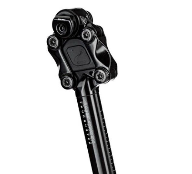

Glad I saw this. The Gen 4 Thudbuster (your photo) came stock on my Tern GSD Gen 2. Recently, about a year into riding, it lost the ability to keep the saddle clamped. Big bumps would lodge it loose. Specs are 16NM and my Park Tool torque wrench goes up to 15NM. Pretty sure I had overtightened, as I had been swapping saddles with some frequency in the last couple of months and figured I had stripped something in the process. I swapped the Gen 4 seatpost on the GSD with my Gen 3 Thudbuster ST on my Tern Vektron (same diameter 30.9). The Gen 3 has a different seatpost clamp mechanism - the one with a single hex screw and a wheel/dial screw to adjust tilt. Anyway, the older Gen 3 is still holding up fine but my Gen 4 also wouldn't keep the saddle nose on my Vektron from tipping up - the seat tube angle is less slack or more upright on the Vektron so I thought there would be less pressure on the clamp. I also think the Gen 3 makes it much easier to adjust tilt. And yesterday, before I saw this post, I ordered a replacement clamp kit for the Gen 4 from Cane Creek. Maybe I should have just ditched it for an alternative. Sounds like the Gen 4 clamp mechanism has some issues.
