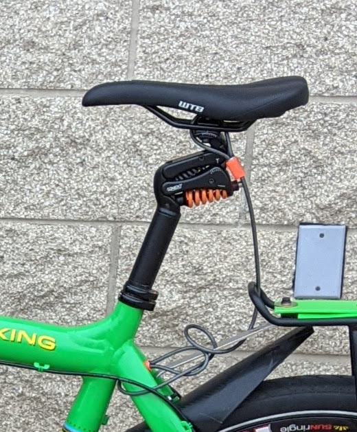

I commented in this thread early in my use of the Kinekt, and since the thread is now undead, wanted to update accordingly.
I am building a bike right now - the same type as the one that has my Kinekt on it - and after over a year of daily use decided against equipping it with a Kinekt again. The reason is - and as far as riding style goes I am a pedaler, not a throttler - at high cadence, the Kinekt will pogo on me. The Thudbuster LT does not do that.
The Kinekt is a great product. Very well made. And it is correctly described by the factory as being different from other suspension posts in that it provides more of a bump 'isolation' for the rider rather than a suspension cushion. Its response is so fast it just makes bumps go away. BUT when my legs are windmilling at about 60+ rpms, I start bouncing up and down unless i make a conscious effort to use my leg muscles to support my body and dampen out the post's tendency to do this. That ain't right.
Worth noting: I am 250 lbs and I am riding on the no-longer-sold Kinekt XL variant. Note it uses the gray small and orange large springs. Someone above noted above that orange was not available and this is incorrect. Orange was available after consultation with Kinekt as an option (I have spoken to them a number of times), and on the XL models which had I think a 250-320 lb weight range, orange was the default shipped with the post. Nowadays, Kinekt uses the same post and provides its entire weight range with spring changes... the XL I have was more heavily built than the regular posts.
For my 250 lb self, I take the Thud LT and add in the firmest of the optional elastomers. Its fine under all pedaling circumstances. I have one of the new-design LT's on my Surly and I know from that it has no quirks.

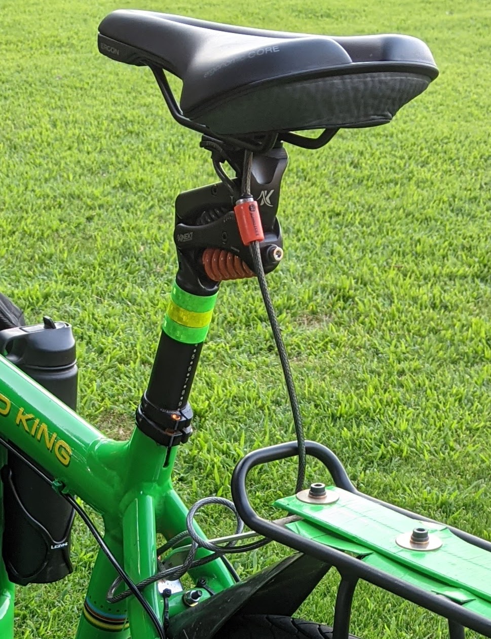

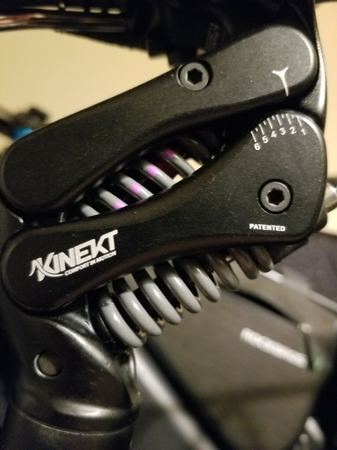

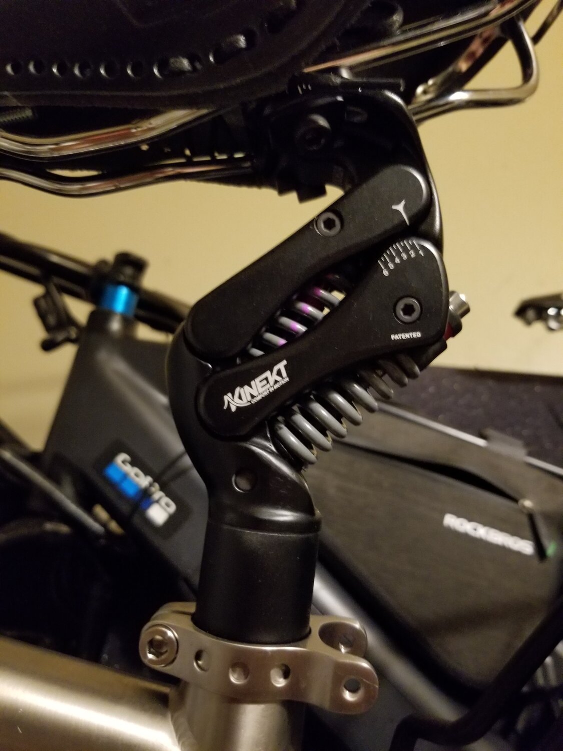

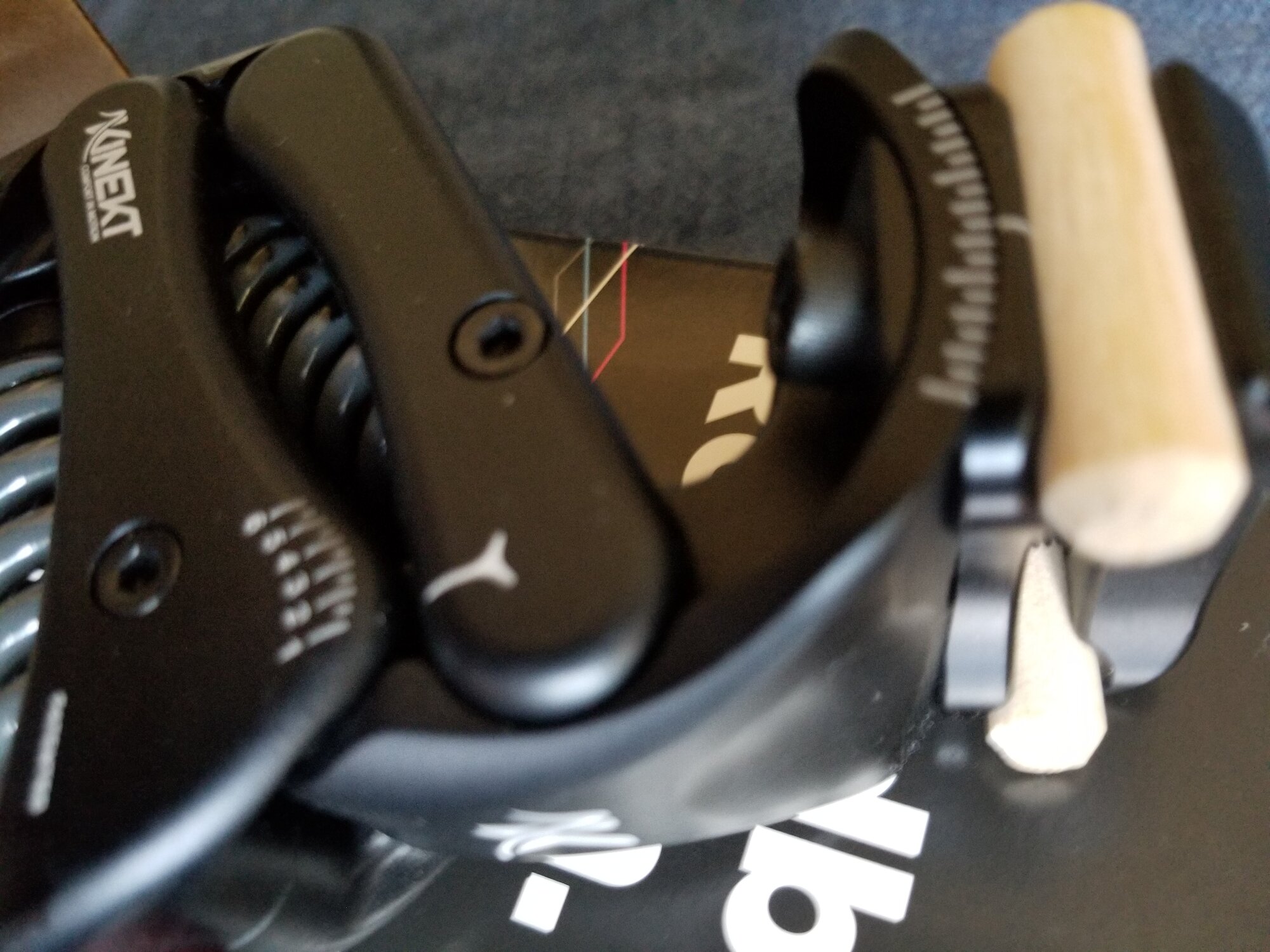

Here are a couple of pics of the installed Kinekt post. They show the post and a couple of related things that have been brought up in the thread over time.
First, people were talking about the post sliding down.
My solution to this across all my bikes nowadays is to use a double post clamp. These are primarily marketed to carbon fiber seatpost owners, but they put enough grip on any post so you don't have to go and do something extreme like put 18 Nm on a poor little M5 or M6 bolt. My original need on a different bike was to overcome a frame quirk where it was a skootch larger than the advertised diameter. About half a millimeter. I needed precision calipers to nail down the culprit. Everything fit, but ride it to work and the post slid down no matter what. The dual clamp ended my suffering so well I made them the default on every bike I build. The one shown is the $40 KCNC, which was all I could find at the time. Waiting for install now is a Silverock that cost half that and is lower-profile to boot. If buying one of these, make sure it is a dual clamp that clamps the frame with one bolt and the post with another. Double-bolt clamps don't count if they are clamping just the frame.
Next is theft-proofing. The double clamp is a bit of a deterrent, but something I have been using for a lot longer is a seat leash. A short cable that is not going to stop a determined thief, but it ends the possibility of a snatch-and-grab. One end of the cable is noosed around the root of the seatstays. The other end is installed inside connection between the seat rails and the seatpost. You have to either cut the cable so you can then unbolt the seatpost, or you have to unbolt the seat from the seatpost so you can now unbolt the seatpost. this seat leash is actually sold by Kryptonite but they do not advertise it for its purpose, for some reason. You have to know why they sell a short, small 5mm cable like this.
I noticed that your preload setting looks to be around 2. Given your weight I would think a preload closer to 3 or even 3.5 would reduce or even eliminate that higher cadence bob.
As far as securing your investment, I use Helox bolt inserts on my seat post, seat clamp, stem at both the steerer tube and the handlebar. I also have hexlox axles and skewers. These prevent theft by filling the hex hole in the bolt heads with magnetic inserts that can only be removed with the accompanying keyed tool.
View attachment 139193 View attachment 139194

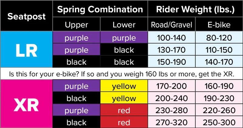

He's running Black/ Orange springs. That's 310 - 360lbs Class on bicycles. 290 - 340lbs Class e-bike.

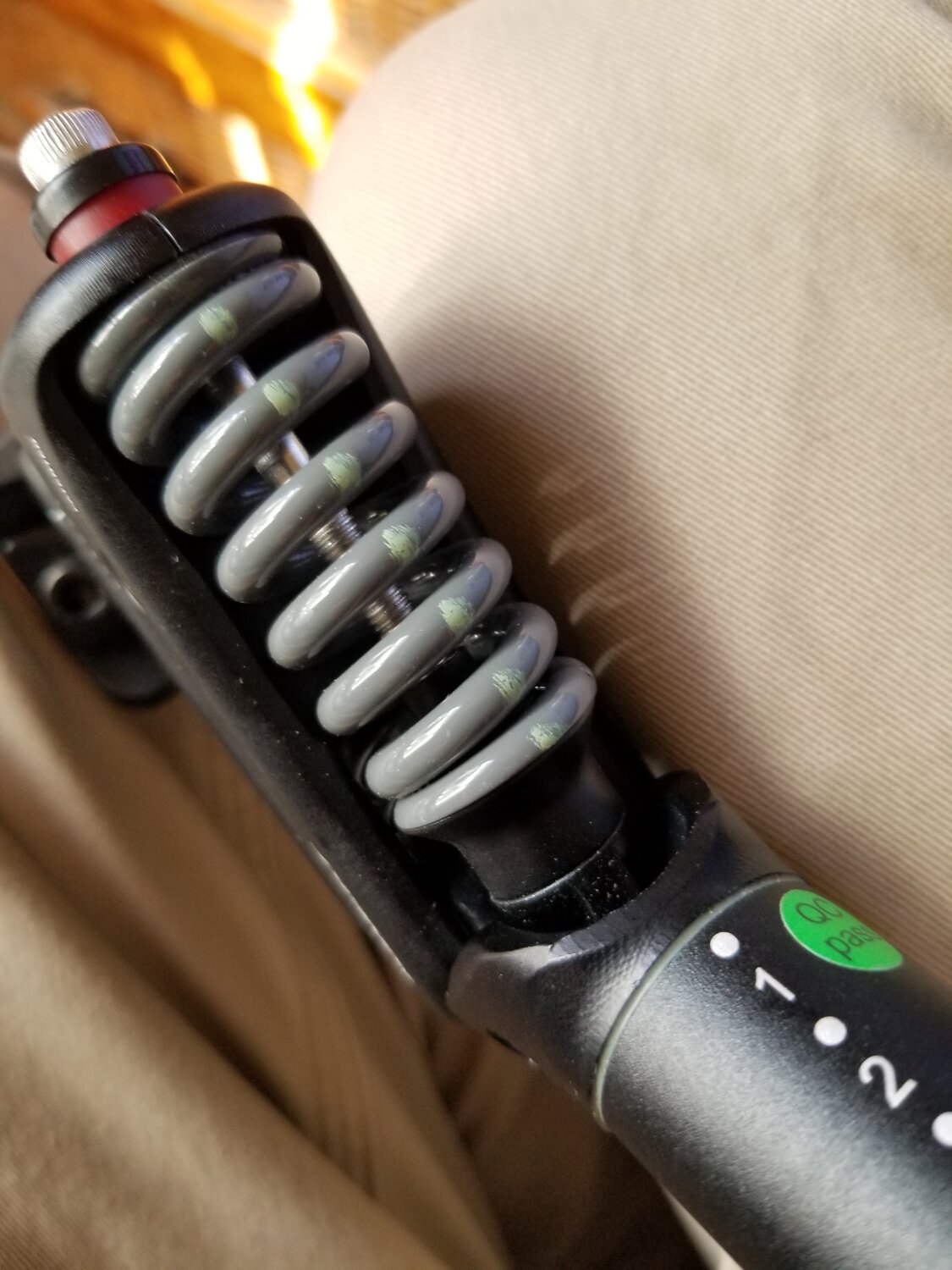

One can tighten the springs (less compliant), somewhat altering the saddle angle and decreasing travel. Or loosen (more compliant) the springs creating maximum travel etc. , changing the attitude in reverse.
Until my 'spring range' was correct vis a vis my weight, it was impossible to actually feel the device.
While settings are purely preferential, 'Purple/ Red' is factory recommended to suit "250lbs". Even running as compliant as possible, Black/ Orange springs must be stiff as a board. 2 degrees (load) is actually very stiff - on top of 'way beyond heavy' springs (with a 335lb mean).
Fully one-third out of range even at the loosest setting for a 250lb rider. No possible way to tune them correctly exists.
If you are close enough, dialing in the springs to your weight, your static point will be 1.5 -- 2 on that dial to get KINEKT's best.
Although once desired tension is set no need to change it and I left it the same for over a year, the handy dandy Control Knob made changing the tension anytime/ anywhere easy. That let me get a feel for the range in a few days, unlike the PIA hex-head type.

Actually, no thats not correct. At least not for my post, which is a variant no longer sold by Kinekt.
If you look at the pics of my post and compare it to the other pics of current production LR / XR, you can see mine has a much larger lower spring, where the modern version has two springs of the same diameter. The XL2 version didn't stop there as its armature was different too. The orange spring on it was the default and the only one available, with a range that started at 250 lbs and topped out at I think 320 or 330 lbs. Nowadays, Kinekt has an approach that does everything with a single product running across the entire weight range and all adjustment is done with spring choice. So its easy to see why they evolved the design (the XL2 was also a more expensive option on an already expensive product).
I got the lowdown from a Kinekt engineer as I called them up and was looking for specific details on construction and later adjustment. At the time, their standard line maxed out at 260 lbs. I weighed that much and was concerned about possibly either going up or down and being right on the bubble. Kinekt recommended an XL2 model, but told me if I lost weight, I would be too light for that spring setup, and there was no way to tune it down with a lighter spring in that larger size. In the end, I seem to have wound up stuck right at 250 so changing body weight never became anything I had to worry about.
For the seatpost, at least.

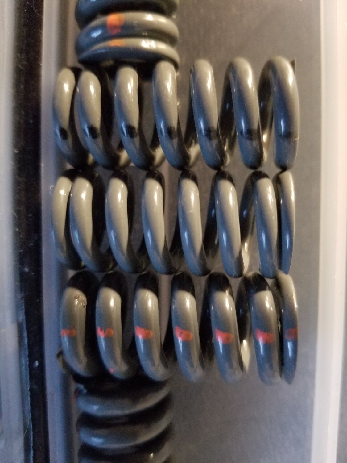

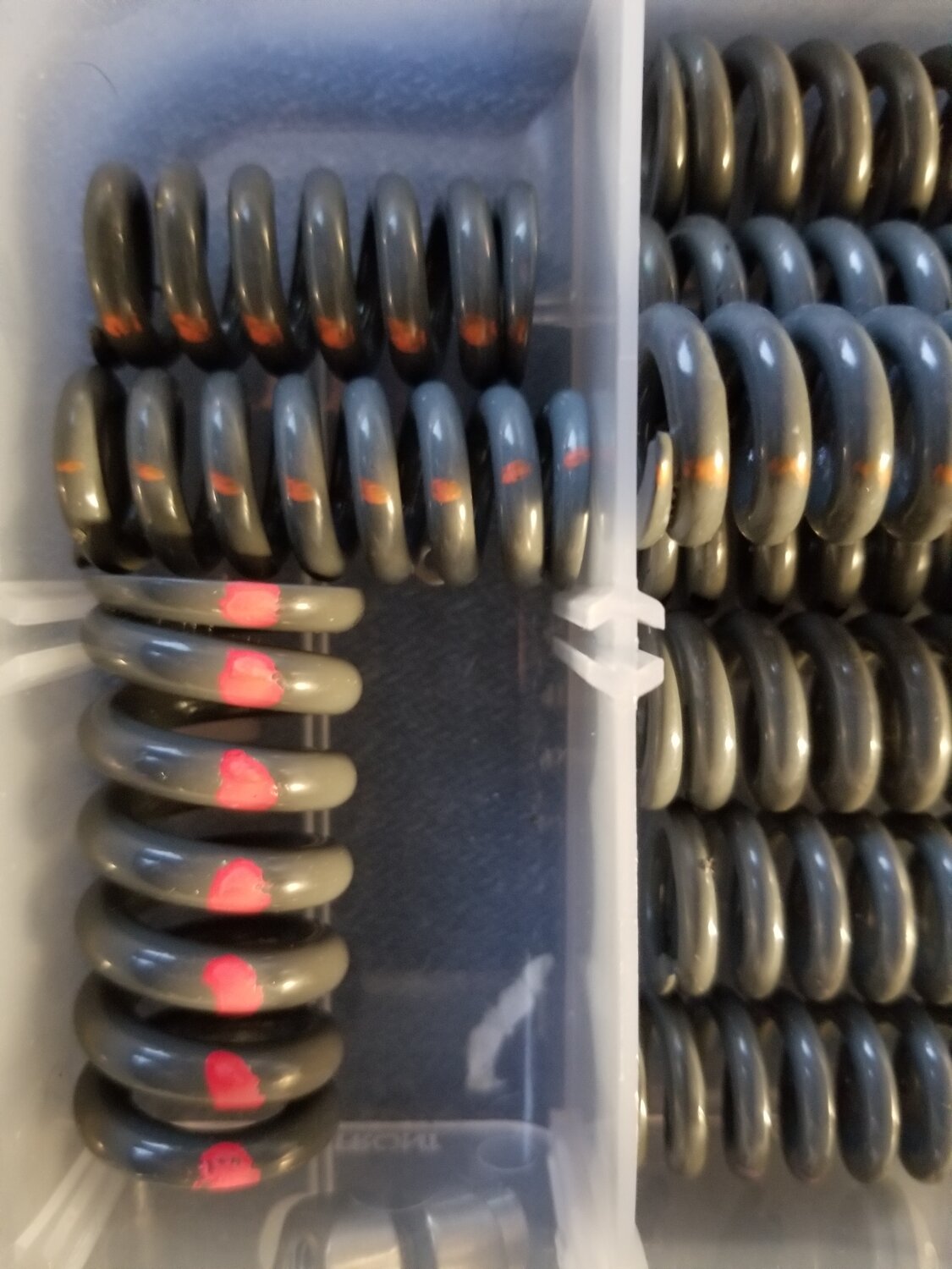

KINEKT says: "PLEASE NOTE: We use 3 different spring lengths. The UPPER springs are all the same size ( 1.5" ). The LOWER springs are different depending on your model (All Bodyfloat, 2.1 or LR models use 1.75" springs). ( All XL2 and XR models use the 2" springs). .
Top is the UPPER. Middle, LR and bottom XR.
Diameter, the result of thicker or thinner wire varies with spring 'color'.
In person, the Orange upper is substantially larger diameter wire, but nowhere near as large as the XR's lower spring of the same color/ - as you can see.

My orange /= yours and /= current production springs. You can see that most obviously by just looking at the coloration. And your weight range of 310-to-360 bike / 290-340 ebike is completely wrong. Explaining why that is was most of the reason I did all the storytelling above. Back when the XL2 was on sale, there was no such thing as bike/ebike ratings, and even so, the range is completely different as noted. I'm certain you are correct when speaking on the Kinekt products that are on the market presently, but that info doesn't directly translate to my older XL2.
Kinekt has scrubbed all mention of the XL2 post itself off of the USA site, but I managed to find the Italian Kinekt site, which still lists them.
Rated rider weight is 105 kg to 140 kg. In Imperialist units that is 231 lbs to 309. I am guessing it was marketed then, at 230-310 lbs. I remember 250 but there's no telling whether they changed it or my memory is imperfect (surely not!).
EDIT: I managed to track down the Amazon page for the XL2 via its reviews. 240-320 lbs for USA market.
