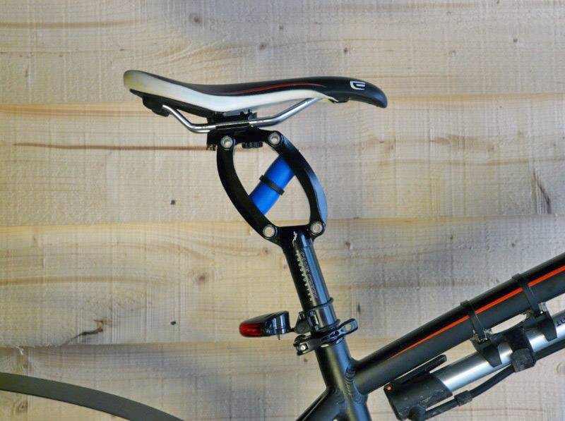

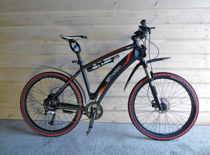

I was annoyed when I realised that Thudbuster didn't make seat posts in a diameter and length to suit my Emotion Neo Volt Sport. Then I realised that I already had a 27.2mm diameter Thudbuster on an old bike I no longer use. Perhaps the stem on this old Thudbuster would slide inside the 31.6mm seat post on my Neo Volt Sport? The answer is not quite. But Gary at Alloy Racing Fabrications in Perth machined both pieces to make them fit and I glued them together with epoxy. The result was very secure but a little messy, because I forgot to drill an air release hole and trapped air pumped out some of the glue during assembly. I drilled the hole and cleaned up what I could. Better late than never.

And here we have it, one Thudbuster LT. :)
Other than just sitting on the bike I haven't tried it out yet. The roads and weather conditions are too treacherous here at the moment for me to want to risk going out on the bike. I'll write a short review over the next coming month, once I've being able to try it properly.
But in the mean time I have to say that it is superb quality, very easy to fit and just sitting on the bike without going anywhere, I can already see that it's going to work. As I had suspected, it didn't come with the cover that it comes with when ordering direct.
I have ridden 2000 miles on my thudbuster, and it has saved my ass on many a long ride. I have the same bike as you dude!
Nice bike! When I test-rode a similar model it attracted lots of positive attention!

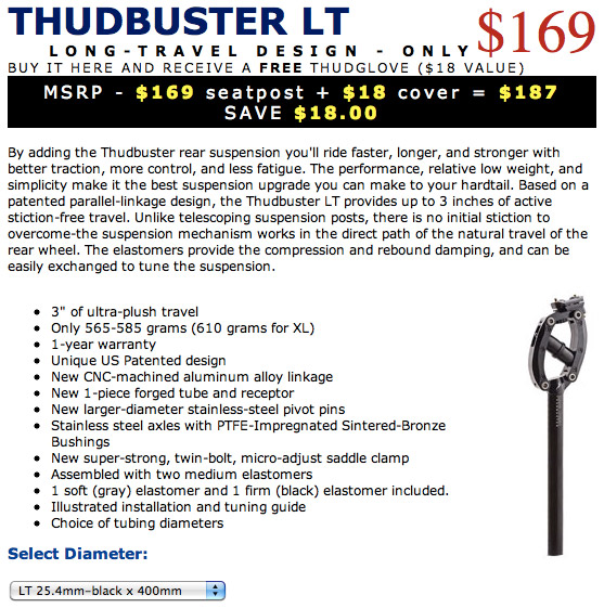

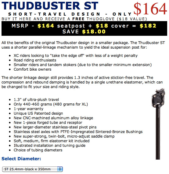

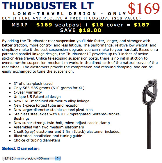

Hey guys! I've only ever used the LT (long through or long travel) Thudbuster but I really liked it. The obvious difference is travel range and it seems like the LT is setup for mountain biking and other abrasive riding conditions while the ST is more for road biking. Both versions include rubber inserts that change the stiffness and both versions come in multiple tube diameters to fit different frame sizes.
I've attached screenshots from the official Thudbuster website below for reference on the two. Sorry to hear about the higher prices in Europe EddieJ, I know that shipping also kind of spoils ordering from overseas. The irony is that most of these components are made from metals mined or scrapped in North America which are then shipped to China where they are machined and then shipped back to America before finally being shipped to Europe for you.

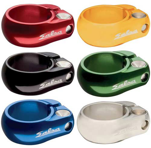

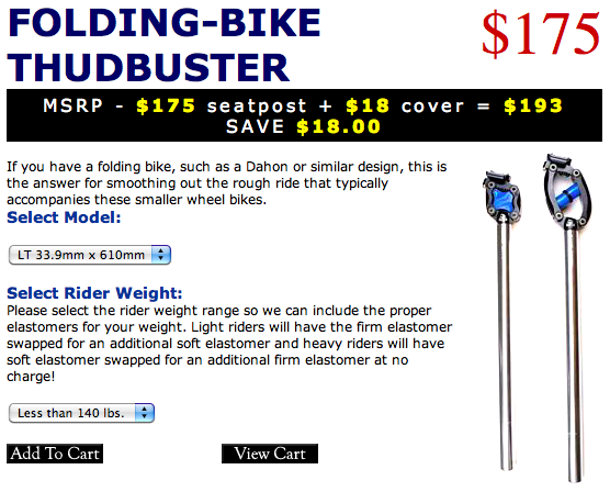

I noticed that Thudbusters are also now available in much longer sizes for folding bikes! This is awesome because most folders don't have suspension. This is part of the reason I liked the E-Joe Epik SE so much... in any case, be sure to get something like the Liplok from Salsa that helps to secure the seat post more tightly so it doesn't slide down as you bump up and down. That happened all the time with my City Commuter (like daily) no matter how hard I tried to tighten the quick release lever. The Lip lock fixed that :)

Hey Court,
regarding the liplock clamp. How/where does this thing go? Do you clamp it on the seatpost right above the seat tube clamp or does it replace the seat tube clamp?
Thanks....JD
