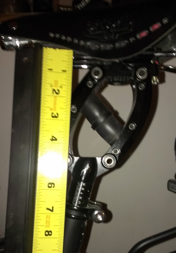

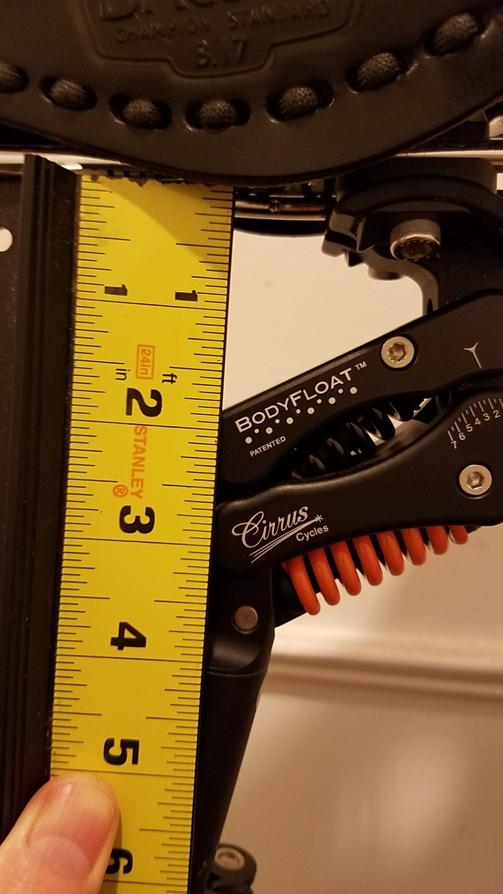

I've never ridden the ST. I've had a LT and the Kinekt (formerly BodyFloat) for many years. The LT needs a lot of post space to fit and work. If you're a shorter rider make sure you have the space for it to fit.
TB/LT measured from the saddle rails.

The Kinekt is smaller.
The LT works, but the Kinekt works much better.
