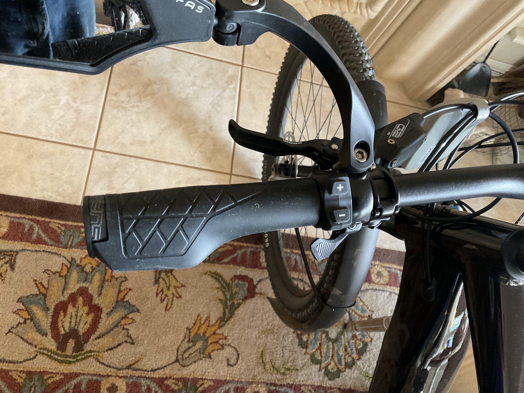

I’ve only made it to page 7 here, and I don’t want to make a hasty judgement, but can we get “mature” (as in adult, sensible…) back in the title of this thread?
And veering dangerously back on topic, what are the prefered methods of addressing numbness in hands on longer rides? I’ve changed to wider, more supportive grips (helped some), started wearing gloves with some palm padding, and until now (well an hour ago when I started reading this wandering thread), I was thinking about raising the handle bar height 1-2” and maybe changing the bars to bring the grips back a bit.
I’ve considered innerbar ends, but not sure how they would fit with everything else on the bars. Anyone got pics of them on a Specialized bike? Other thoughts from those who have addressed this issue?

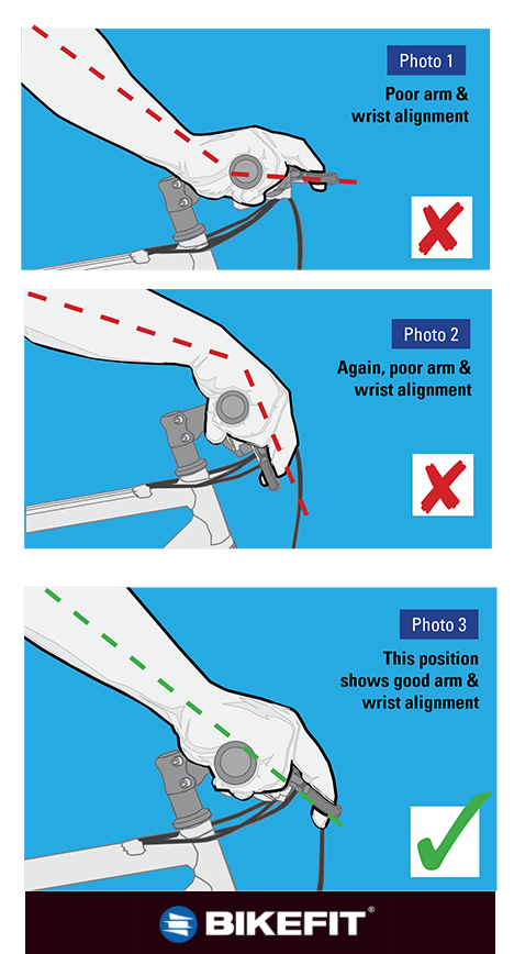

Are your wrists in a neutral position?
I’m a complete rookie so I really don’t know. Is there a diagram somewhere on proper position? My wrists are bent slightly with my hands bent back (up) a bit, and I’m putting a lot of pressure on my hands (palms mainly) I believe because my bars are too low, but lets not get into all that.
Its a new Spec Tero BTW. I’ve been mostly desert riding which involves some easy dirt/gravel cruising, mostly bad roads, and torn up 4x4 tracks (with very deep, narrow wheel ruts/bike traps), with a lot of big rocks to dodge, sometimes constantly, and a lot of washes to cross, which are fun, but usually involve some sudden drops before an immediate climb out the other side. I could just cruise around on easy roads for less than 10 miles and experience no ill efffects but I’m easily bored and the trails call. So my hands are usually numb around mile seven or so.

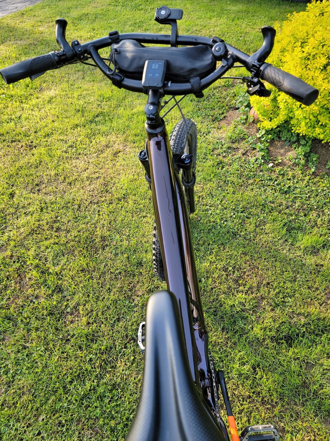

I found this pic of the same bike with innerbar ends on a Johnson H bar but I also have a mirror on the left side which I really like. So adding the innerbar ends would really start to clutter the cockpit (still getting used to calling it that but we must have our nomenclature). But many times while riding I find myself thinking they would be helpful.

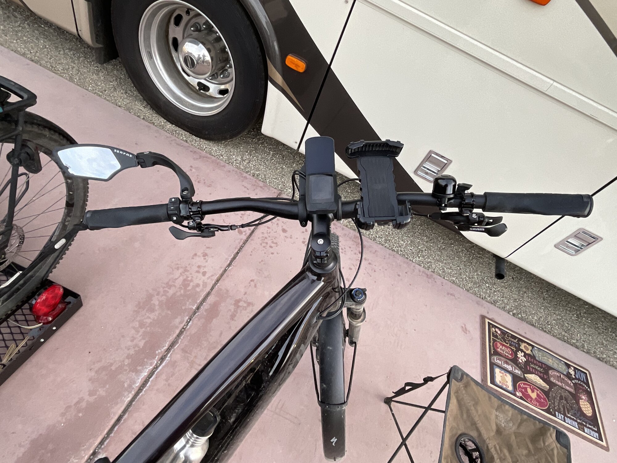

This is mine - not as sexy but not as cluttered either. On the bike above there is no control for a dropper because he changed it out to a Redshift suspension post, but the control shared the same mount as the brake lever so that didn’t free any space. I tried all three possibilities for the mirror and the one pictured works best for me. But I’m open to suggestions.

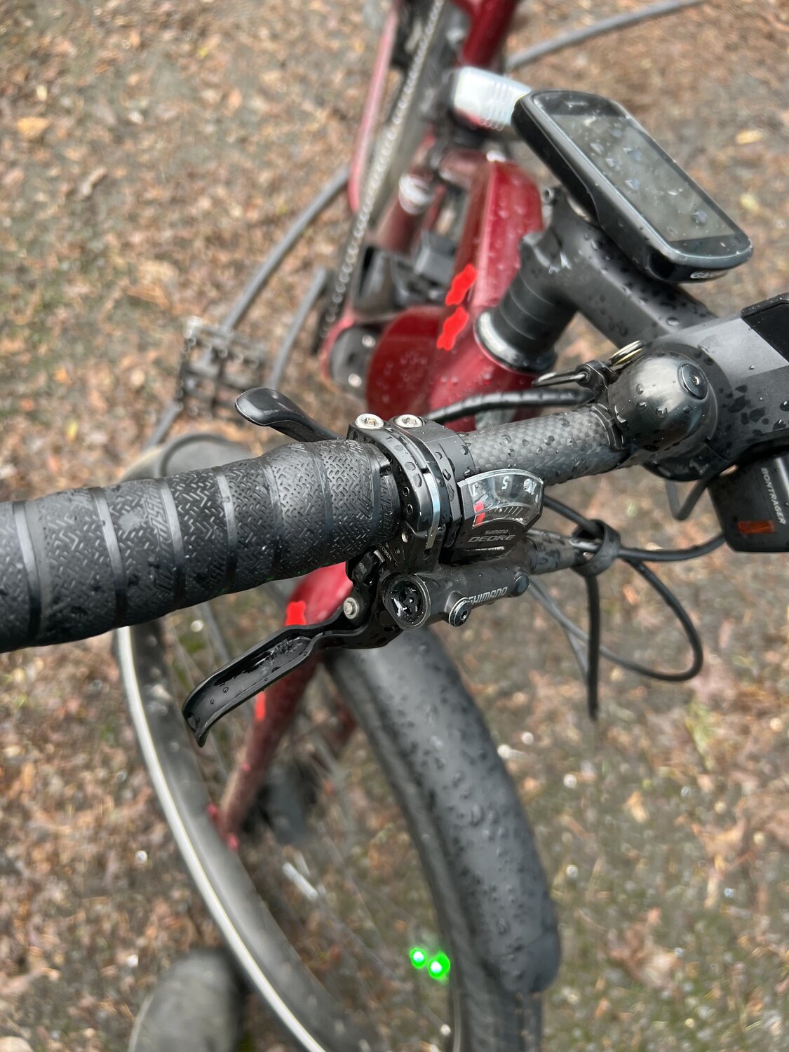

Getting your hands so they are in line with your forearm will probably help. The hand bent back is not a good thing. I can't take a picture of my grips because my bike is stored for the winter, but there are grips that will give you a much flatter contact surface and you can turn the grip to better align your hand with your forearm.
Added: if you ride with a death grip, that won't help either.

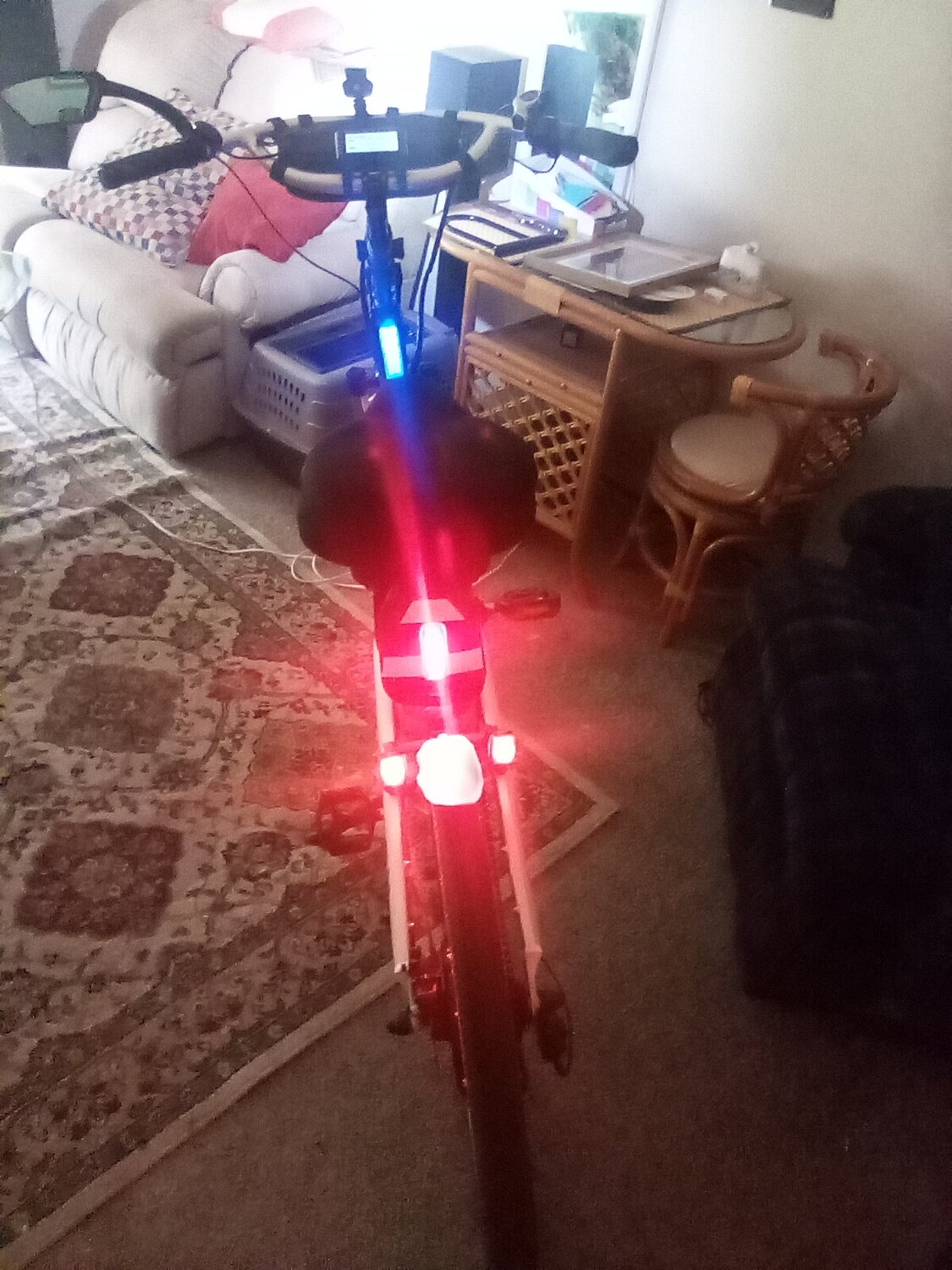

The Jones bar is the solution for me. I raised the bars and have them swept back to me. My seat is the right height so I sit and ride like on a motorcycle. Along with a Cloud 9 seat, Schwalbe balloon Big Ben tires, suspension seat post, and front suspension forks, this bike rides very smooth. I do 25-30 miles every other day in the summer no problem. I'm 73.

yes I see so many people with their levers level I usually set them so my finger rests on the brake lever without bending.
I just lowered mine a bit more and with rotating the grips a bit more I have a more or less neutral wrist position. Heading out for 10-15 miles of new desert trails today. Hopefully it will help.
Exactly what I was looking for - I was definitely in the #1 position - now I’m in the neighborhood of #3. I like the H-bar but want to try to get it right without making a major change yet. I only have 140 miles on the bike so I’m not ready to abandon the stock bars yet.
