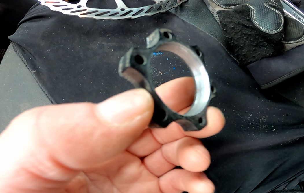

This is the part that stripped, I pretty sure it's a bad idea to mix aluminium and steel anyway.

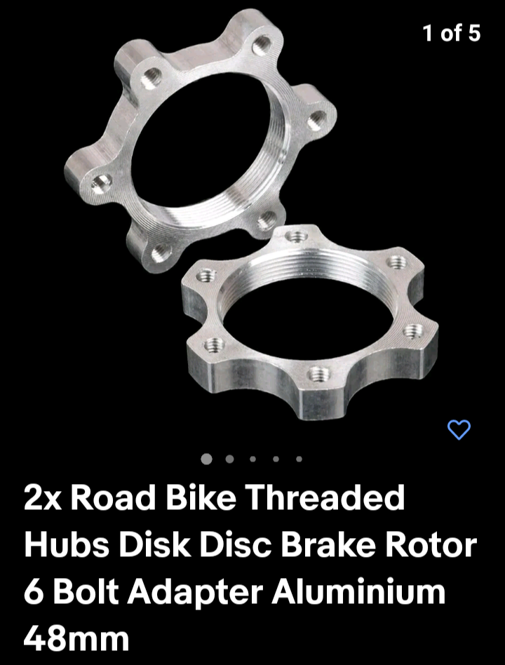

Those adapters are meant to do a disk conversion on a flip-flop hub. Thats a pretty esoteric need, which has been exploited by Far Eastern cheap hub builders to serve a very different purpose.
I know its easy for me to spend your money, but I would run in the other direction of a hub like that. Its not about putting a 203 on it. Its just inherently badbadbad and you found out why the hard way.

I said it was my fault, because I've ridden the bike in salt water, and it's unlikely power washing got the salt back out.
I guess it eroded the alloy thread, you live and learn.

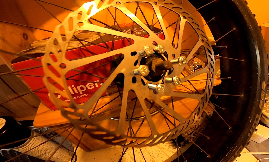

I won't show you my botch fix to ride the bike the next day
OK I will, but dont judge, I only had the next day to ride and wasnt going to get the parts that quick.
I drilled right through the hub flange with six long bolts to hold it all together, worked very well.
Thats going nowhere.
bit out of focus, the thread was completely gone, I had no idea it was a separate piece., what a ludicrously fragile bit of alloy to take full braking power from
my weight and an ebike, quite clearly the force is in the wrong direction for the strength a thread supplies, it just kept overtightening it till it stripped.

It wasn't the bolts that failed it was a hub that didn't have integral disc mount and a threaded adapter added..
The adapter mounting threads failed.
