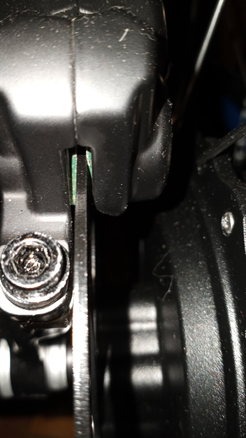

This is not good, and its my fault
Seriously on brakes
I installed new race pads but I don't have the tool to align the caliper.
Now the rear brake is dragging wearing down my rotor. I will buy the tool if I know what it is called.
Rome, you need no tool.
I assume you installed the new pads properly.
First of all, I think you have squeezed the brake lever when the wheel was off the bike. Remove the wheel again. Take a tire lever, insert it between the brake pads, and move the lever the way to push the brake pistons back into their proper idle position. It should leave a gap between the brake pads significantly wider than the thickness of the brake rotor.
Replace the wheel. Using a hex wrench, loosen two bolts that hold the brake calibers onto the frame (loosen but do not remove them). Now, squeeze the respective brake lever strongly and fasten the caliper bolts. Release the brake lever.
Hydraulic brake calipers are self-centering.

@Rome ,.. install your wheel and spin it and watch (and listen to) the brake disk rotate through the brake pads.
A warped disk is easy to see and hear.

What I explained to Romeo were the basics of the hydraulic brake caliper maintenance.

Rotors are straight. I text my Bulls tech
How to align/reset to factory specs. My calipers. He said to loosen caliper bolts and stick .5mm spacer on 2 side sandwich the rotor hold brake lever for 5 seconds. Tourqe bolts when you satisfied with tightness. Release brake pressure .
There you have that's how I set both my bike.
Basically what you were told.
I've found the 0.05mm spacers to not be totally unnecessary and be a pain in the ass.
But whatever makes you happy.
