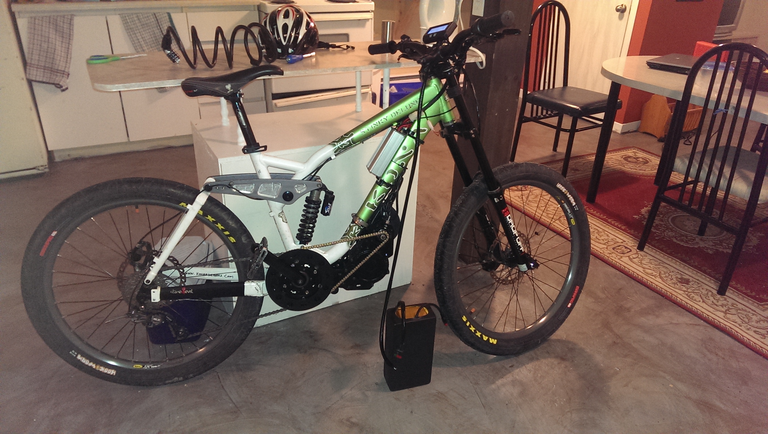

Here's Dennis P's bike with my kit on it:

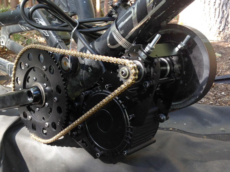

Here's a tricky installation. A new Kona Stinky with a 73mm BB that has a curving front downtube. Most mid drives won't fit a frame like this. I make a special extended lower mount bracket that fits the curving frame tubes.
