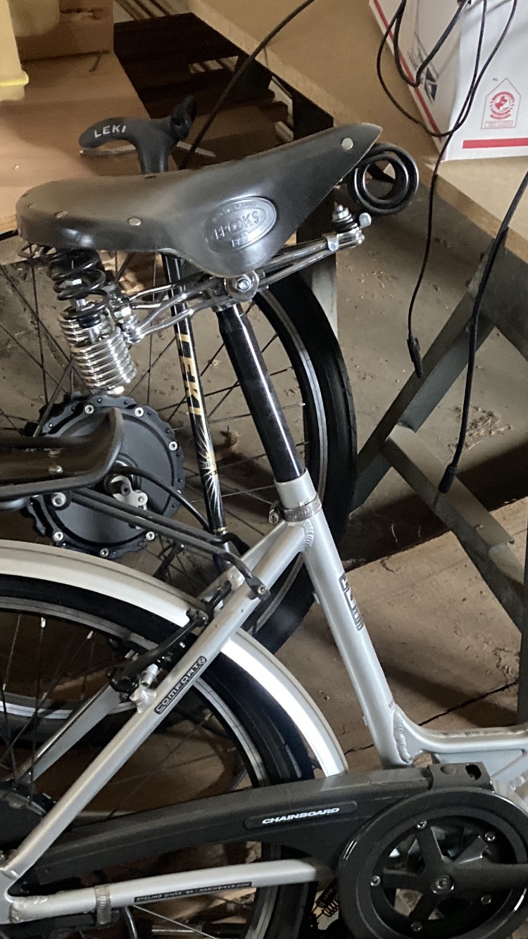

I do not say the Thudbuster is a bad thing! Only with the Redshift you do a single turn with the adjuster barrel and forget about the whole thing 😊
For anyone interested:
There is a little design glitch of the RedShift (which has nothing to do with the seat-post performance as it is just cosmetic). There is so-called "fender" that protects the internals of the seat-post against possible soiling. That fender is held in place by a thin piece of rubber band, and magnetically. That piece is known to fall off when the rubber band is broken. I recommend to immediately secure the fender in place with a piece of a Velcro tape just after the saddle setup. (The part is not necessary at all, it is just good looking).
