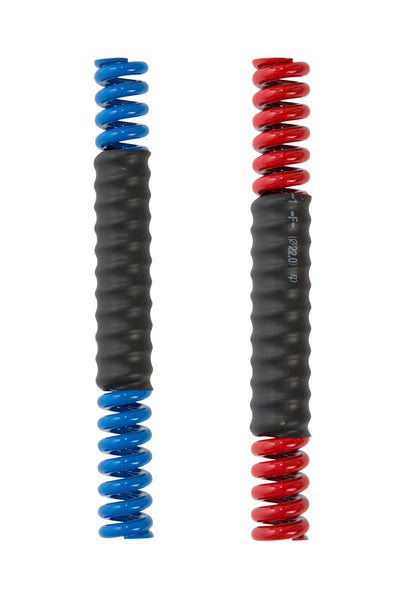

I'm sure the Redshift is nice/better... but before you shelf the NCX understand that I believe the spring it comes with has a much higher rating then stated. By specs the medium spring should be perfect for my weight but I found the Soft much more to my liking and is no where near bottoming_out even though I'm 15lbs over its rating.
Aftermarket spring kit for NCX Seat Post
Soft Blue spring is rated for 140lbs- or less
Hard Red spring is rated for 180lbs+ or more
*medium springs are factory installed on all post sold by SR Suntour North America

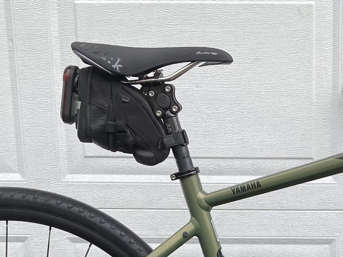

I use a Cane Creek eeSILK+ Carbon post and Maxxis Receptor 40mm tires at 45 psi along with a Titanium railed Fizik saddle on my Cross Core. The combination provides a very nice ride.
We ride a combination of surfaces ranging from smooth pavement to fairly rough gravel and dirt roads.
I never notice any bobbing from the seat post, but I do know that it greatly reduces the shock from bigger hits. It has 35 mm of travel.
I wasn’t looking for a plush ride. I wanted to limit shock to my already damaged spine without reducing pedaling efficiency and without adding a lot of weight. Between the supple tires, resilient seat rails and Carbon suspension post, I get to have an efficient and non-jarring ride without any real weight penalty. I have no complaints. I didn’t want a seat post that felt like a pogo stick.
I also go out of saddle on the really rough stuff.

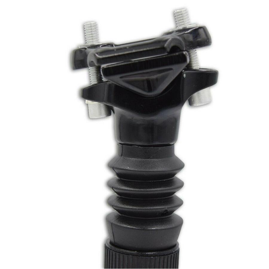

There is a little design glitch of the RedShift (which has nothing to do with the seat-post performance as it is just cosmetic). There is so-called "fender" that protects the internals of the seat-post against possible soiling. That fender is held in place by a thin piece of rubber band, and magnetically. That piece is known to fall off when the rubber band is broken. I recommend to immediately secure the fender in place with a piece of a Velcro tape just after the saddle setup. (The part is not necessary at all, it is just good looking).
I just left the damn fender off when I installed my Redshift. CN
