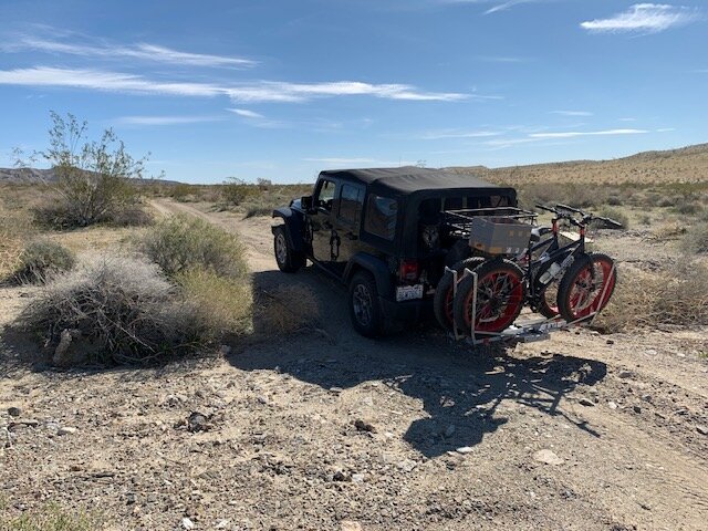

Just to add how strong the 1Up racks are we have a dual bike unit that carries two cheap & heavy Fat Tire bikes on the back of a Jeep then head off on desert trails. A great bike rack and I hope that doesn't change based on what Lumos wrote in post#29.

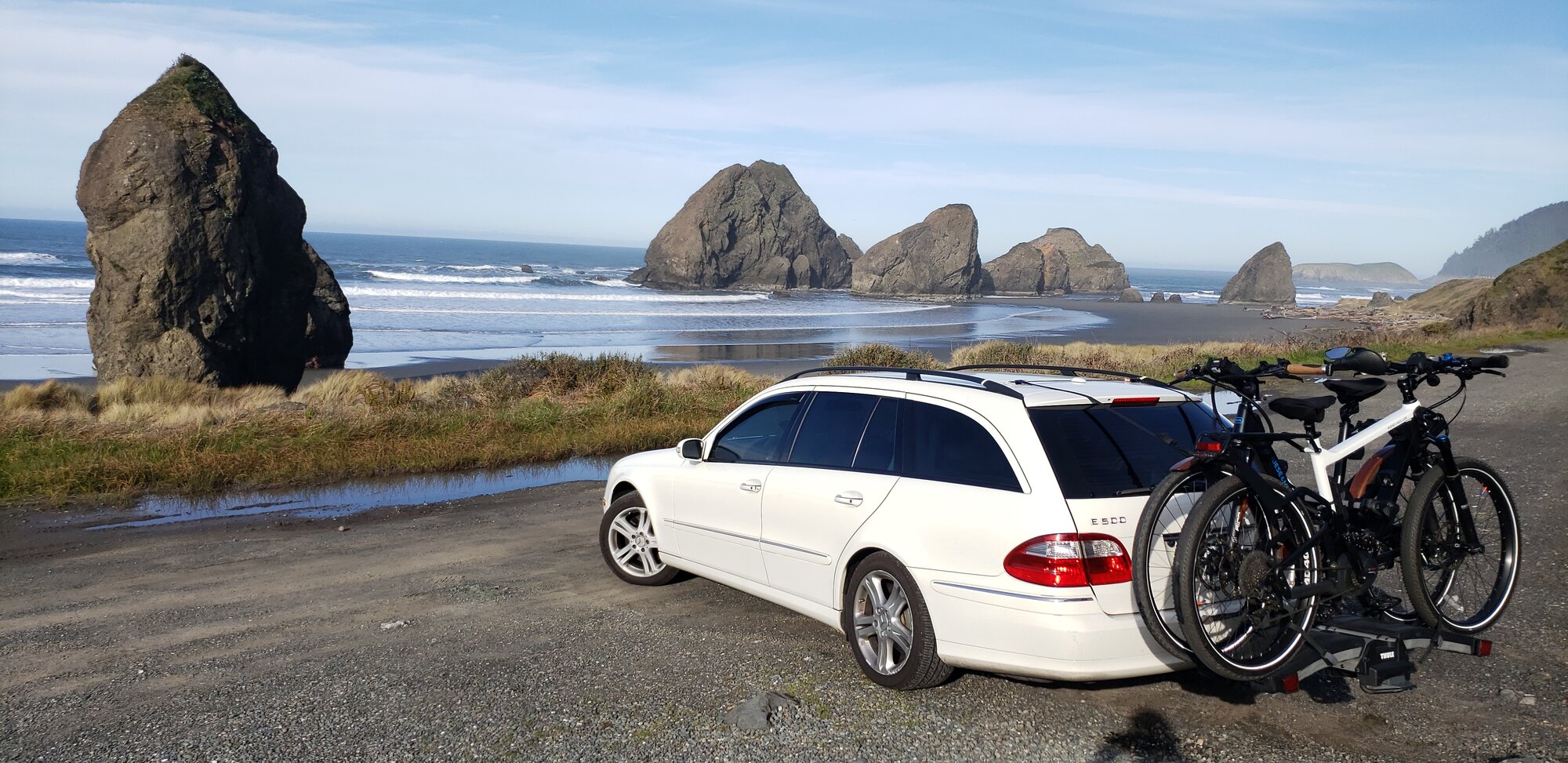

We have had a Thule Easy Fold 2 for almost three years now and have found it nearly ideal for heavy Riese & Muller Bikes. We have take two 3,000 mile road trips with our bikes. We had one of the clamp arms go bad as well as the locking ring for the hitch. Thule provided quick replacements in both cases. I do use two Curt bike rack straps to stabilize the rack and help support the weight. Here is a photo on the Oregon coast with a Homage and a Delight Mountain on the Thule rack.
You must not have the large R&M frame. I wanted this rack at first but the large frame on the R&M SuperDelight has a longer wheelbase than the Easy Fold 2 will accommodate. I'm thankful that a helpful Bike shop recommended the 1 -up even though they did not sell it.
