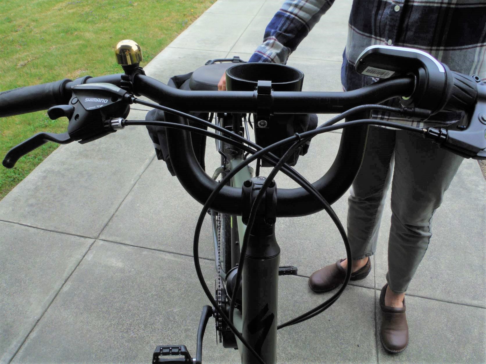

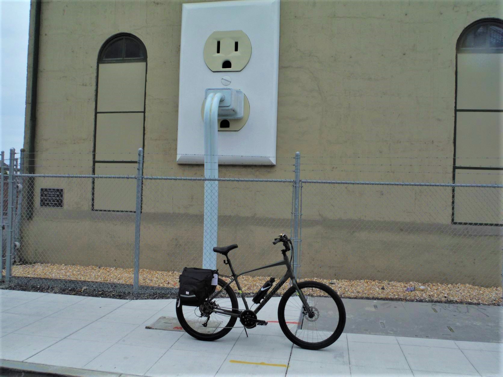

You ask me how to restart the ride uphill without the throttle? Learn riding. I stopped to take the top photo and could restart the ride without issues (Specialized Vado 5.0, 53 lb + a heavy rider + cargo).
