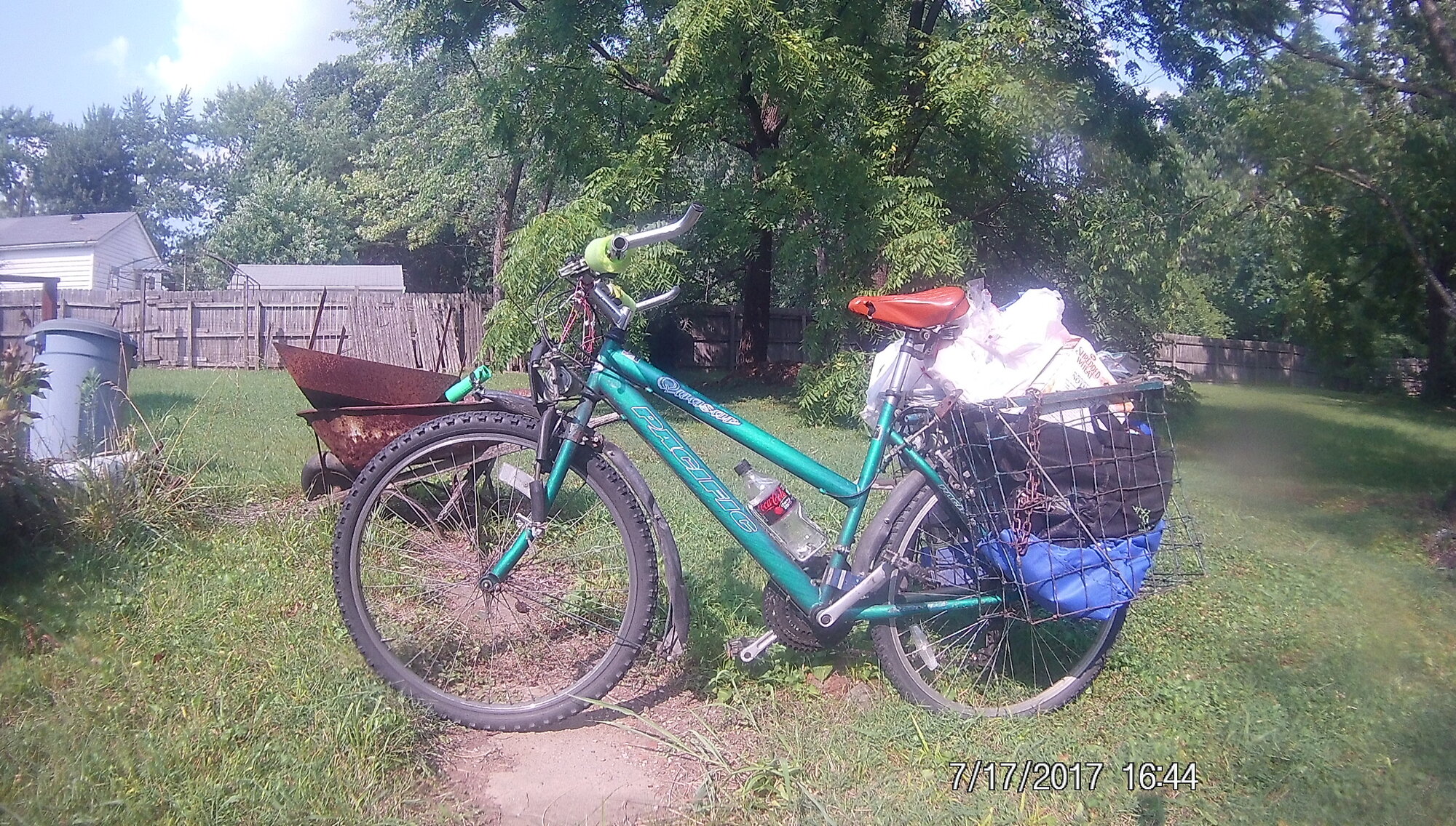

I have had step throughs since 2006. The current yuba bodaboda pictured in the avatar does not do it. The previous $200 Pacific Quantum did not do it: Kiddie quality bike. I carry up to 60 lb groceries in panniers or previously in steel baskets. My weight decreased from about 213 in 2008 to 155 lb now.
