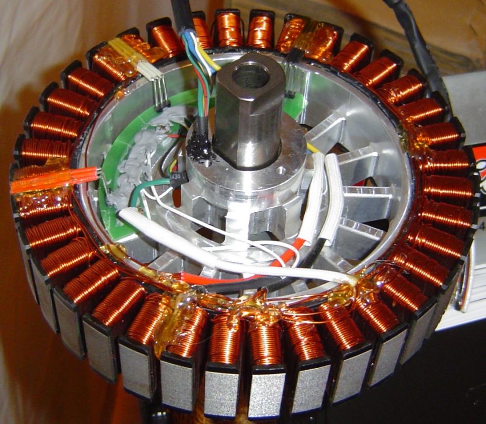

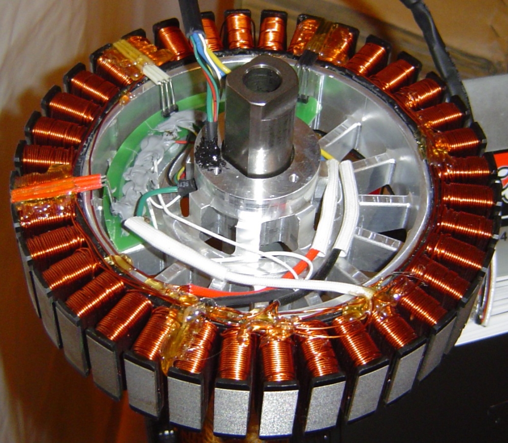

I read a thread on ES today about someone that had taken apart a Stromer motor and I didn't realize that they have an internal controller. Not sure if it is possible to use Statorade in that instance. The Grin boys would know for sure.

@JRA is referring to a very old thread where someone opened up a 2012 ST1 motor.
I will attach the pictures here but the new ST2 motors don't have the controllers built into them and the controller is in the downtube and as a result, they can pump in lot of amps without frying the controller.
This is the ST2 motor
I always forget to look at the dates! Thanks for clarifying that Ravi. I still think that if you could seal one up properly and get some in there it would benefit from Statorade though.
