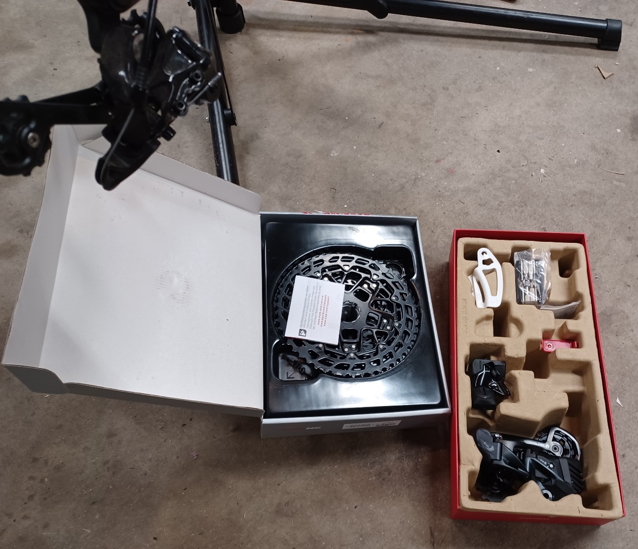

Good to know, Thanks!I have the sram gx axs $600, the sram nx eagle cassette $100 , the sram x01 chain $60 , works great. You don't need the xd hub because the nx cassette uses the shimano hub and is recommended for ebikes.
Then your running the exact setup that I have. I’ll definitely do this upgrade in the near future as it’s cheaper than I expected.Yes this is on the hydra. No problems at all. I did put a raceface 44t chainring on front thinking it might work better than the original but don't think that was necessary ( thinking the tooth profile might be slightly thinner) .
Yes, that's a good setup, but you don't get that 10-tooth upper gear for high(er) speed.I have the sram gx axs $600, the sram nx eagle cassette $100 , the sram x01 chain $60 , works great. You don't need the xd hub because the nx cassette uses the shimano hub and is recommended for ebikes.
