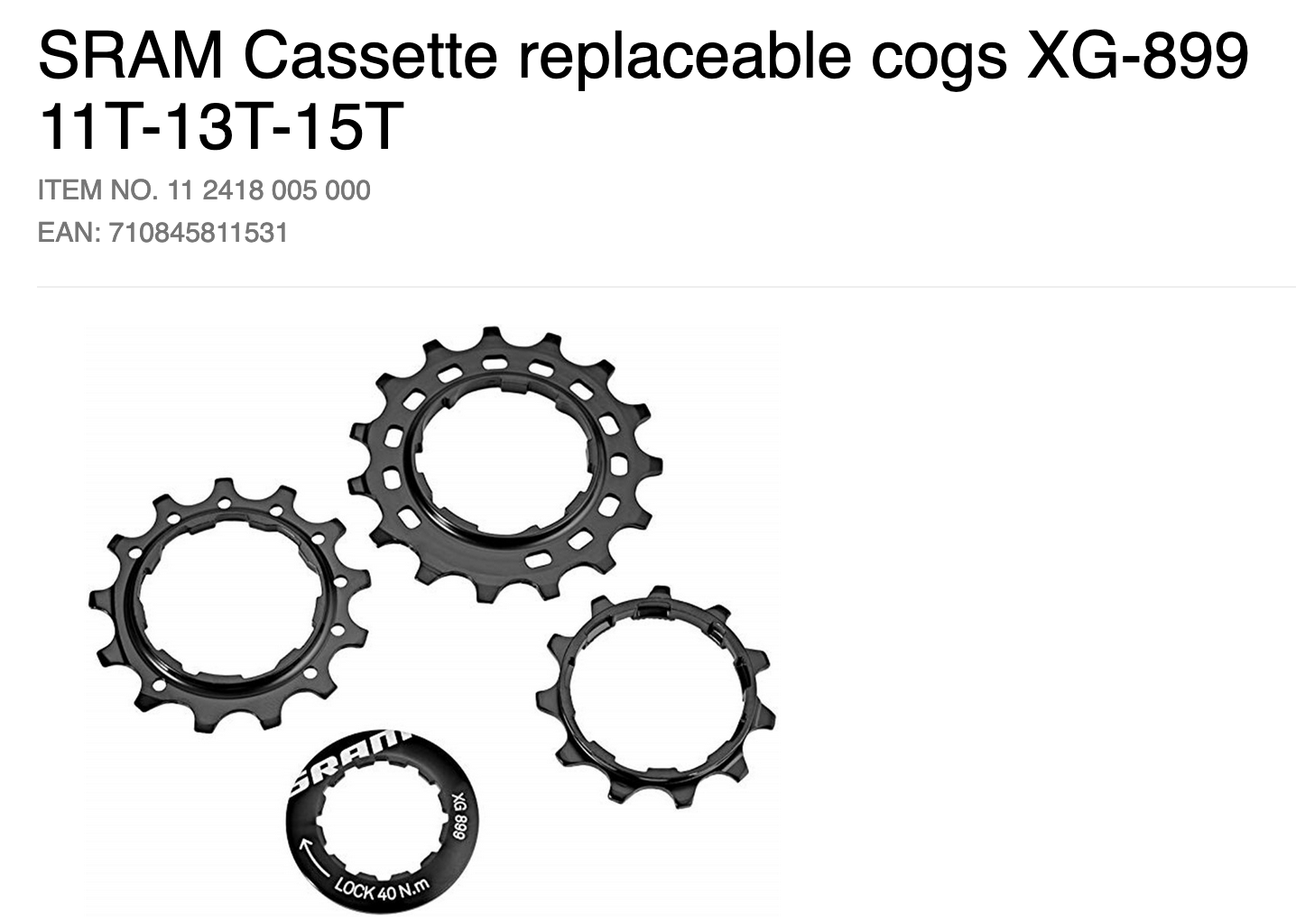

SRAM does have this available to replace the 11-13-15 cogs only. They wear out due to the high torque and low amount of engagement compared to the larger rings.
Same thing happened to me. I discovered my chains wear out in 1000 miles or less. It's real steep around here. But chains are cheap. I got mine for $17 from Bezos.
Yes, that's it ... but can you find the package in stock anywhere? I even asked a dealer about a year ago about the SRAM branded one you've listed and at the time they said they couldn't even order it (wasn't actually available from SRAM).
