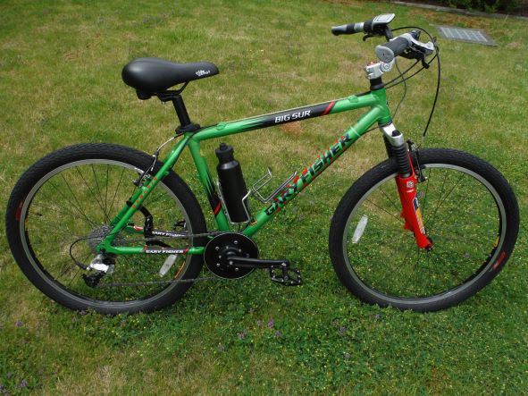

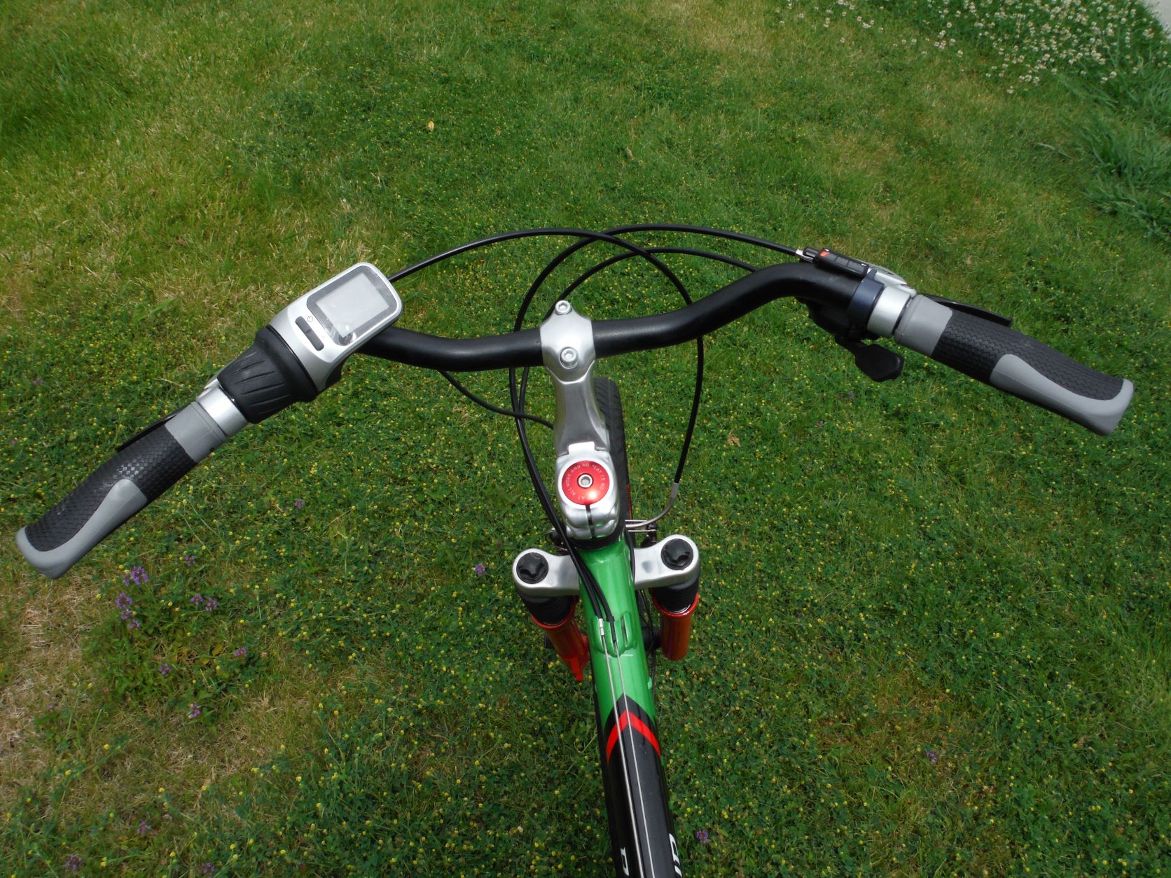

I found out that I do not need a speedo or Od. I have a good idea of what gear I am in and how fast I am pedaling. Just like a pianist does not look at his fingers, I don't squint at my shifter to know what gear I am in and I don't need to squint at a speedo to know how fast I am going. I would much more like a bike that is super responsive and give up those unneeded functions. I just finished the $120 bike. I know, no photo or it didn't happen. All it needs is a little air and it is ready to go.
