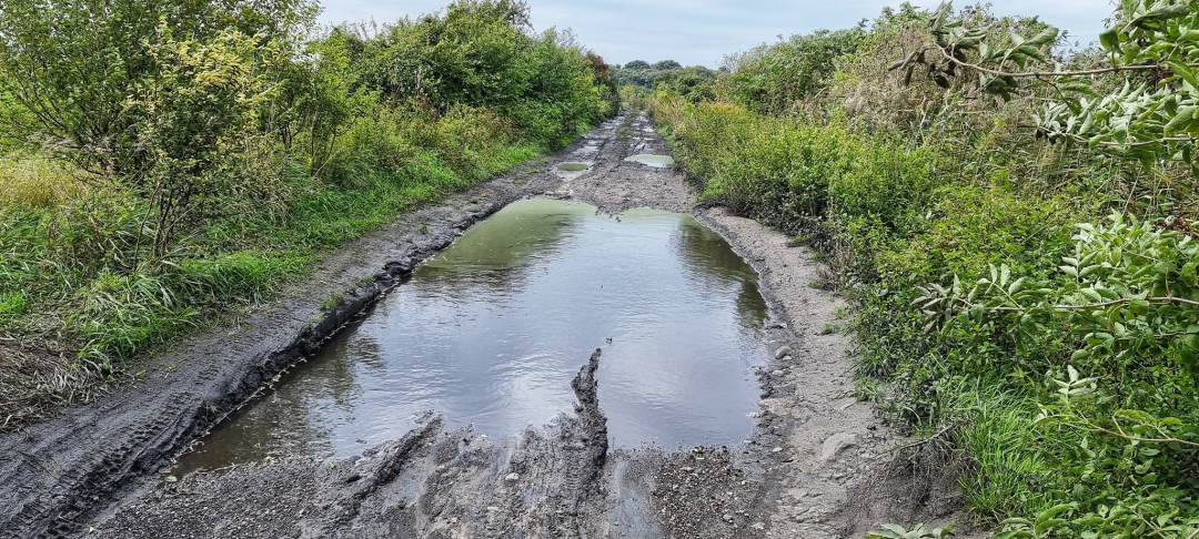

Try this with your Gazelle.
"Bad weather".
"Ride a lot".
Shimano 10-51t cassette has 510% gear range.
I don't have anything like this where I live (NYC suburbs), however I don't see any problem riding here (even with 1.75" narrow tires). However I often ride in the rain (and heavy rain) and after I do this, only thing I need to do to service my bike is to wipe the dirt spots from the frame and nothing in relation to belt. What kind of service you have to do with your chain after riding in a rain? Don't say nothing - I won't believe this.

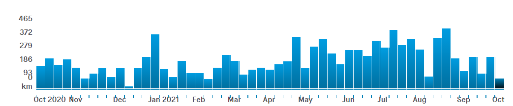

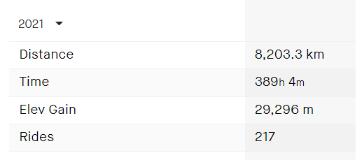

Now, you show me your Strava stats, ava1ar. Distance ridden in 2021, elevation gain, breakdown by month.
Don't say anything - I know you do not record your rides.
