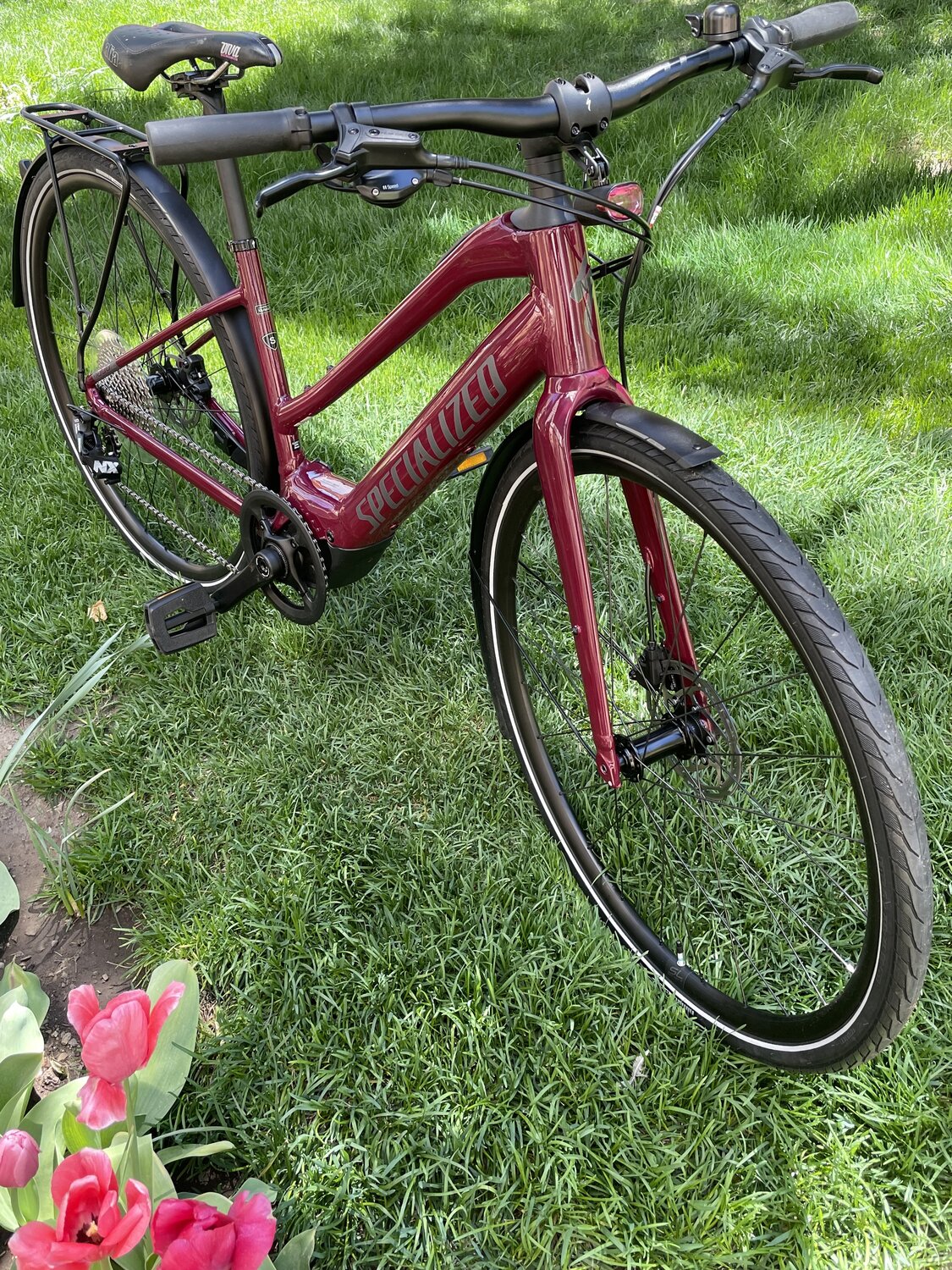

Hi Vado SL friends,
I'm new to this thread and am still making my way through all your wonderful posts! In the meantime, I thought I'd post my brand new 2022 Vado SL 4.0 EQ step-through model, which I just took delivery of. I originally wanted to purchase the 5.0 EQ model for the many upgrades it offers; however, I decided on the 4.0 EQ because I prefer the ruby aesthetic and thought I could upgrade my 4.0 as many of you have.
I'm mainly a mountain biker, but have owned several analog fitness bikes such as a super-light, top end Trek FX with a carbon fork. I still regret selling that bike! The Vado SL offers a similar feel with the added benefit of a bit of pedal assist, which is what I was looking for in a light(ish), nimble e-fitness-bike. So I'm quite pleased.
Has anyone upgraded their 4.0 SL with any of the following:
1) Enve riser bar (I saw one on an upgraded Orbea alloy MTB while out riding yesterday, and thought I might like one for dampening, etc.);
2) Carbon fork from the 5.0 SL model (if so, could you please provide the P/N?);
3) Future Shock 1.5 from 5.0 SL model (if so, could you please provide the P/N?);
4) MasterMind Turbo Control Unit (TCU) from 5.0 model (Specialized told me this isn't compatible with the 4.0, but I've yet to confirm whether this is correct);
5) 1x12 drivetrain (for added gearing, which I would use and enjoy as I'm regularly topping out at the highest gear; I particularly like SRAM's XX1 1x12 drivetrain);
6) Carbon rims.
I know @Stefan Mikes has done many modifications but, just to clarify. I'm not a road biker and I'm not looking to emulate that posture. I also previously owned the Kinekt system and wasn't terribly impressed with its aesthetic or its performance. So, while I may be interested in eventually looking into the Redshift Sports items, I would first like to investigate the options above.
Thank you everyone in advance of your thoughts and suggestions, and for this wonderfully informative thread!

I can’t answer many of your questions, but I can let you know that you can’t get these two items nor would it be worth it as they would probably be more expensive than the difference between the 4 and the 5.
I believe a 1x12 drivetrain is possible. I may update from the ten to 11 or even 12 on my 2020 4 EQ when it’s time to replace the current cassette. As with most parts and accessories lately, it will depend on cost and availability.
I think there was a discussion on Carbon rims recently. They’re not something I’d buy, but see what you can find. Stephan will undoubtedly chip in.
Enjoy your bike.

You can order these via Specialized LBS. Both parts come as a set, and the carbon fork is always black. The set is such expensive it cancels the cost difference between the 4.0 and 5.0 (as BEC said). I used the price difference for a full Redshift set + Range Extender.
Why not a 30-degree Redshift stem if you want to ride more upright?
@grnmtnbk - Hayes currently has the 720mm length carbon Protaper 20/20 bar on sale for $43:
Mrs levity and I use these on out SL 5 bikes and ❤️ them.
Nice hand/wrist position and good vibration damping.

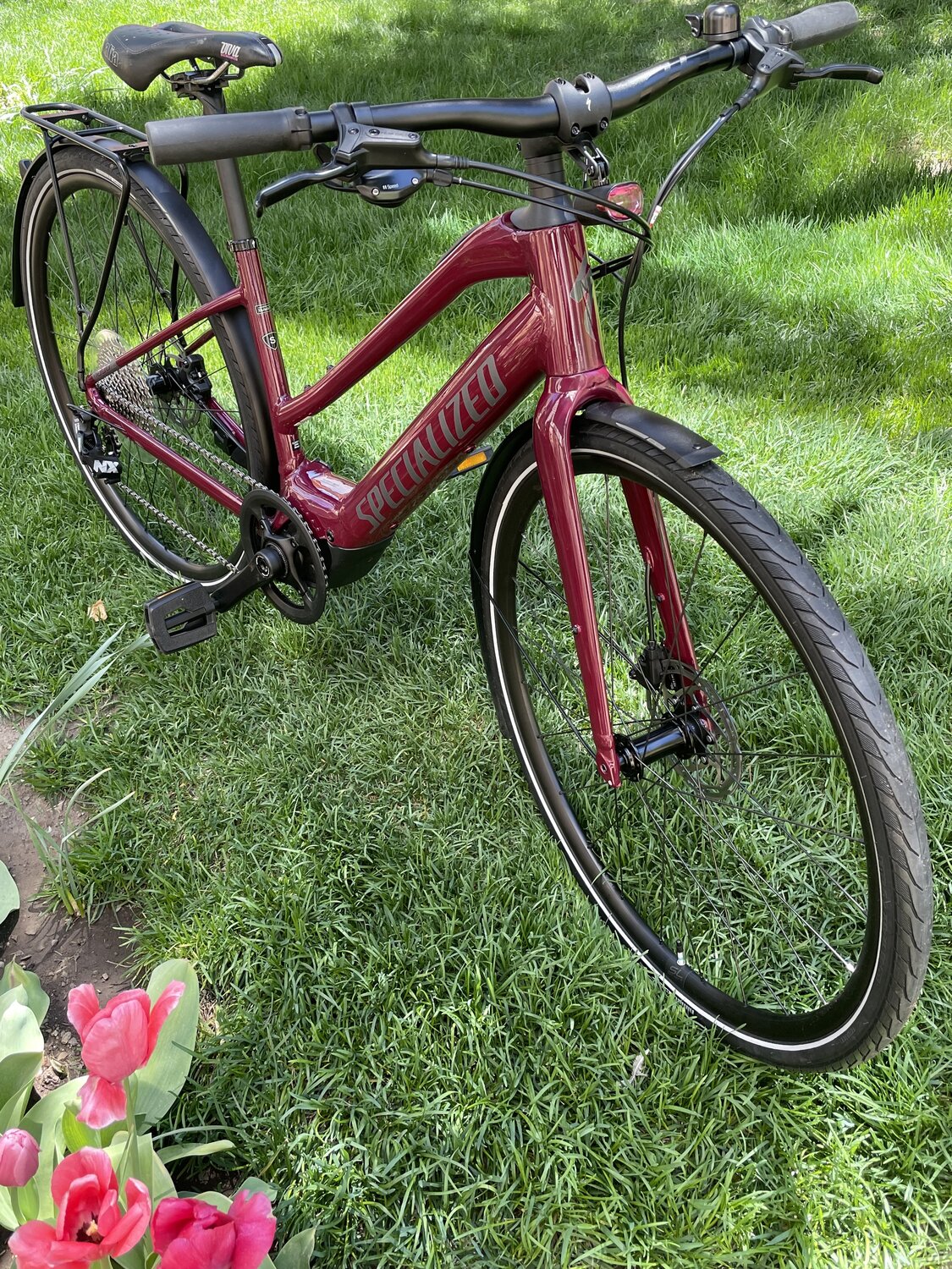

Hi Vado SL friends,
6) Carbon rims.
Congrats and enjoy.
@grnmtnbk
I can see choosing that color - REALLY NICE. ENJOY the new bike
@kahn: Thank you! I love it!
@Bec111: Thank you for your input! If I could, I'd buy a carbon version of the Vado SL. My primary concern is comfort, and my secondary concern is incorporating these upgrades in an aesthetically pleasing and cohesive manner (to me, of course). Specialized extended special pricing to me, so paying a bit more to get more in my view is worth it even without a discount. So far, I am certain I will first upgrade the bar to an Enve riser bar, unless Specialized has a comparable part. Enve is the gold standard in carbon bike components. Then, I will likely add the carbon fork and Future Shock combo mentioned by @Stefan Mikes. I'll be sure to post pics so you can see the changes. Thanks again, I welcome any additional thoughts you may have.
@Stefan Mikes: Hi Stefan. Thank you for starting this thread. It's a great place to bring Vado SL owners together and to share our experiences and information with one another.
The carbon fork/Future Shock combination is more to my liking. I also don't need a range extender, as I'm a light rider and have repeatedly returned from my riding with a surprisingly robust amount of battery life remaining.
At this point, I'm not planning to utilize Redshift components in my upgrade, but that may change as I discover what's available from Specialized. Do you happen to have a P/N# for the fork/shock combo? That's something I definitely want to add, but so far I've only found the fork through my LBS. They're still checking, though, and will be reaching out to the rep next week, so hopefully I'll know more soon.

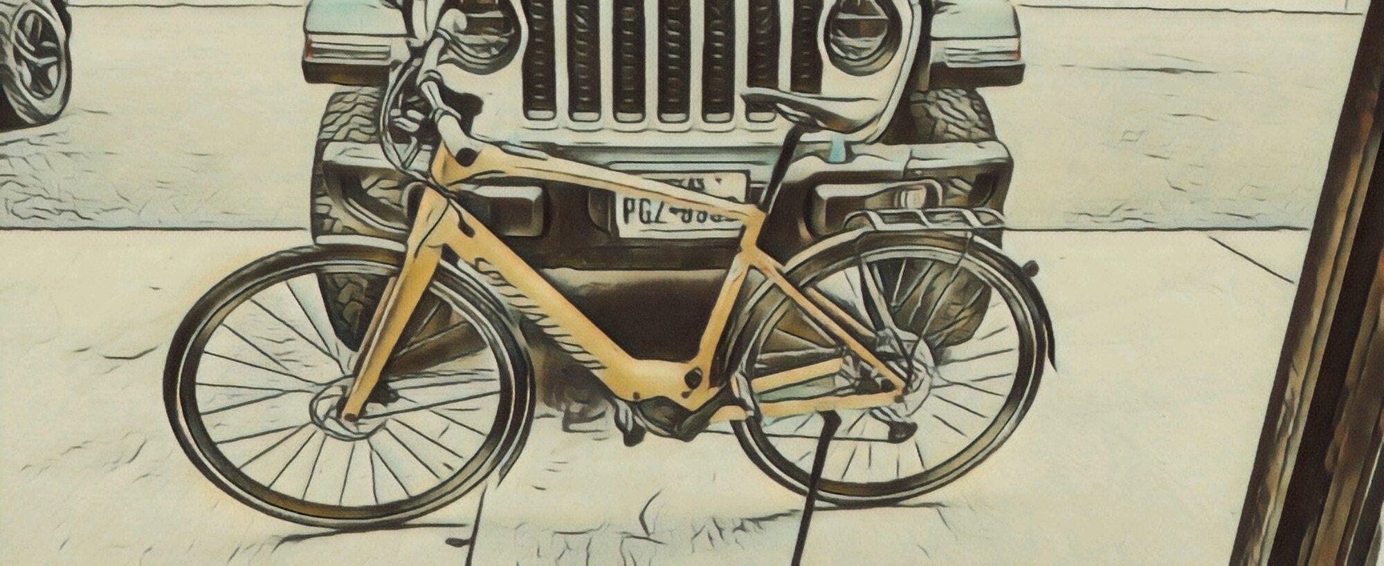

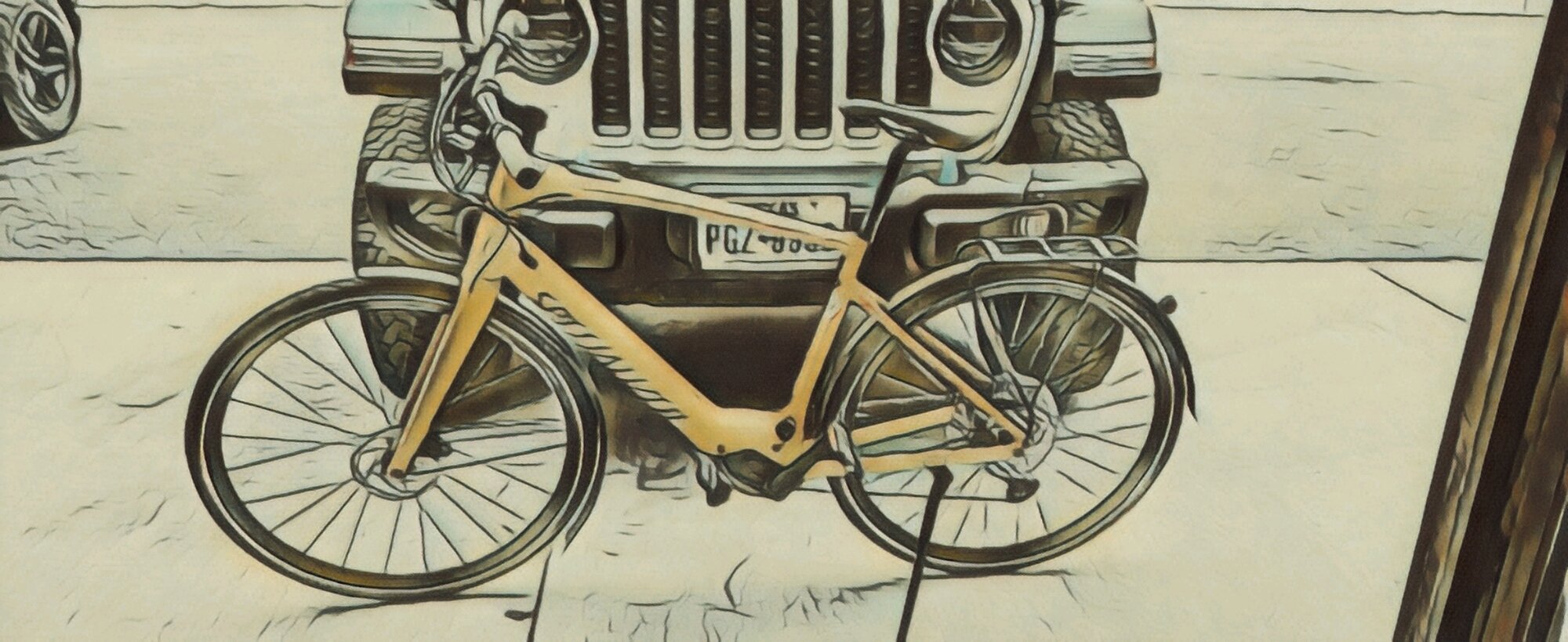

After test riding the Terro, Vado 4.0, SL 4.0 and SL 5.0 EQ, I decided on the SL 5.0 EQ. First ride was approx. 10 miles and I was very pleased with the bike. Surprising enough, I rode with no assistance (relatively flat trail) and enjoyed how the bike handled. I am glad that the bike, with assistance, will be enough for me on future rides. I was previously concerned with my need for power as I was previously riding a Turbo Levo Comp with the larger motor. Most likely will change tires out to more gravel capable which will require fender removal in the future. For now I will leave it the way it is and ride the heck out of it.
Congratulations on your new Vado SL!
I am a great advocate of Specialized Pathfinder Pro (I ride the 700x38c). If you remove the front fender, you will avoid issues I had regarding gravel and forest rides. On the other hand, removing the rear fender would deprive you of the rack and the tail-light. That's why I encourage you to stay at the 38 mm tyre size (regardless of the make/model). 38 mm is a proper gravel tyre size ridden by many. SL 5.0 comes with tubeless ready wheels: if you convert to tubeless, you would be able riding your SL at low inflation pressure, making your e-bike ideal for gravel rides.
Congrats on a great choice. I've barely ridden unassisted just because it's my first e-bike and I'm enjoying the various assist modes. I rode 50km today in mostly eco.
