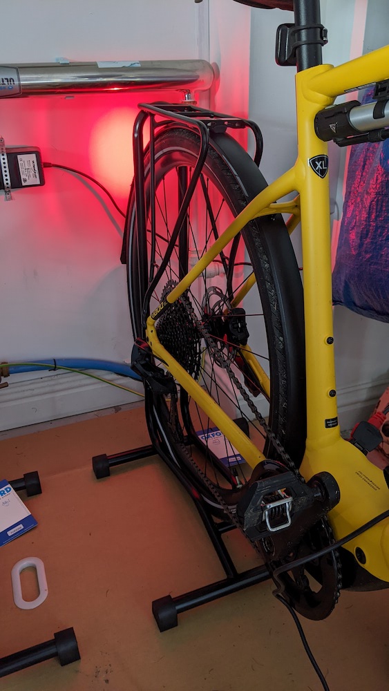

Not sure if you're thinking of the EQ version or not. I've got the EQ. I've yet to use the rack, but am pleased with the guards. Unfortunately the rack is used to support the rear guard.
There is a good thing about the rear mudguard/fender in the EQ: It supports the tail-light. Users of the non-EQ version have to struggle with the tail-light being integrated with the saddle. It makes using anything else than a Specialized saddle difficult, and you are also limited as to the selection of any suspension seat-post. For the practical terms, only a 27.2 mm Kinekt 2.1 seat-post with a hole drilled (to route the tail-light wires) could be used. Popular Redshift ShockStop seatpost cannot be used for the non-EQ.
The EQ front mudguard/fender is useful during the wet season but is a pita if one wants to ride in the forest, as the mudflap attracts small objects making the wheel blocked often. I remove the front guard for the warm season.
Actually ... there's another thing that's good about the rear rack. It conveniently hooks over the top of the bike stand I use, making the bike almost wobble free and vertical. Very convenient for doing minor maintenance tasks.
It's also a useful place to tuck your gloves when stopping for a coffee or to look at the view ...

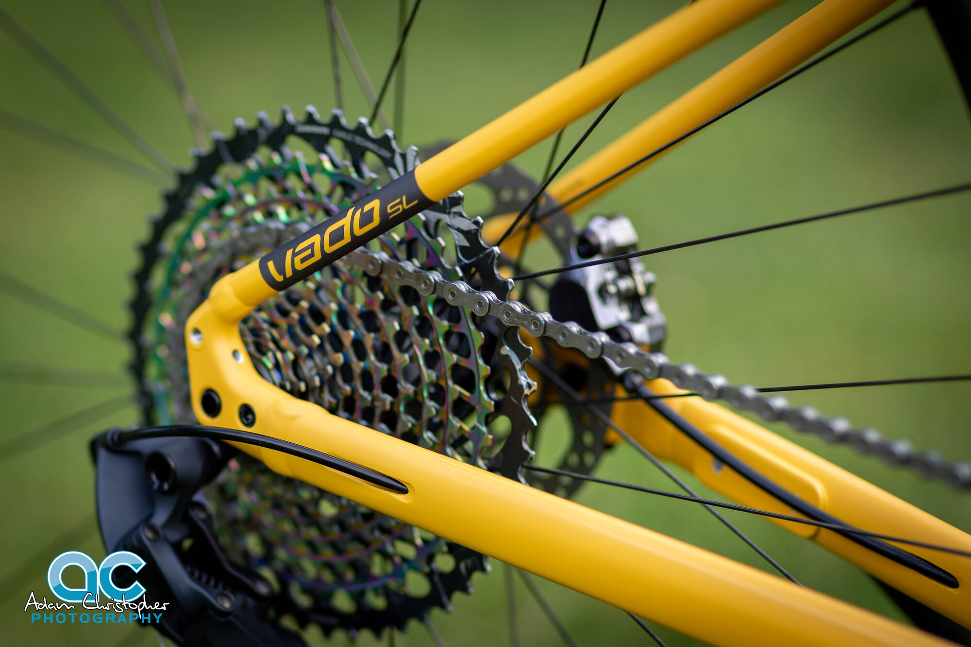

@Stefan Mikes could you expound on this a little? No granny gear, but how do the others change? Might this be a good change for flat Florida? I probably never need the top or bottom, so a closer spread would be nice.
This is a Deore XT cassette, Dan. It comes in three flavours (32 or 34 or 36T the largest cog size).
The gearing (36T) is 11-13-15-17-19-21-24-28-32-36T. As you can notice, the 6 higher gears (6-10th) are equally spread. It makes your cadence pretty constant on longer rides.
As I said, the standard 44T chainring combined with the 36T lowest gear let me climb a 10% grade incline in SL Turbo mode. And of course, Deore XT is a higher groupset. The beauty of that cassette is you can get on a pretty high speed with tailwind with the 11T sprocket, and climb moderate hills with the 36T. That specific cassette was recommended to me by several EBR Forum members, (especially @TS25) when I was considering the replacement of the drivetrain to 11-speed. It saved me a lot of money and effort!

So your SL 4 came with a 10-speed drivetrain. My cassette is a Sunrace 11speed, 11-42t. Was this a change for the new model year?
I’ve never changed gearing in any of my bikes so I’m reading up on it…
