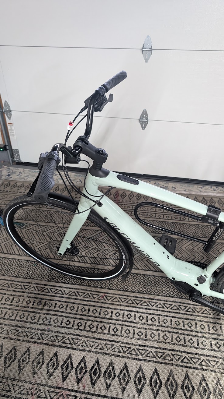

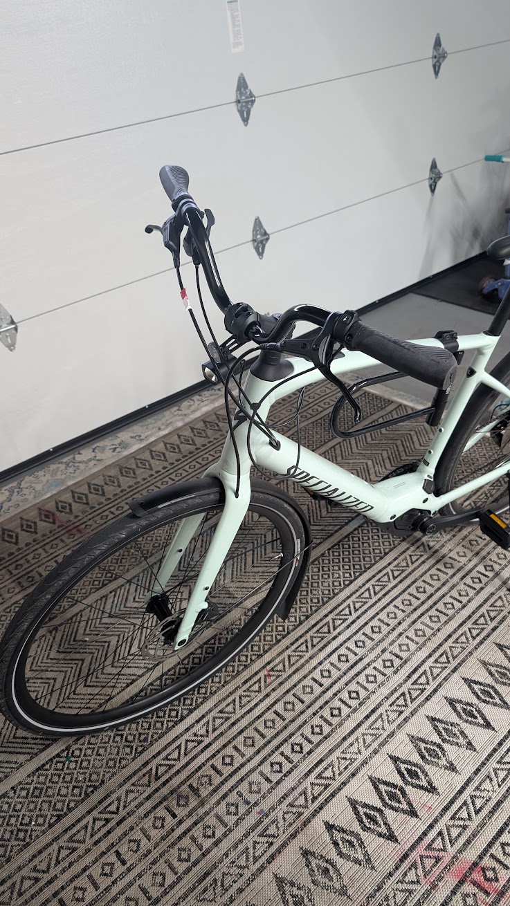

I recently got a Vado SL 4 EQ and found the handlebars too low. I read a lot of threads on here about raising the handlebars and asked my local bike shop to do a stem riser. They preferred to try use a raised handlebar as they were more confident it wouldnt need the break likes rerun. Overall I'm pretty happy, I would prefer them to be a bit higher but it was pretty cheap since the break lines didn't need to be rerun.
Bear in mind the more relaxed position you ride, the more of your body weight lands on your butt :) Just saying.
Yeah I might need to get a more comfortable saddle. I do feel stupid for not buying a bike with a more upright position. It's the first bike I've owned since in a long time and I ordered it online without seeing one. I really liked that it was electric and light and didn't consider the riding position.
If you want to ride for any length of time or distance it would be better to get used to a sportier position as opposed to an upright position. There is no saddle that feels comfortable after awhile when in an upright position with the majority of your weight resting on your back end. If you're just going for shorter cruiser type rides than, yes, the upright position may work better.
