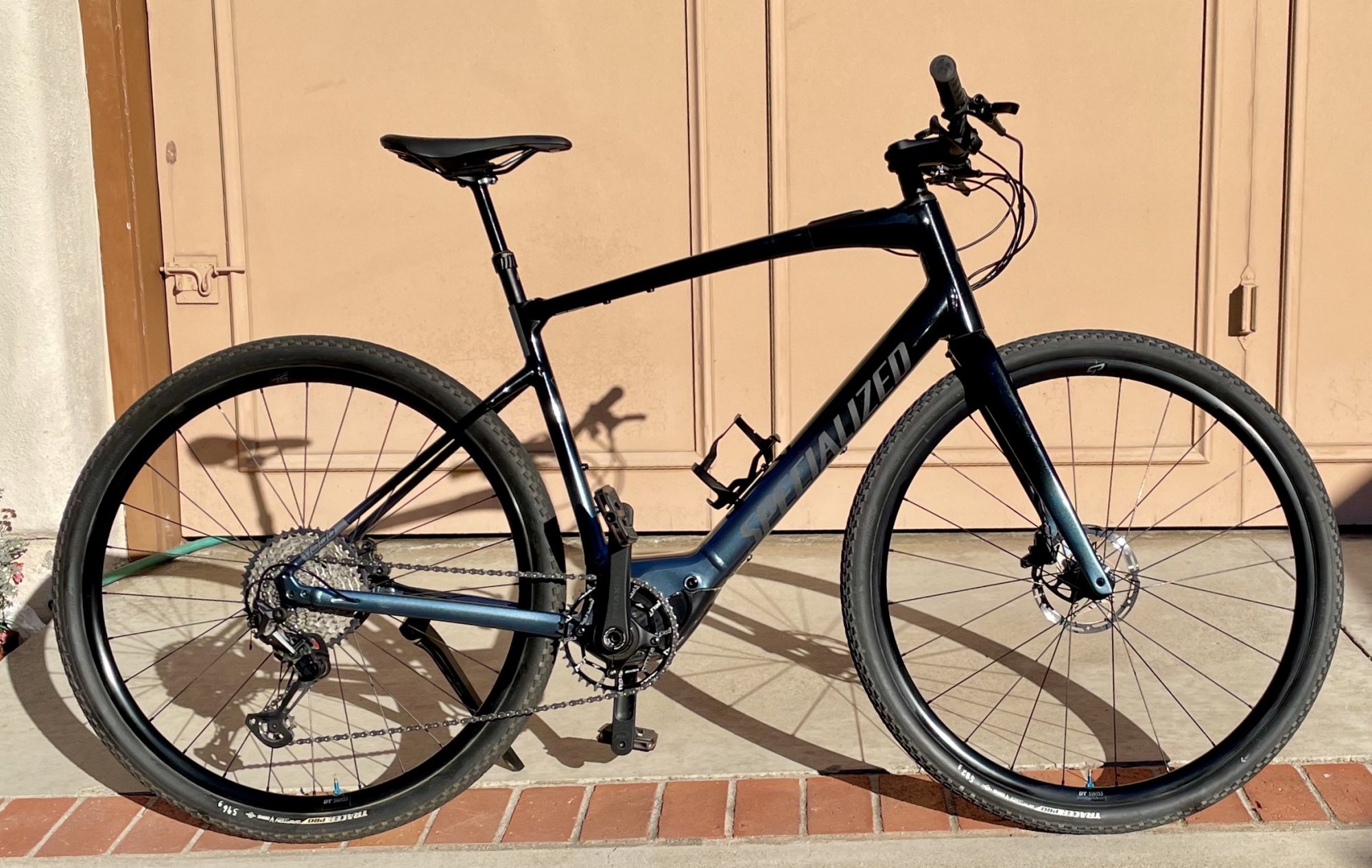

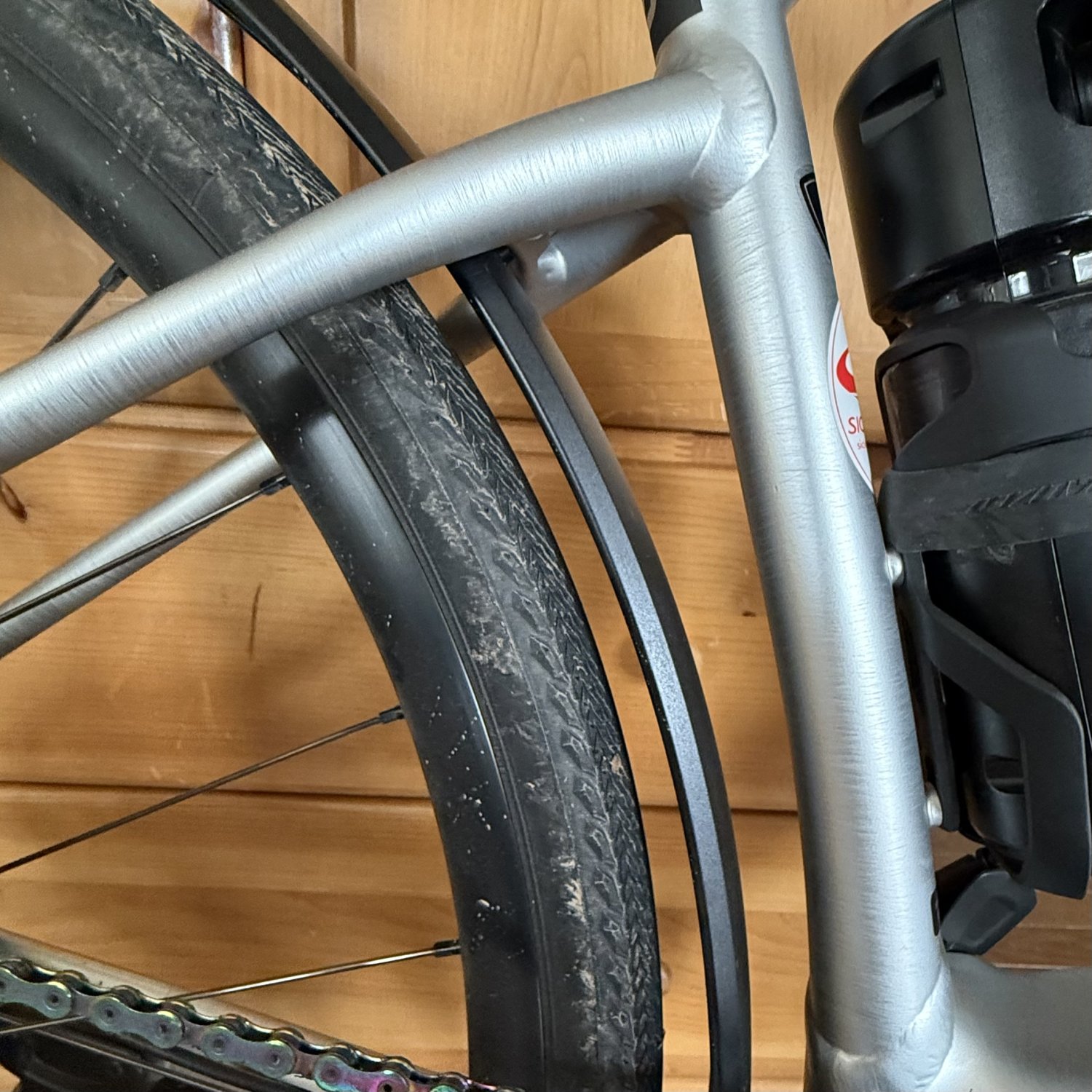

Hi everyone! I have posted before and have gotten excellent information from this forum whenever I have a question or before I even knew I had a question. I have a Specialized Vado SL 5eq and I am thinking of installing a dropper post (I don't need suspension as I don't ride it off road). I would like a dropper for ease of getting off and on; I am a cyclist of 40+ years who does most of her own maintenance & repairs, but as I age it's getting harder to swing that leg over. I get on now by tilting the bike as most of my older friends do but I find that there is that critical point that, if it tips too far, there is no going back. I've had this painful experience. Currently, I have a Thompson alloy post that is 27.2 x 250mm with a 16mm setback (Pictures below), I realize that messing with the setback may require a longer stem; I am overall about 5'2 (157 cm) but my femur length is a bit longer in proportion to the rest of me. Before the questions about the amount of seat post I have exposed, I've had to do this on all my road bikes since I need a Small sized frame (46-49cm) to get a comfortable standover height due to my weird proportions. You can also see that I have my seat shoved way back on its rails as well. I had to replace the Specialized stock post that came with the bike because I would have had to raise it above its max insertion point. I have used setback stems on other bikes as well, but this is my first e-bike.
With all this in mind, my question is: Will I be able to use a dropper seat at all with this bike as I notice there is a curve near the bottom of the seat tube (Pictures below), so there must be a length limit on the length of the post. The amount of seat post above the frame is about 150 mm so there is about 100 mm in the tube. Does anyone have any experience with this? I thought I'd ask all of the collective wisdom on this forum before I even continue my dropper post quest--it may be all for naught:(. If it seems doable then I will contact manufacturer's or Specialized directly, if not I will strap a step stool to my rack! Thanks!
@Jencuya - I recommend using the stock Specialized seat-post (or any long, straight 27.2 post) to measure how far a post can be inserted into the frame before it hits the curved seat tube area or bottle-cage nuts and stops. Then you can just look up different dropper post model dimensions to determine which if any will meet your needs. Most manufacturers provide detailed numbers, but finding one with the setback you want may be difficult.
Be aware that it’s a bit tricky to thread a dropper post cable housing thru the frame. We were able to do it on mrs e-levity’s Medium SL and my Large SL, but I can’t say how whether or how easy it will be on your Small frame. Here’s a PNW 90mm dropper post on my Large Vado SL -

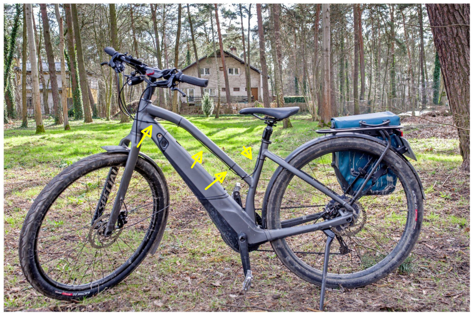

The major reason I could not install a dropper on my Vado SL is there is no space to go with yet another cable through the opening in the e-bike frame where all other cables go. I was considering a wireless dropper but I decided it would be too expensive for me. Same with swapping the drivetrain for a wireless one and using a regular cable operated dropper seat-post.
Thanks! I didn't think about inserting a straight post. I'll try this after I can excavate it from the basement. I think I remember dropping the original seat post down as far as it could when I was replacing it and it didn't go down the whole way, so that doesn't bode well for a lot of room--less than 250mm. Did you have to remove the motor to get the internal cable threaded or were you able to fish it through somehow? This is something I don't feel comfortable doing on such an expensive bike; I'd probably have my LBS do it, but I'm not keen on that idea either. PNW has an external cable routed dropper--the Pine, but Stefan Mikes makes a good argument against external routing it because of how it looks. Sharp bike. I love the color, looks like you put a new chain ring--love the minimalist look of it.

I think a gravel bike short-travel electronic dropper such as REVERB AXS XPLR 27.2 50 could do. It is a 27.2 mm post diameter, 50 mm travel dropper seat-post. Now, it is not only deadly expensive but you also need to buy a very expensive handlebar remote at an extra price... Were I you, I would give up the whole idea.
