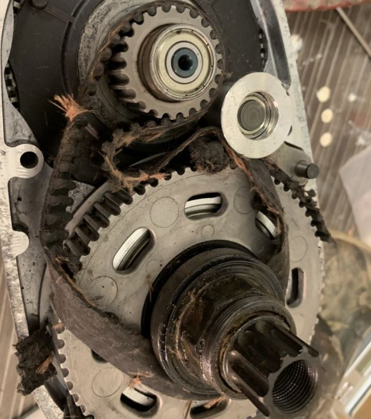

I'm showing from German threads two Brose drive S motors opened due to a torn belt.
Both times the belt was torn again shortly after replacing the first belt with a new 'normal' Gates belt you can buy and which has the correct size.
Just as a warning because this happenend several times to riders who bought the 'normal' Gates belt for app. 10-12€ to save cost, Vado out of warranty.
So please don't try that. There is a set from Brose with a special Gates belt which is much stronger.

Good to know... I understand that the belt drive is the Achilles heel of the Brose motor.
Well, it is both.
The sweet spot and the weak spot of the Brose motor.
The belt driven motor makes it the silent motor to be enjoyed. No other motor in the market is that silent.
But it seems that Brose is still struggling hard to figure out how to make it more reliable. That's why Brose asks all failed motors back during warranty and doesn't allow the LBS to open the motor before.
Brose says the belt should be exchanged after 15.000 km. But it is advised to change earlier. Trained LBS are allowed to belt exchange. The motor has to be taken off the bike for that, you need a special torque wrench for the tensioner (0,25 Nm only!), the little tensioning screw and the gasket should be changed. All this (but not the special wrench) is in the Brose belt replacement set.
Belt lifetime also depends on the stress the rider puts on the belt. Not shifting down before stopping so starting with high pressure shortens the life not only of the drivetrain components but of the belt too. So riders have reported torn belt after 4.000 km and others haven't had a belt problem until regular service (exchange).
I'd like to see a comparison of the two belts.
Easy. Just get the Brose repair kit and buy a normal Gates belt same size for your comparison report. The people with the torn cheap belt replacements went for the Brose exchange kit afterwards and I doubt they'll buy another cheap belt just for the comparison.
Might have been a misadjustment.
I doubt that. The rider who exchanged the belt I showed in pic 2 reported that he tightend the grub screw correctly with 0,25 Nm.
Also these two are just examples of a lot more torn 'cheap' belt exchanges.
Don't think I need a comparison at that cost.
Wonder if the adjusting screw provided with the kit has loctite preapplied, and if the reapplication of the used adjusting screw had some locking compound reapplied.
The grub screw has a thread lock and yes you should use Loctite which isn't preapplied.
