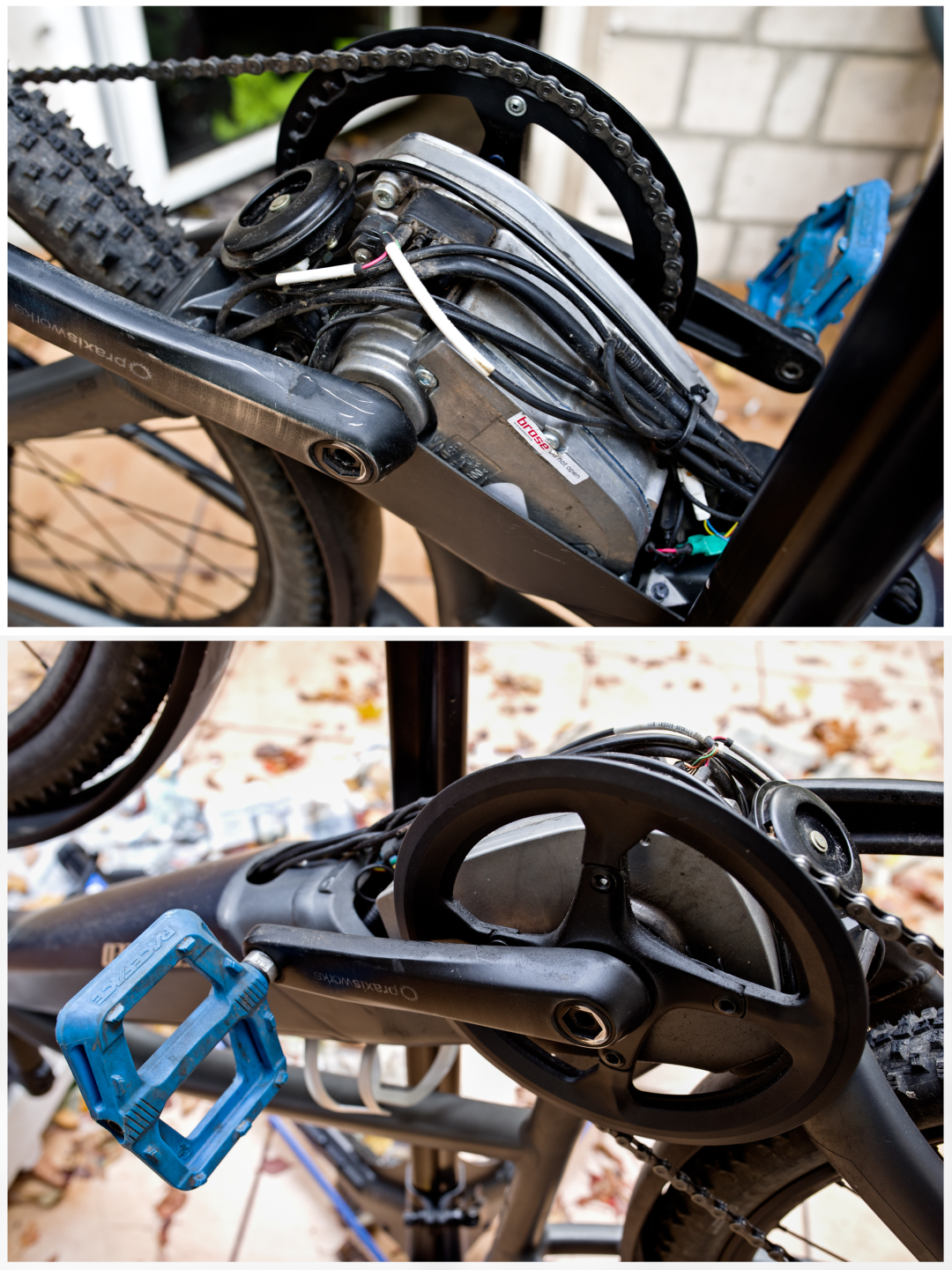

Ever curious how the Specialized motor looked like?
A look under the skid-plate. The only label visible is "BROSE Antriebstechnik. Do not open." The motor was surprisingly clean, with only some dust.
The frame was not cracked, and mounting bolts looked fastened properly :) The big black cylinder at the left hand side in the top motor is the horn.
Congratulations on your 1st anniversary. ;)
Glad to hear that all is well with your Brose motor and frame... check the mounting bolt torque specs to be safe.
