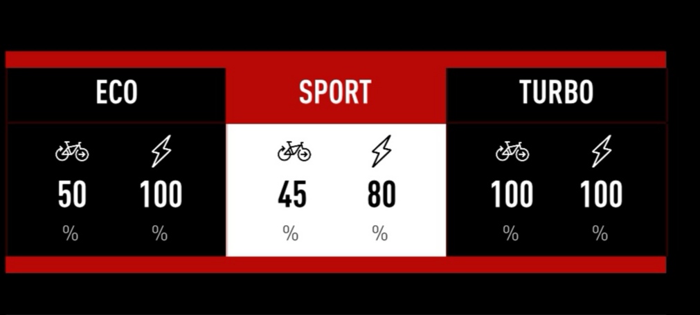

When I turn on my 2020 Como 4 the power level automatically goes to the middle one. Is this the same in all of these bikes? Can it be changed to manual/no assist?
Thanks, John
John , the default startup is level 2 "sport".You can not change that,but if you have mission control you can set level 2 to whatever you want like Stephan reversed his level 2 and level 3 boost values so it starts in "eco".settings .
The default assist mode here is Sport but the support levels have been swapped in Mission Control as Art says.
Great tip. I got on my bike and took off yesterday while forgetting to drop it to 1/Eco I was shocked at how fast I was moving and kept wondering what I ate that day that made me that much stronger. Then I lookeD down and saw that I was still in 2. ;(
Let me explain something. My support settings are the outcome of careful and long-time tuning. I and my brother Jacek are setting off for a 109-km ride today. He will be riding my Lovelec e-bike in PAS 1 the whole way; his intention is to prove he can make it (and even more) on a single 576 Wh battery with pretty strong headwind for 60% of the trip. I'm a far weaker rider and must be absolutely sure I could make the same trip on two 600 Wh batteries of my Vado while maintaining Jacek's speed. (He's a cycling demon and rides fast).
My default customised settings allow me riding with the average speed of 28 km/h (17.45 mph) with the stronger "Eco" mode upwind and with the weaker "Sport" mode downwind. Since there will be several stops en route, I don't want to think of changing the support mode on any re-start. Hence the settings as shown before.
Besides, I like things to be complicated. When a feature's there, why not to use it? "It is not the rocket science" :D
Oh, Tim, how you like teasing ;) I shall change my forum handle to "Mr. Serious"!

I have not reversed my eco and sport mode positions, however I have more differential of assists between to two modes than Stefan so I notice immediately if I forget to set it to eco when starting off.
