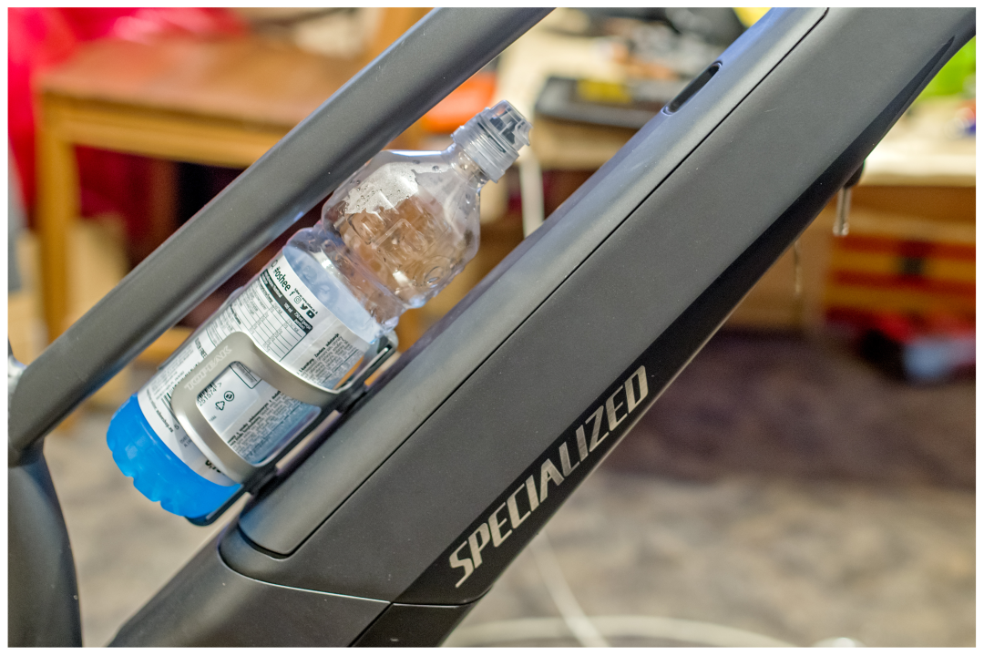

Finally, I have found the right water-bottle-cage for my Vado (Topeak DualSide Cage). The benefit is I can remove and replace the battery even with the cage on (had problems with other cages before); even long bottles fit, and I can manipulate the bottle from a side. The drawbacks are I actually need yet another cage for the spare battery, and the battery wouldn't fit in the Ortlieb E-mate pannier anymore.
Is that kind of a disposable water bottle popular in your area?
I had originally put a side pull cage on my wife's Vado and found that it did make removing the battery a bit more difficult. As it turns out, she prefers to keep her bottle(s) in her handle bar mounted 'feedbags'. I mounted her folding Abus lock on the battery. Problem solved, and a happy wife. A two-fer, as they say...😎

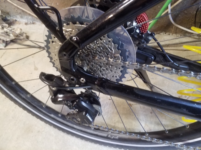

So this AM was cool and very wet with thunder, lightning and hail. A good day for the annual chain replacements.
Removed the originals chains and cleaned and lubed the rear derailleur and the chain ring.
On the Vados I installed 126t Shimano CN-HG701-11 chains shortened to 120t with their matching master link. Made sure to match the alignment graphic on the inside of the chain ring to get the chain correctly aligned with the wide/narrow teeth. Their master links are a bit of a challenge to get them to snap closed. After checking with my consultants (MTBer sons), I positioned the partially closed master link at the top of the chain, pulled hard on the rear brake and pushed on the pedal. The link clicked closed after applying more pressure on the pedal than I would have thought necessary, but, hey it worked, with no special tools!

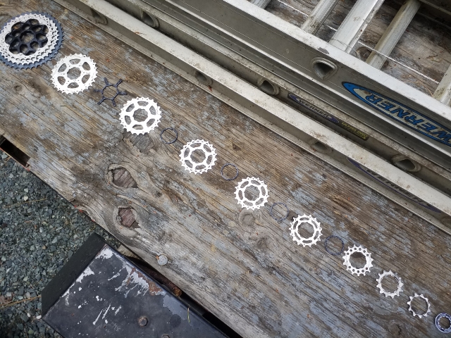

On to the cassette. I have cleaned this in place several times over the past year but after ~1,000 miles it was ready for deep cleaning. I was surprised that it breaks down into 16 pieces when removed from the wheel😯.

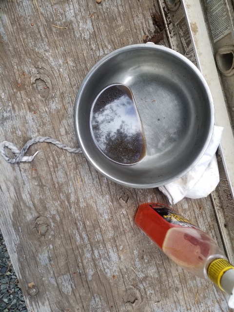

I made sure to keep all the parts in their relative reassembly order, observing front/back for each cog as well. This pic was after cleaning and wiping down with a WD40 soaked rag. Here's the grime that came off;
The fluid in the bottle was what it was like before cleaning the cassette😖.

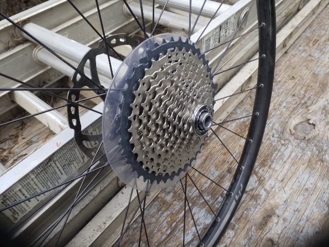

Reassembled the cassette on the hub with a bit of anti-sieze compound on the splines.
Reinstalled the tire with the new thorn strips, cleaned the rotor, blowout the brake caliper and mounted the wheel.
