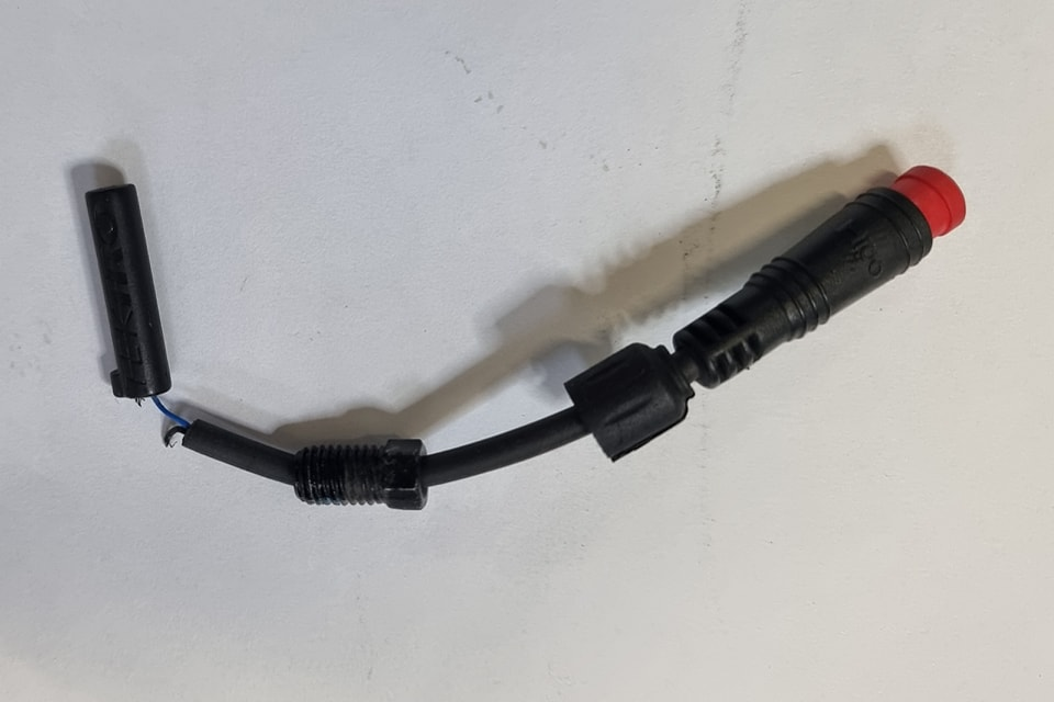

My brother Jacek did a great job as of today on my "big" Vado:
  • Repairing the STOP indicator switch in a TRP Zurich brake lever
  • Lowering the stem as much as possible
  • Fixing the number plate support at the rear fender
  • Swapping the tyres for Schwalbe Marathon Winter Plus 50-622.
  1. Tektro Racing Products (TRP) is using a reed switch (at the left) to activate the STOP indicator whenever you depress the Zurich brake lever. The lever moves a permanent magnet that closes the contacts of the reed switch. As you can see, the signal wire was broken. It took Jacek quite a while to use a piece of his own wire to solder, insulate, and place the brake sensor back in the place (it was for the left brake lever).
