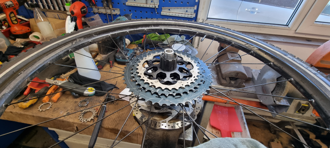

As long as I was riding my 38T chainring Vado in the mountains, I was using all the gears (including the 46T granny gear). After my return to the plains, I seem to be riding in high gears mostly. Guess what. After just 2000 km ridden since the cassette replacement, a brand new chain started skipping on the 11t cog! My brother did a precise measurement: the cog teeth got worn by 0.5 mm. If you do some math, it is the amount of wear equivalent to the necessity of replacing the chain.

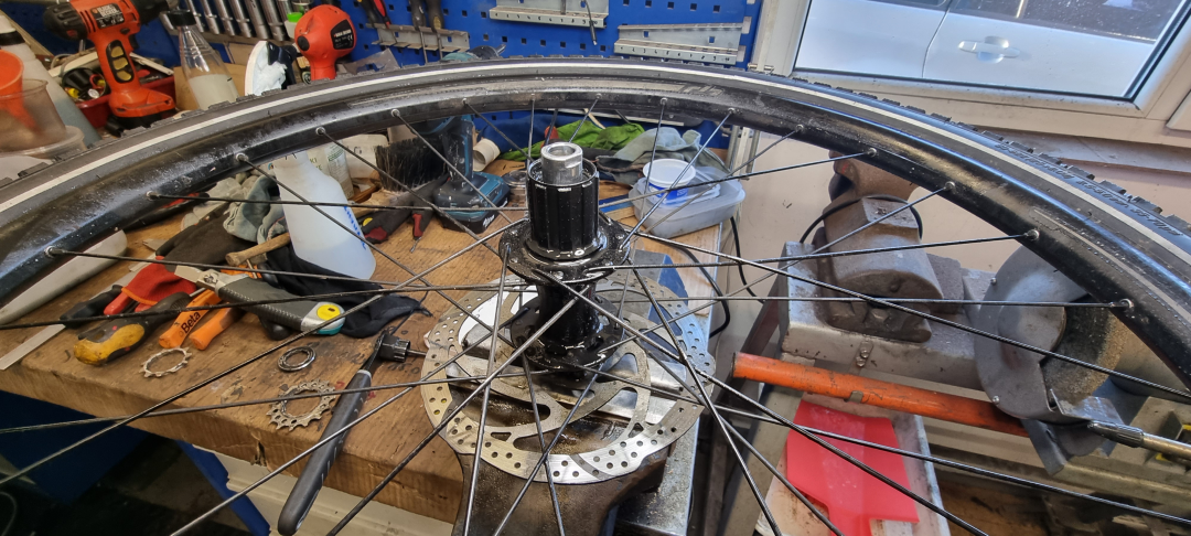

Assembled it step by step...
To finally giving me the Vado back with the new 11t cog and in perfect shape.

I also need to mention wearing the smallest cogs is a well-known phenomenon, especially with the mid-drive motor. Big stress acts on very few teeth (it is shared over more teeth on larger cogs), and the mid-motor adds its massive torque to the equation. That's why two smaller cogs are available separately: to replace them instead of the whole expensive cassette.
The problem is especially pertaining to 1x drivetrains as you would like to have a climber at one time and a speed machine at another. Going with a small chainring has its positive sides but wearing the small cogs is the fact.
