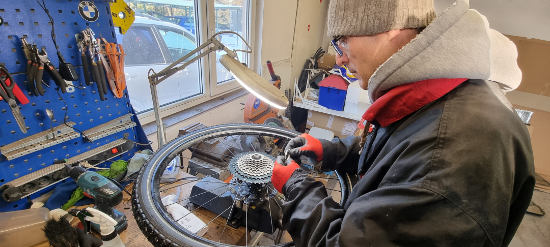

My brother had disassambled the cassette and gave it thorough cleaning...

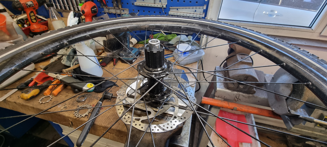

Assembled it step by step...

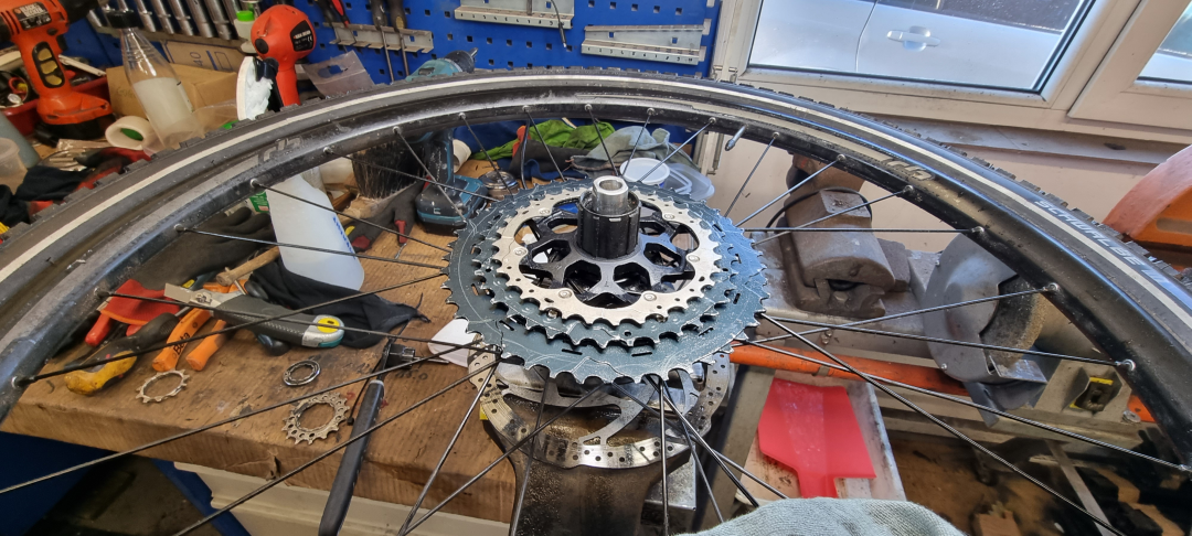

To finally giving me the Vado back with the new 11t cog and in perfect shape.

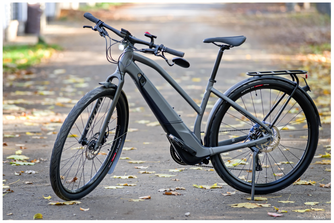

It is the status of my Vado now. Note the risen handlebars.

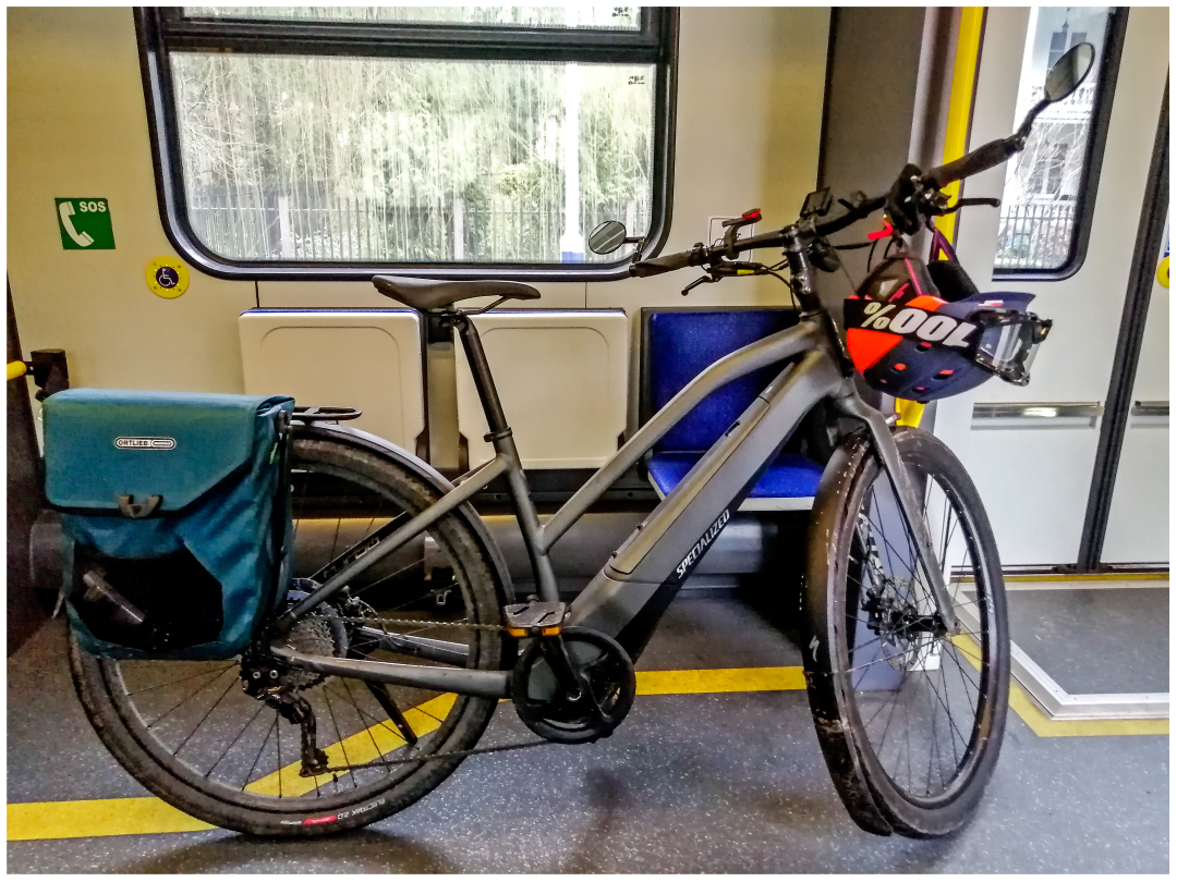

On a commuter train
