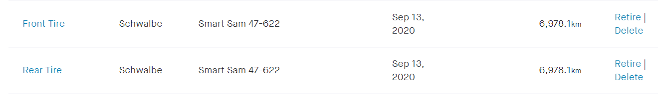

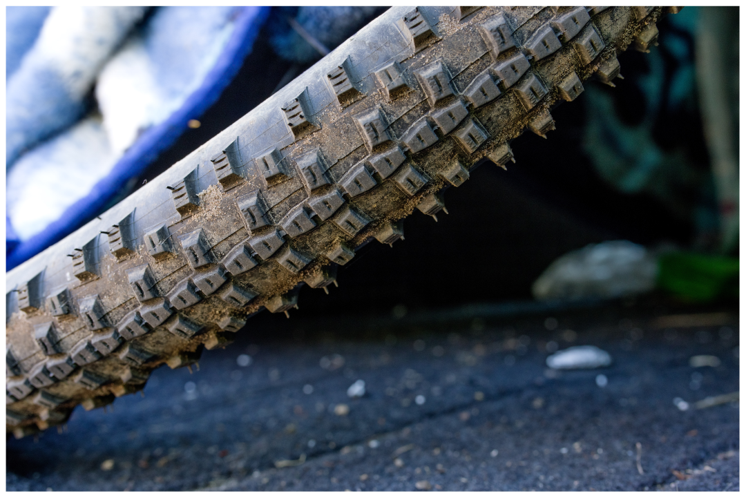

This is the front tyre of my Vado 5.0, a Schwalbe Smart Sam 47-622 that I installed on September 17th, 2020, and which accumulated at least 6,000 km since. Looking worn? (I don't think so).
No, if you keep riding it in the mud it should be good for at least a few more thousend km.
Perhaps that German product (albeit made in Indonesia) is simply very good? :)
I admit I could have ridden less than a thousand of the above on Schwalbe winter tyres.

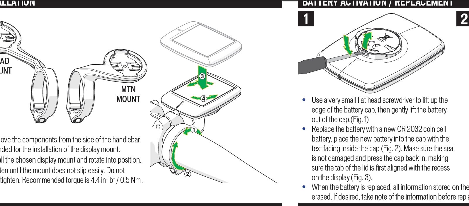

Just got the "LO BATT" message on my display so time to replace the battery. My bike is less than two years old -- how long do these typically last? I can buy a pack of 10 CR1220s from Amazon for $5 (free shipping), which is probably less than it would be to buy a pack of one or two at a local hardware store. Ridiculous as it's likely the only time I'll ever need this particular cell! CR2032s, on the other hand, I go through regularly since they're used in a lot of gadgets and accessories.
1.5-2 years. It makes little sense to buy 10 batteries.
Except that it costs almost the same to buy a pack of one. :rolleyes:
Is there any trick to removing the display to access the battery cover? I see in the manual that it twists onto the mount, but there's also an "anti-twist plate" that gets attached with a screw.
So, is there any trick to removing the TCD so I can replace the battery?
Maybe a clarification is necessary. I know there's the wired and wireless version of the TCD. I recently had to replace the battery in my wireLESS version.
Unless I'm confused (possible), I just twisted it a quarter turn and it disengaged from the handlebar mount. Then I do remember being careful to pop the battery cover. But I also thought mine (Creo) used what I'd call the standard coin cell.

Newer Vados come with "anti-theft plate" that makes the quarter-turn impossible. Rochrunner asks whether anyone has already released the plate and how.
