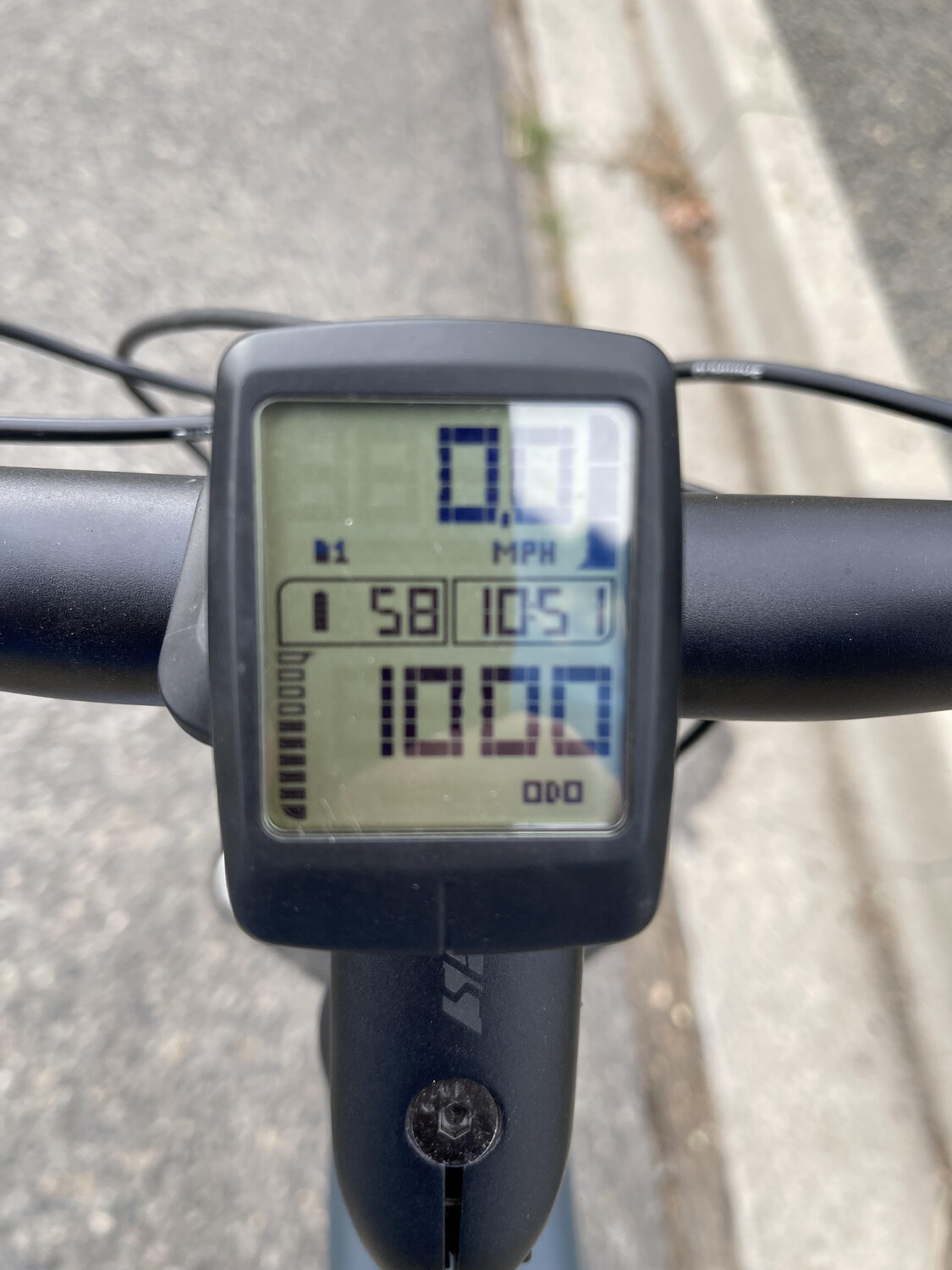

2 updates today. First, I cracked 1000 miles on my Vado 4.0. I've had it since April and couldn't be happier with it. Im on track for 2000 miles in its first year. 2nd is that I got my panniers that @Stefan Mikes recommended and.. WOW. The quality and attention to detail on them is phenomenal. Thank you again for the recommendation.

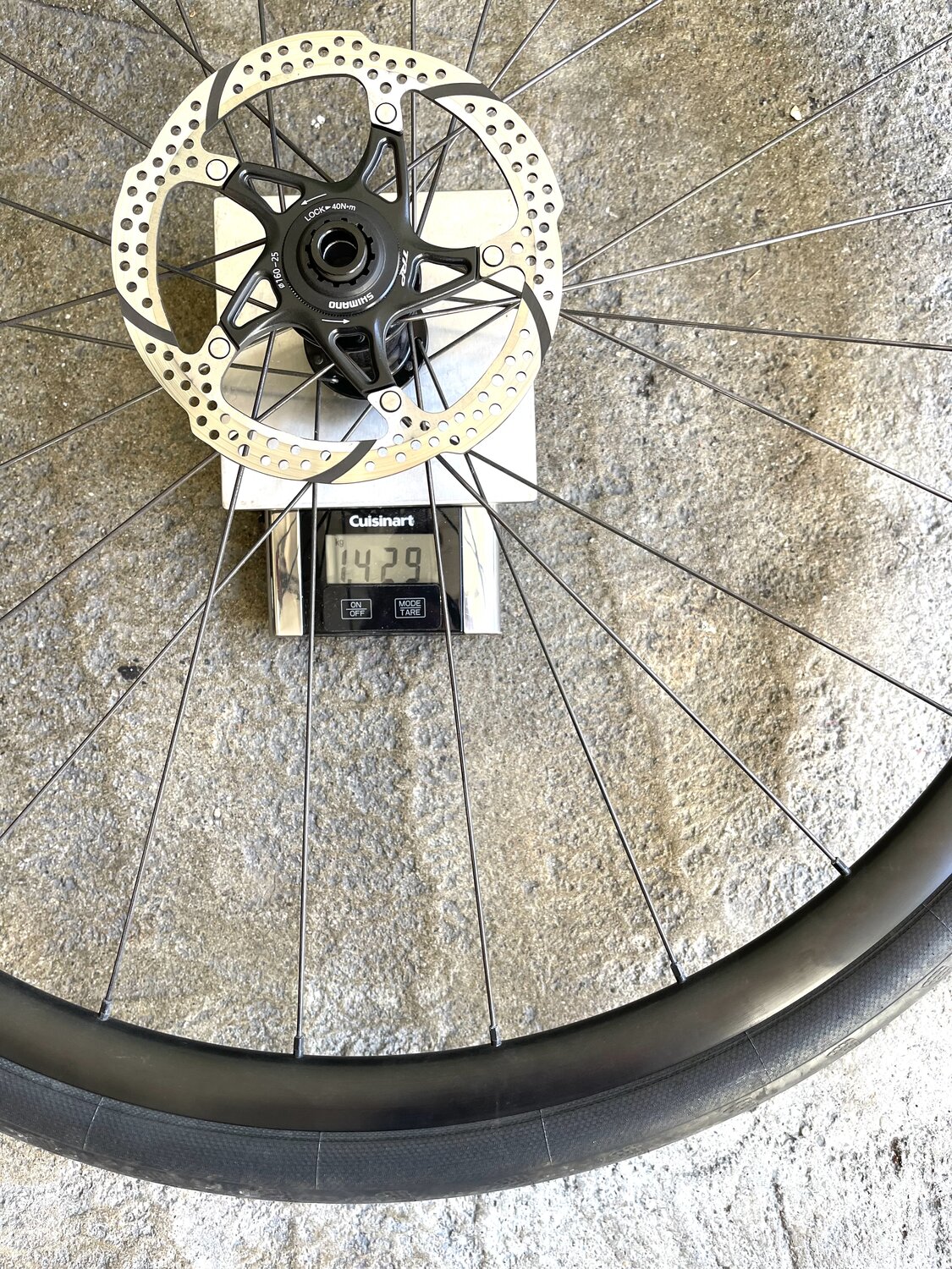

Practical Road Bike Mimimum: 1000g
Creo Comp Carbon (DT470 al rim) GatorHardShell: 1429
Vado SL Smart Sam: 1680
Vado Smart Sam: 2172
Vado ElectraK: 2268
I’m looking forward to a wheel and tire upgrade :)

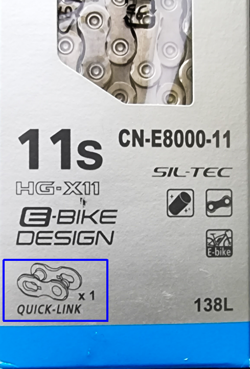

I ride my Vado 6.0 whenever I have time, so I have covered about 2,400 km since the beginning of the year. I have no problems except that the stop light at high heat> 32C was on as if braking, however with a drop in temp. everything works properly.
I replaced the chain and cassette at the beginning of the year, I think it’s time for a change. What do you say after these 2,400km?
Most or almost 100% of the time I ride 30% support on routes of 20-30km (flat terrain) where I develop an average speed of about 28km / h.

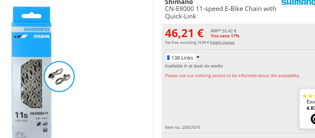

Maybe the bigger problem is to find a new chain with 138 links, so if anyone knows of any web shop in the EU to have in stock I would appreciate it.

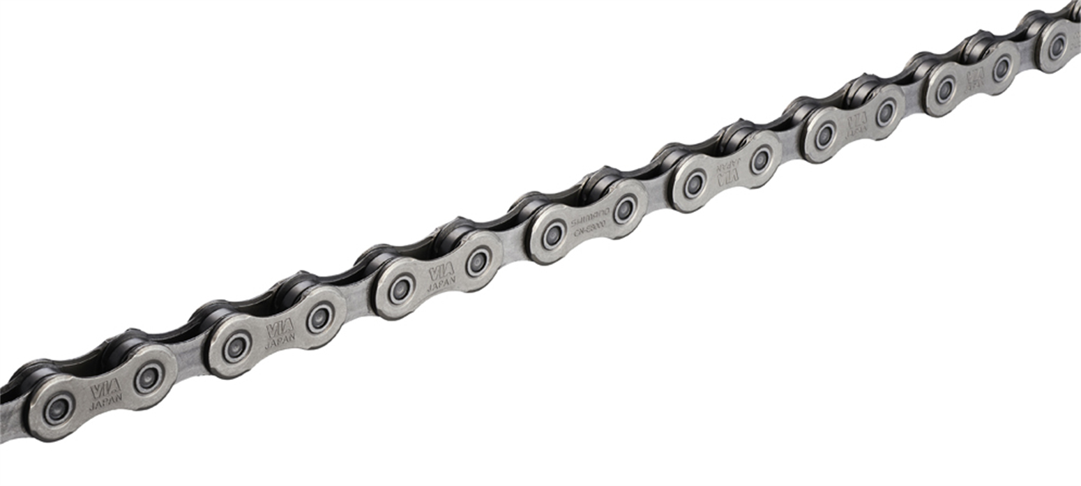

Igor, I'm on a ride now but will answer in the evening. Look for Shimano CN-E8000, 11 speed chain.

You should replace the chain when it becomes stretched, not because you rode this and that distance.
@TS25's rule: "Get a caliper (possibly a digital one), and measure the distance between centre pins of 10 consecutive chain links. 127 mm is for a brand new chain, 128 mm indicates the need of replacement, 129 mm means the stretched chain has probably already damaged some cassette cogs".
Chain:
Select the 138 link version.
Chain:
THX, but it is not available, and this is how it is on all websites with 138 links
Holy cow, @Igor M! Not sure how I could help you...
See how lucky I am in Poland:
There's one thing you could do: Buy two shorter 11-speed chains and join them with extra Quick Links bought separately...

and 12 speed comes in that size too, need it when you use 10-51 deore cassette
@vado4.0: The photo I have just posted is of my brand new Shimano CN-E8000-11 138 L that I keep as a spare. It is clear it uses a Quick-Link. Moreover, I own a batch of 11-speed Shimano Quick-Links. Please do not spread uninformed news :)
I agree the 12-speed chain comes with a pin. We are not talking on 12-speed here though.
