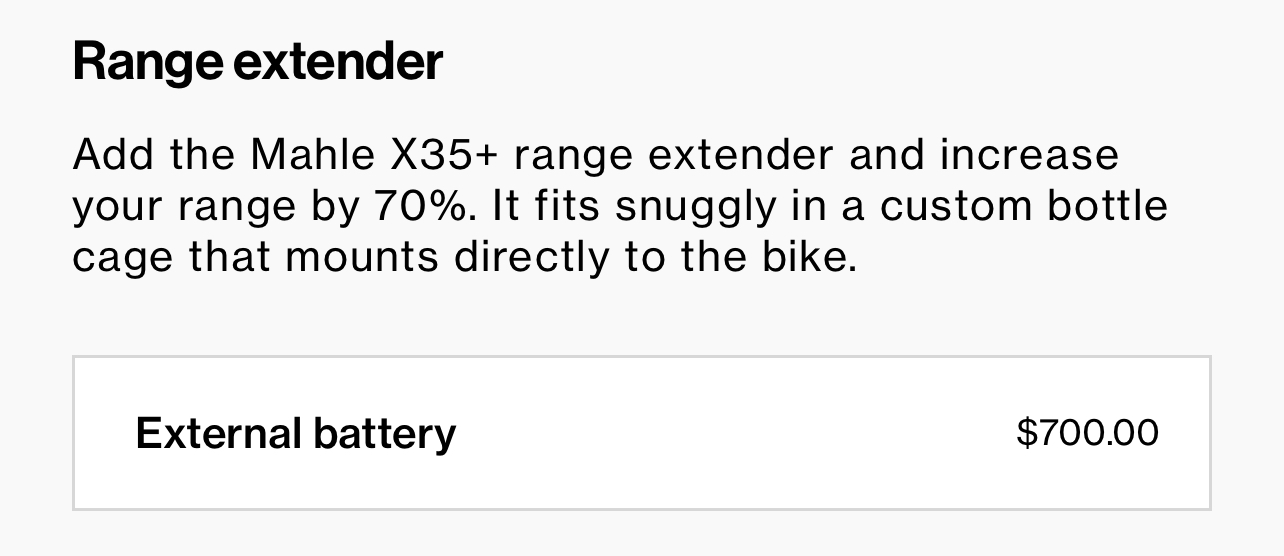

a minor point of accuracy, the mahle system does offer a range extender. said bikes can be/are very light.
About 170 Wh.
