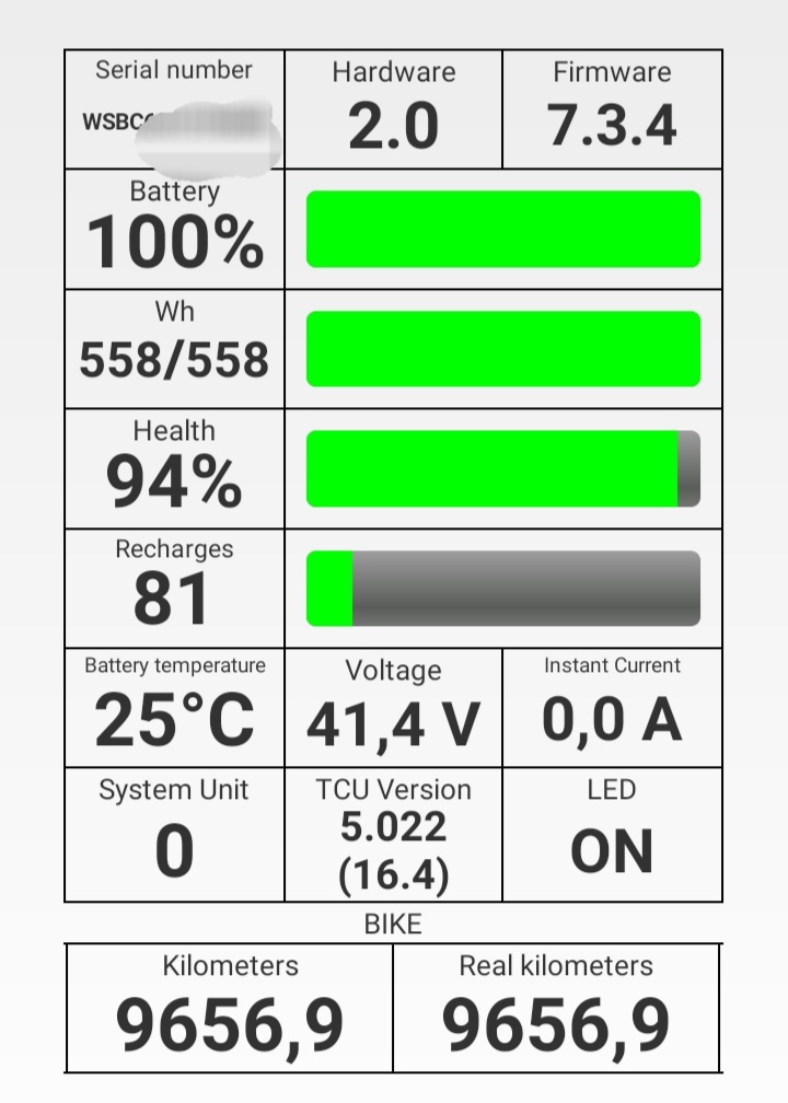

The status of my Vado battery #1 after 22 months of riding.
As I have been rotating both batteries to get them on the equal number of charges, it looks I need to start worrying only after next 4 years. If the motor will stand it! 🙂
I'm certainly glad your KM and READ KM match!!! :)
Is this a Blevo output?
Yes, that's from the Battery Monitor.
The kilometres have to match, as I have set the Specialized value for the wheel circumference, per Mission Control :D I normally record my rides in BLEvo but by using GPS data. That way, the wheel circumference doesn't really matter!
