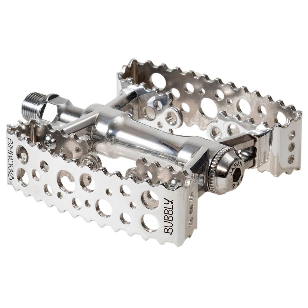

Unfortunately Bubbly Pedals are made out of unobtanium. They are always sold out, but they come back in stock in a few weeks. If you’re interested, get on the notification list. SimWorks will let you know 24 hours in advance.

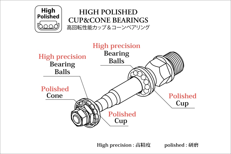

I‘ve never experienced a pedal that spins as freely as these. Just a flick of your finger and it spins and spins. I still can’t believe the watts I was throwing away with all of my previous pedals.
These are very nice. As you stated - made by MKS. It looks like they are based on MKS Sylvan. Handmade with double the bearings. Update: here’s the design:
You have a lot of tradition in those pedals - MKS makes a lot of competition components for Japanese Keirin racing. Keirin is a multibillion dollar parimutuel bicycle racing sport - huge in Japan. It used to be an exclusively men’s sport but it’s made a resurgence since introducing girl racing. If you can imagine beer drinking, gambling, and watching girls race single speed bikes - it’s the bomb man!

The Bubbly pedals are based on the New Sylvan Tour pedals. I ordered a pair when SimWorks ran out. They are nowhere near the same, other than the fluid spin. The Sylvans are beautiful but small with zero grip. My feet kept slipping off. They sit on a shelf now. I have the Bubbly pedals on four bikes.
