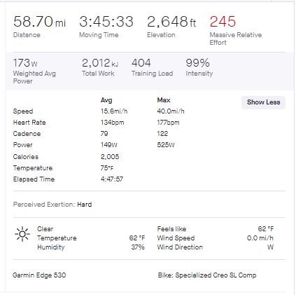

No battery extender. I'm about 155 lbs and main additional weight is just the water bottle. Longest ride stats: 58 miles with 2,648 ft elevation. Avg Speed was 15.6mi/h. Avg Power 149W.
I often do a different 56 mile route with less elevation and return home with about 10%-15% battery left.

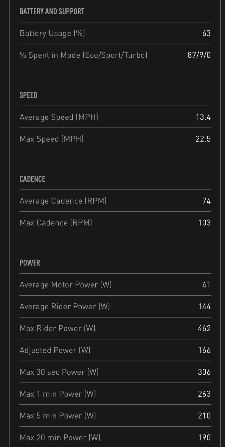

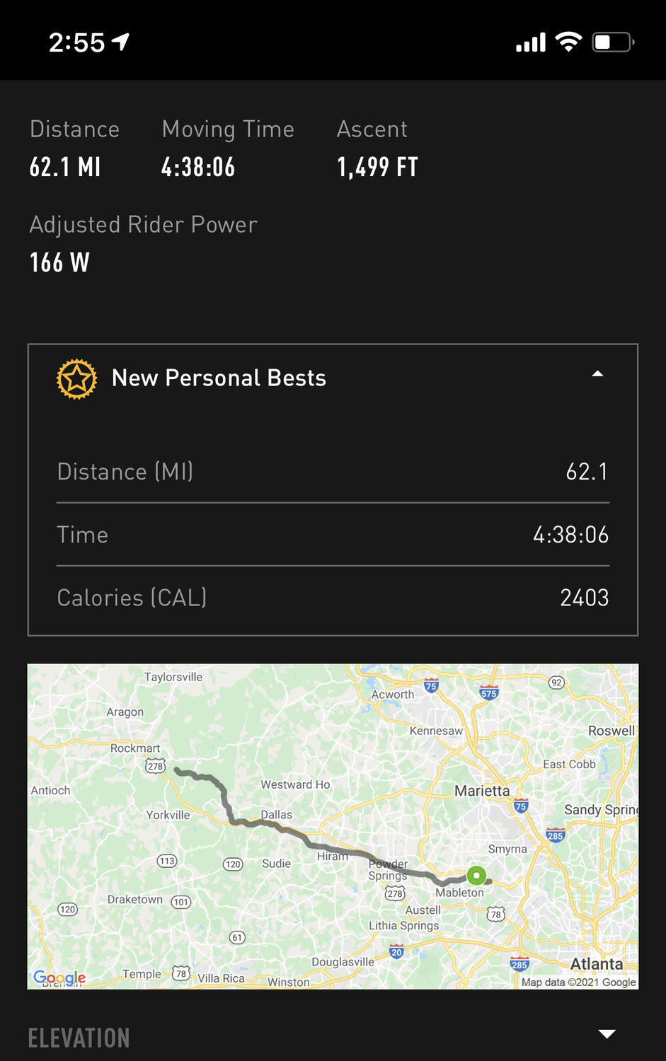

My longest is 62 miles on a paved trail , 1500 ft Climbing and 62% of battery consumed. I have gotten a bit stronger since this ride now averaging about 200 watts on my best days so I think I could do this with even less battery now. Vado SL 5.0. As you get a little stronger the range becomes a moot point. These are really fitness e-bikes.

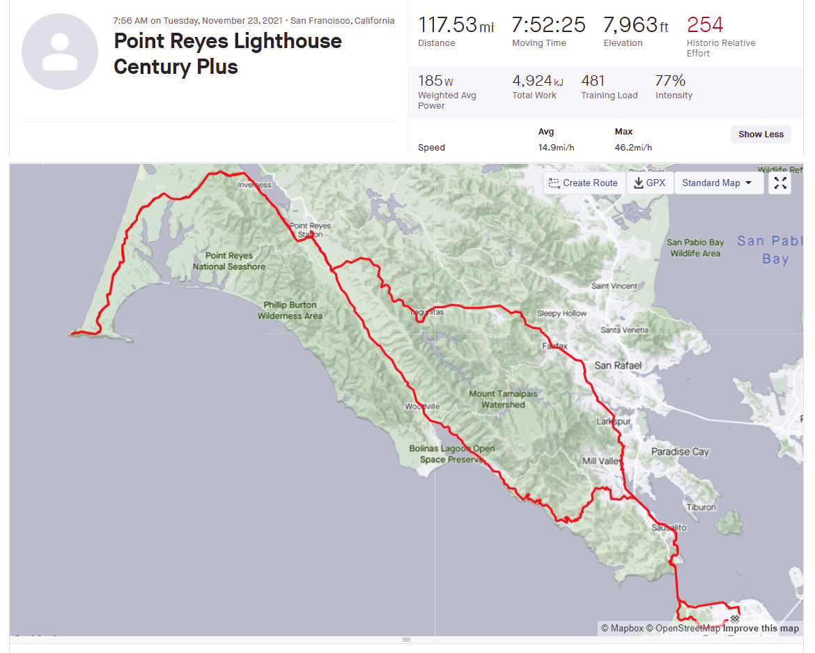

today i did 118 miles. other than a numb and aching left hand, feeling pretty ok.
i used 100wh on the dot, or just under a third of the battery. almost all at the climbs at the end, at which point i was lacking motivation to "do it myself."
i should add that although i didn't use too much of the battery, i could not have done the ride without it.
I think I could do 118mi with 8000ft, but all my batteries (internal one of the Creo and my "internal" one) would be very empty for quite a while...
I couldn't do it with only 100Wh in one day.
