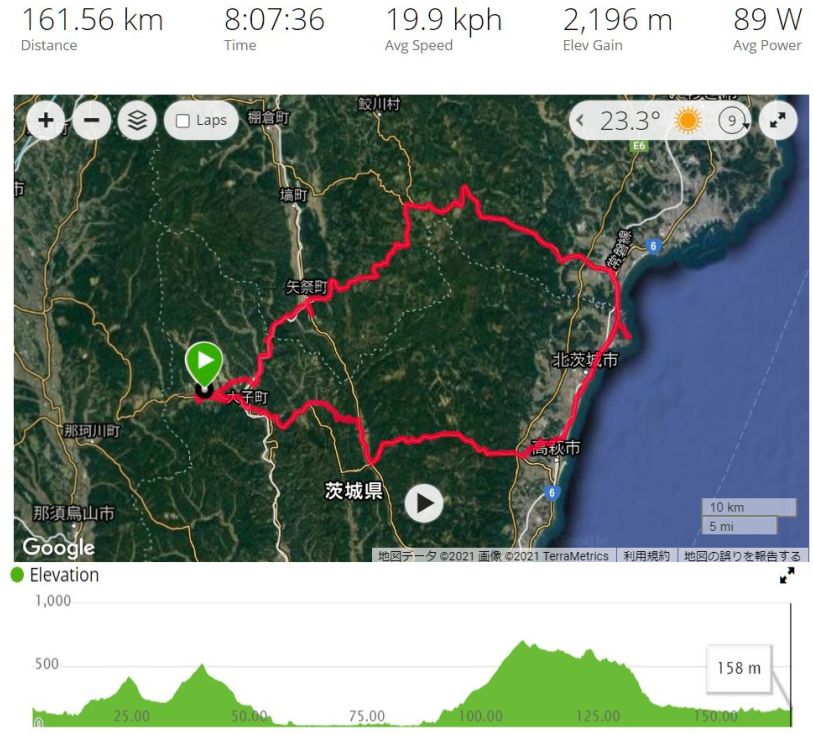

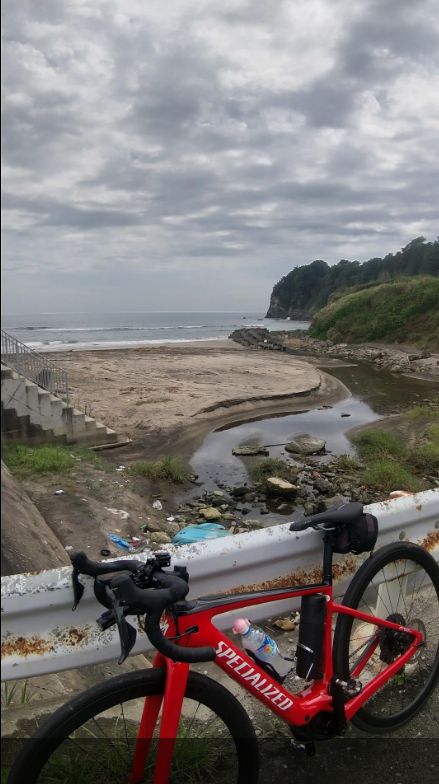

this last weekend i took my longest creo ride yet; flatter than my usual rides of this distance so i managed to use only 57 watt hours! 18% of the battery.
of course, had i kept going too much further, my consumption would likely have increased. 😅
Did you first use the Range Extender and then switch to the Main Battery? That's still quite impressive - 100 miles and 7,000 feet of gain with 30% left. I guess I will have to lose weight if I want better distance or use a second Range Extender.

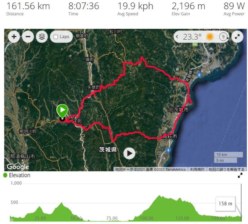

Thank you. I don't have a Range Extender. I generally switch on the motor assist above 5% climb. Enjoyed a rice bowl topped with sashimi at a famous sea food restaurant. https://goo.gl/maps/5iYMD2A3db2dsjiZA

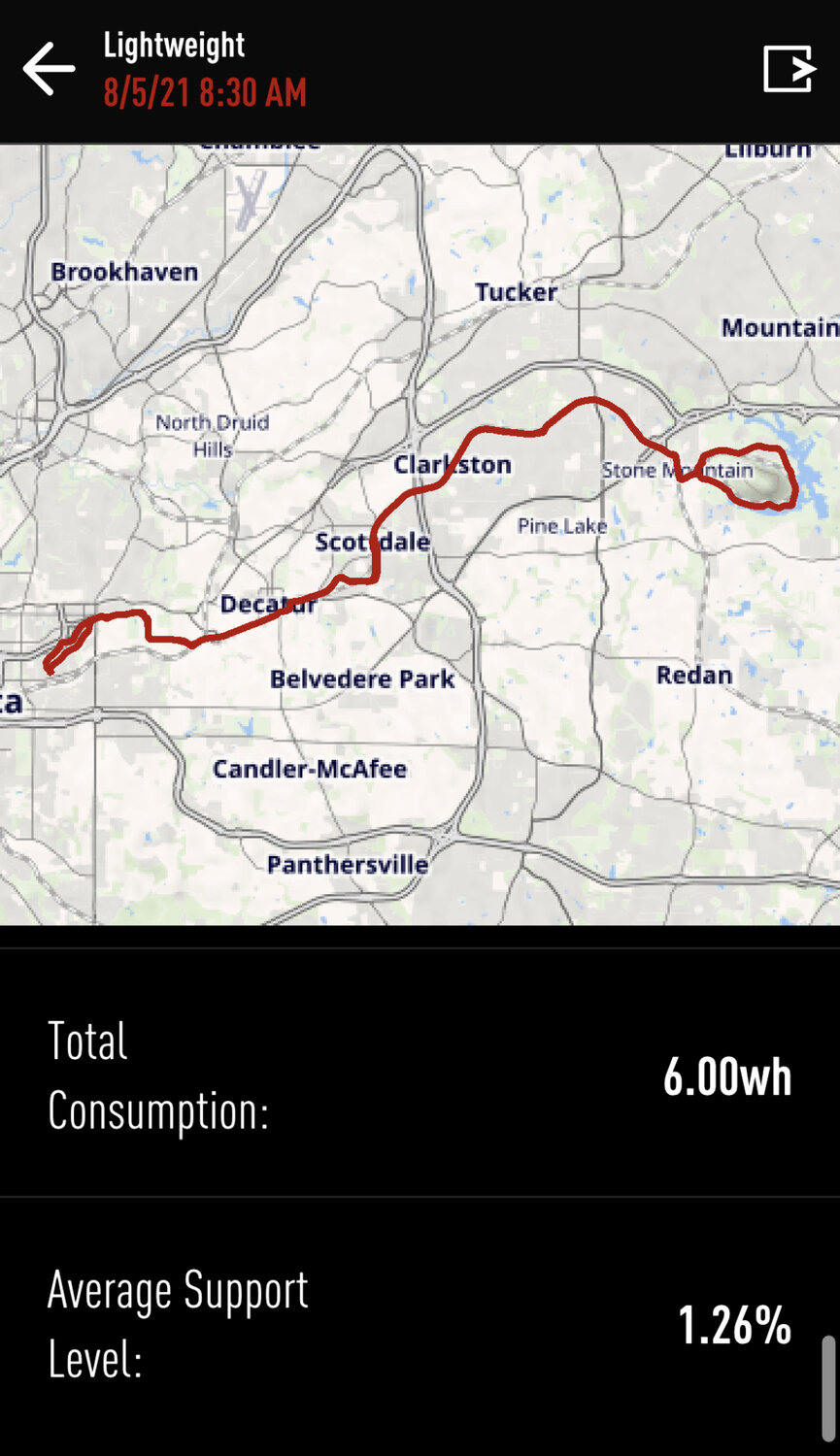

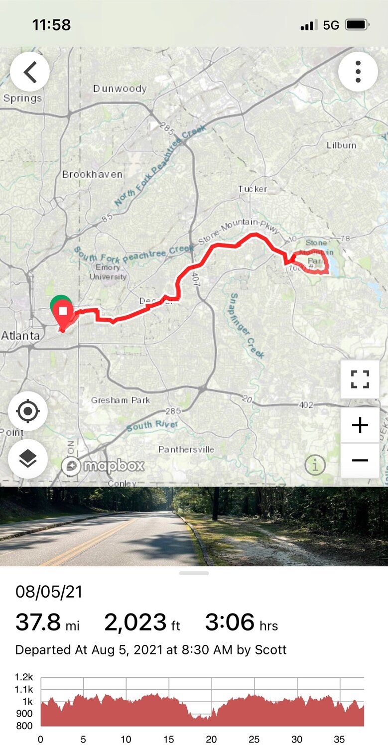

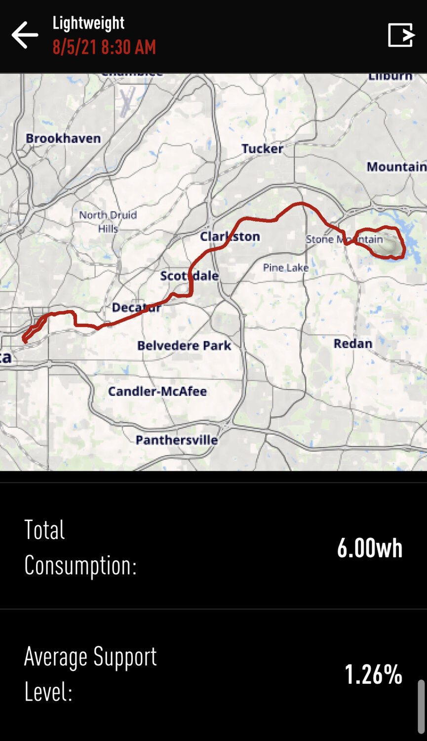

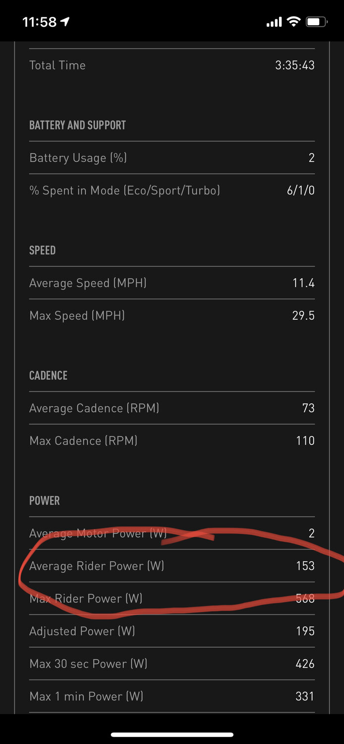

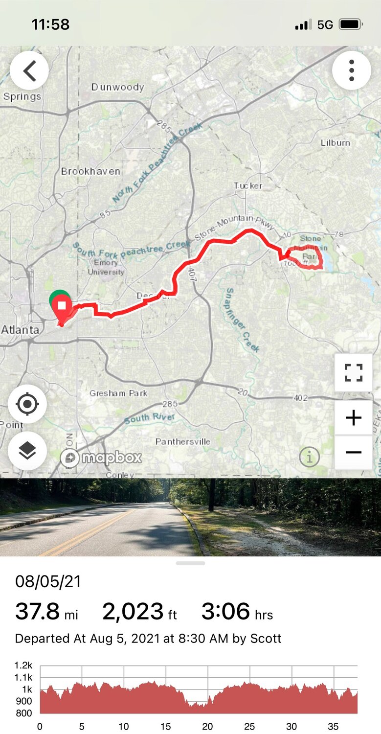

Not a CREO but a Vado 5.0 SL. 38 miles, 2% battery consumption, 2000 ft of climbing, slow 12.1 mph average, sore leges. Mostly flat but a couple of good climbs around Stone Mountain. I am trying to use my legs more and the battery less and with this bike its possible. I have de-tuned the motor using the Mission Control app. I have done a metric century on the bike at about 14 mph with 35% of battery remaining. I about 165 lbs, 70 years old, US spec class 3 bike and don't carry anything but a few tools, tube and water.
View attachment 98462View attachment 98463View attachment 98464
That clinches it - I need to lose weight and five years! ;)
