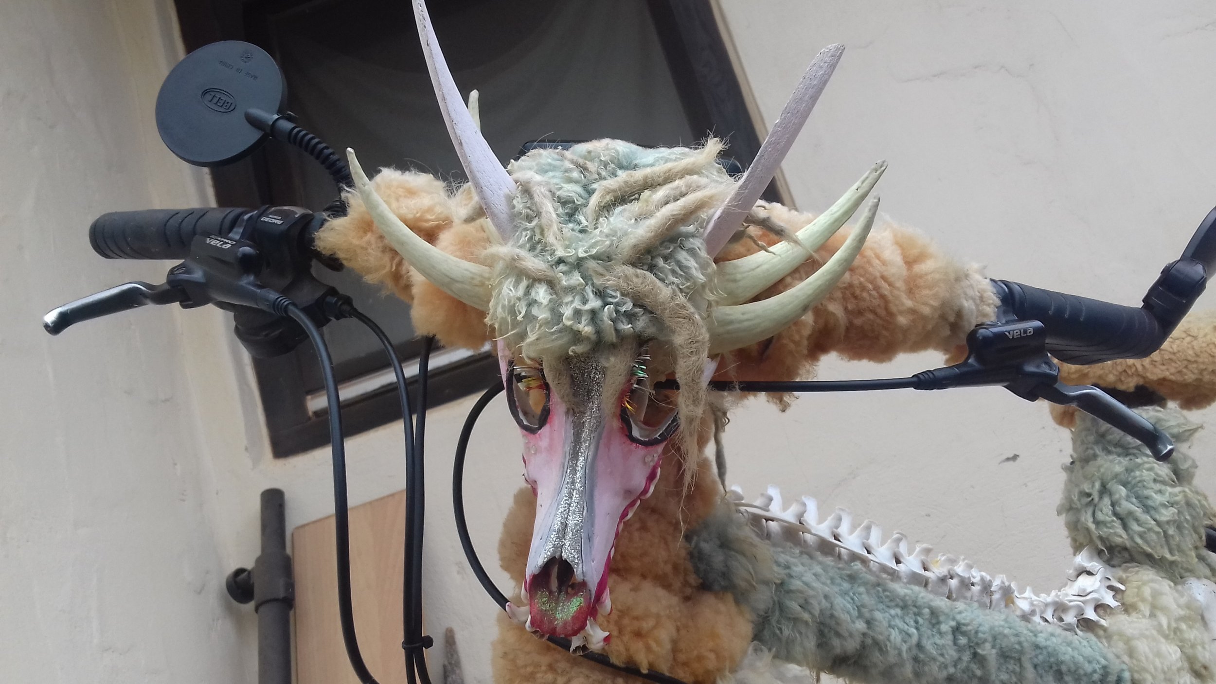

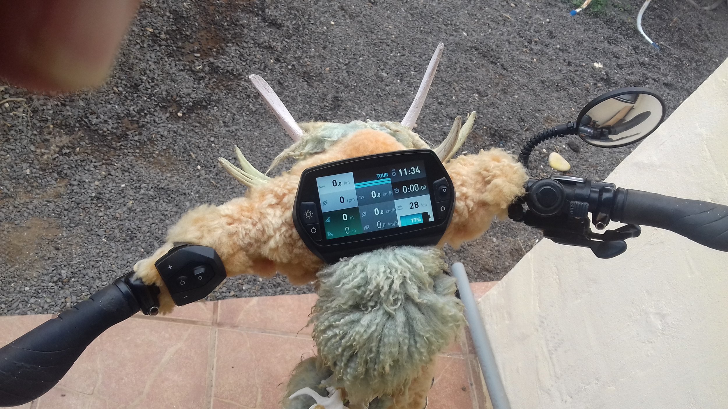

Here's our Corratec hybrid wrapped in sheepskin and some bones we found. Not much room for anything else after the Nyon though. Still trying to figure how to get a forward pointing 1000lumen light onto dutch bars and use an old smartphone for video.
View attachment 44373View attachment 44374
YIKES. love the look, but the the first thing I thought of was..."That's gonna leave a mark if you go OTB!"
The headlight looks serious here.
